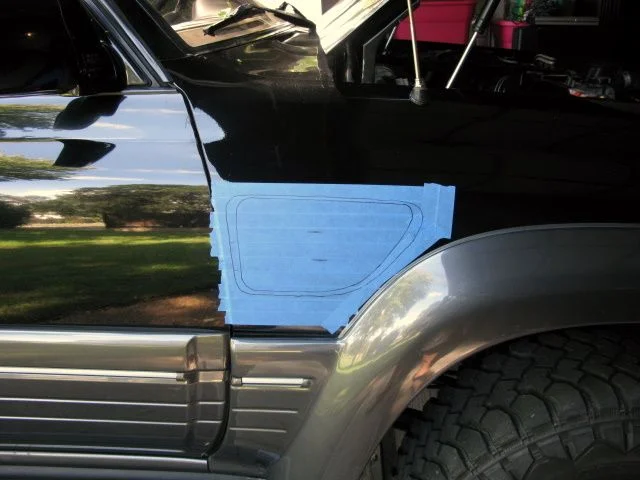

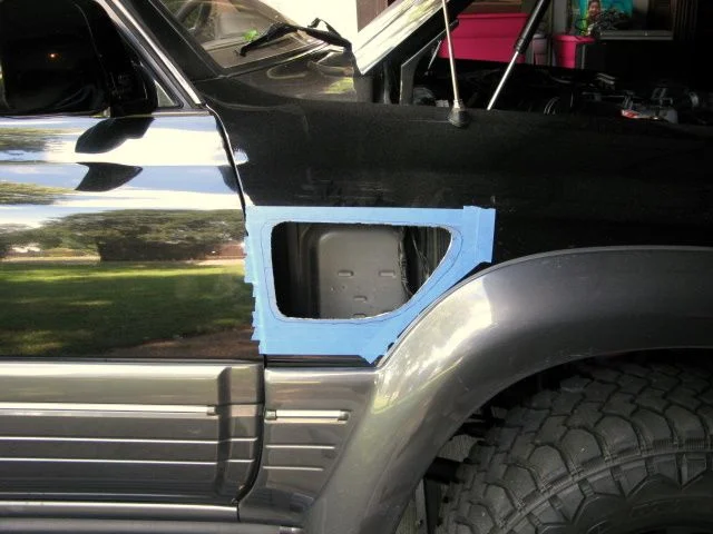

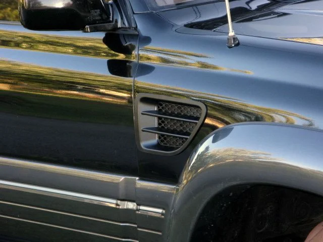

Was trying to find something unique I could do to my 97 LX and thought of installing some fender vents. I first thought of just some faux non-functional stick on vents that looked real. Then that idea lasted for about 1 second, (dont want to be a poser). I searched through 100's of styles of aftermarket vents, and then came across some Land Rover Sport vents that looked like they would fit nicely on the 80 fenders. I got them on Ebay for $25 shipped. These vents are about 3 inches deep, so there is no getting around cutting a big hold in the side of your fender. I started by making a paper template on the back side of the vents, and just kept trimming the paper until it fit around the back side of the vent, then transferred that cut out onto another piece of paper, and used the inside cut for the template. Then I put masking tape on the fenders. I positioned the cut out on the passenger side fender first to see where it would look best yet still be able to eventually mount a snorkel, then took measurements and did the same on the other side, drawing an outline. Then I started cutting away with the cut-off wheel air tool. Once you start cutting there is no turning back. I then sanded the edges to smoothe them out, and painted the cut metal. The back of the vents have hooks on the top and clips that snap into place on the bottom, so you push in, then slide up, then push the bottom into place and they snap in. Pretty simple, you just have to make sure you get your cut right on. Remember, you can always cut more, cut too much and they won't be able to snap into place. I sprayed them with Satin Black to offset against the gloss black. Here are some pictures.

I know when the fan is on you really feel the heat coming out of them, so I can only imagine how much heat they extract while driving.

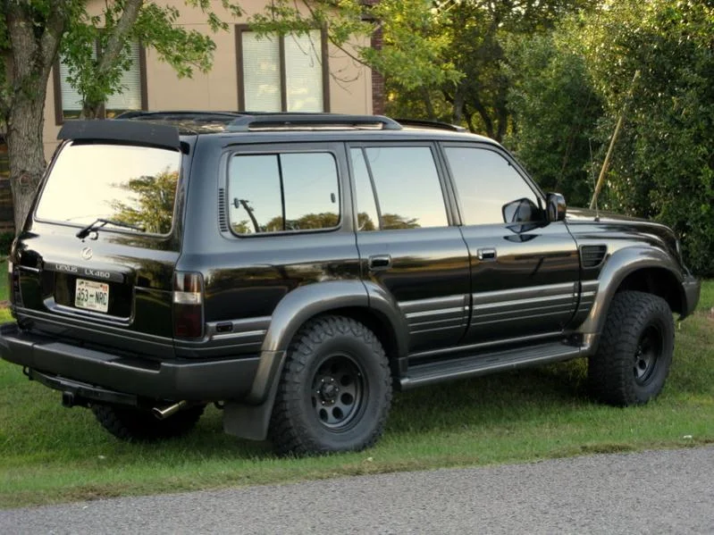

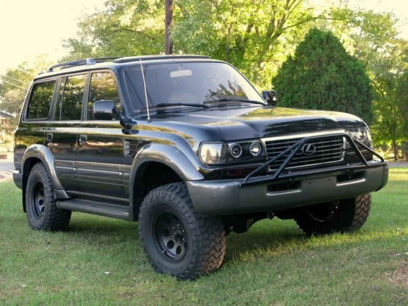

As requested, some full pics of the LX with the vents.

There are large openings in the inner fender at the rear of the engine bay in our trucks. The one on the passenger's side is the opening through which you can access the power antenna assembly, and the one on the driver's side is where the fuel pump relay and rear wiper diverter hang out. I think these vents would allow a lot of hot air out of the rear of the engine compartment. The style of these vents lines up nicely with the cladding on the LX. Nicely done!

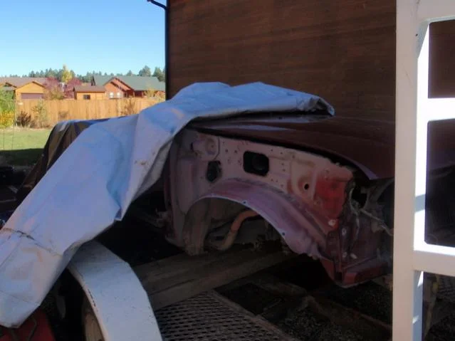

Here's a picture I just found in the for sale section. The big rectangular shaped hole is where the intake comes through the fender so not much airflow there. The funny shaped hole at the rear is the antenna access hole. It's about the same size as the LR vents, so I see no reason why the positive air pressure from the engine fan or highway driving wouldn't exhaust hot air through the vents.

I'd be curious how it works as well. At highway speeds, I would think the low pressure would suck out the air from the fender. It would draw out the hot air from the engine bay, but it might also result in lower pressure in the fender making it more difficult for the engine to suck in air (potentially). Or is there somewhere behind the headlight that draws in outside air? Otherwise, it seems our "cold air intakes" are just sucking in hot engine compartment air from the antenna access hole. Obviously the front isn't airtight, but hopefully there is enough flow from the front to compensate.
