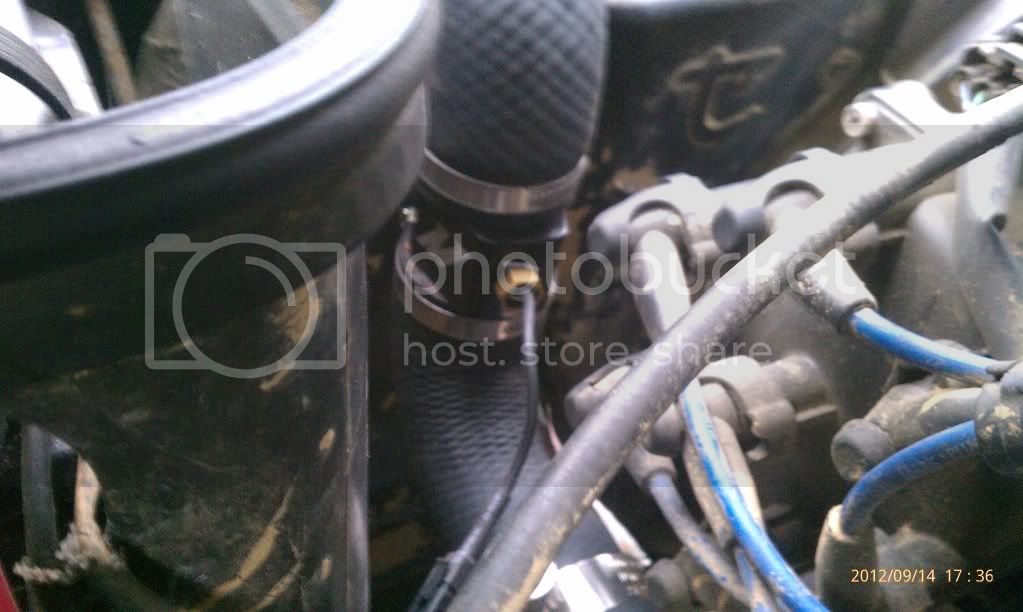

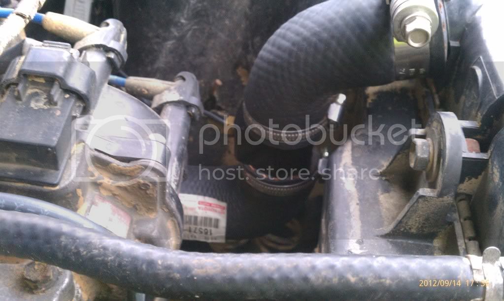

Does anybody have some clear shots of where you installed the water sender attachment? The pic a few pages back isn't too clear. Does it matter where on the upper hose this is installed? I can't imagine the temps varying all that much with just a few inches of space difference.
Mounting the adaptor in the upper hose. While I don't have pics, I can say that if you take the hose off completely you will see that there is only a certain amount of the hose that has no curvature. I just put my adaptor against the hose where it was straight and marked the hose with a pen, cut and installed.
I didn't even go that far, took the top off, quick markings, cut and reinstalled. I did slide the clamp down, tightened a bit and used for a "straight cut/edge".
I walked outside and took a couple of pics.
