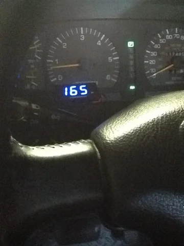

Koso slim water temp gauge install

Just put my Koso in with glow shift adapter...
Forgot teflon tape on sensor bung so had to drain coolant again.. All seems well now

The koso website says that it will flash when temps rise above 120. Since these are designed for motorcycles my question is does the gauge flash constantly since our temps are always above 120 when warmed up?
Never mind. Sent the op a pm. I looked right over the F gauge and was looking at the C gauge...d'oh. Just excited that I see a end of constantly watching the oem gauge.
