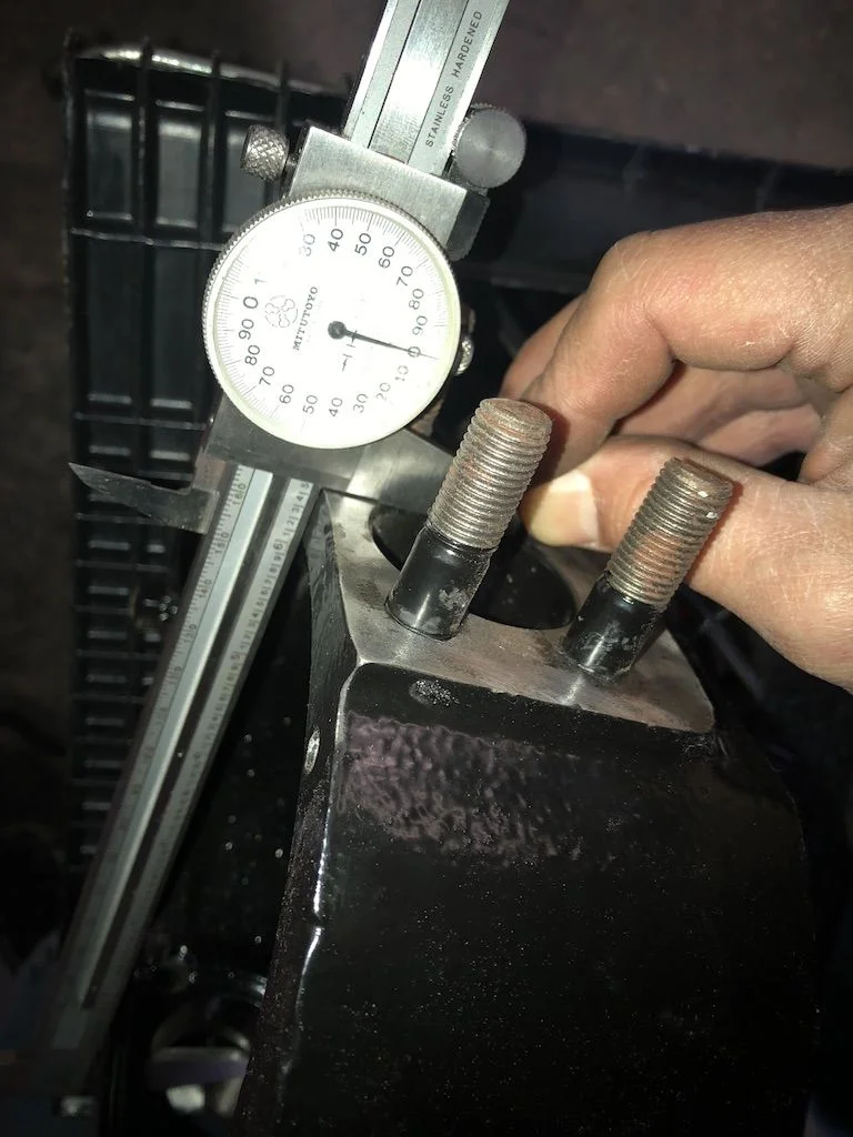

I just rebuilt my axle last week only 3000 miles after doing it the first time. I didn't use the axle centering tool correctly and was leaking gear oil from the diff in to the knuckle. Hard lesson the learn but I think I got right with @OTRAMM 's video.

Some videos I've watched say nothing about using an axle centering tool. What's that all about? Are they just putting shims back in and calling it good? As I indicated in earlier post this will be my first rebuild. Is the majority advice use the centering tool?
Just reread some previous posts about shims and centering tool. Looks like if I keep track of shims I should be okay.?
It all depends on if a previous owner rebuilt and messed with the shims and didn't do it correctly. Our local club owns the centering tool and an electronic caliper so taking the additional 45 minutes to check was a no brainer.

Been a while since I've been on forum but did complete the knuckle rebuild. It all went pretty well. Couple times I wasn't sure about how something went back together but figured it out and it's all back together. I've included a couple pictures. One of the complete strip down of the knuckle and the other just a picture of the fj. I'm ready to move on to the next part of my education which will be a install of 4 speed transmission under my brother-in-laws direction. I'll start a different thread for that.
