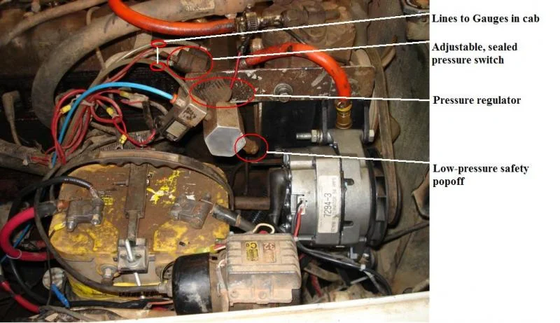

You can see the guts of my setup in the picture below. The mounting on my F will not apply to your 350 (that is a GM Alt-"12si"). Excuse the wiring nastiness, picture was taken before everything was back in order after installing the alternator.
Note I have my system split into two "zones," high and low pressure. High is controlled by pressure switch and low is regulated by the "mini" pressure regulator. Both sides have a safety popoff and gauge in the cab. I did this so I could fit more air in a tank of a given size without damaging the ARB. I didn't know at the time that ARB's can handle much more pressure reliably than the manual states.
I made the manifold out of hexagonal stock, and the York intake was originally plumbed to the smog pump connection on my stock F air intake.
Let me know if you have any questions.
