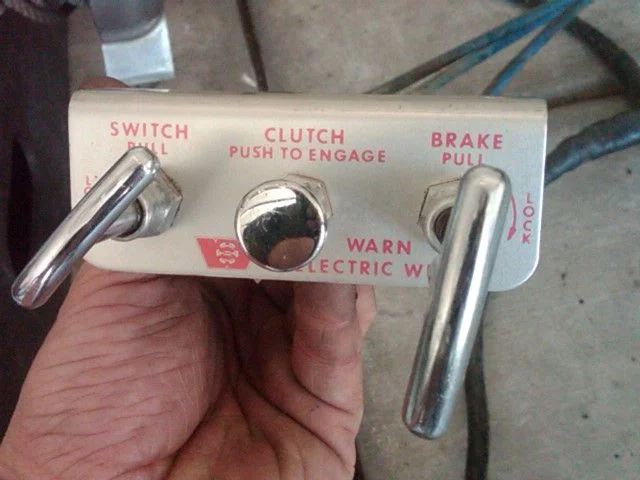

what are the two switches by the driver door for :confused:
No idea on the switches inside the door. I didn't even notice them until I was looking through my pictures that I took. I believe it has to do with the winch. Anyone have any thoughts on if this winch was stock or an added option on the 40's?
yes thats the warn winch in cab controls...looks like this:
