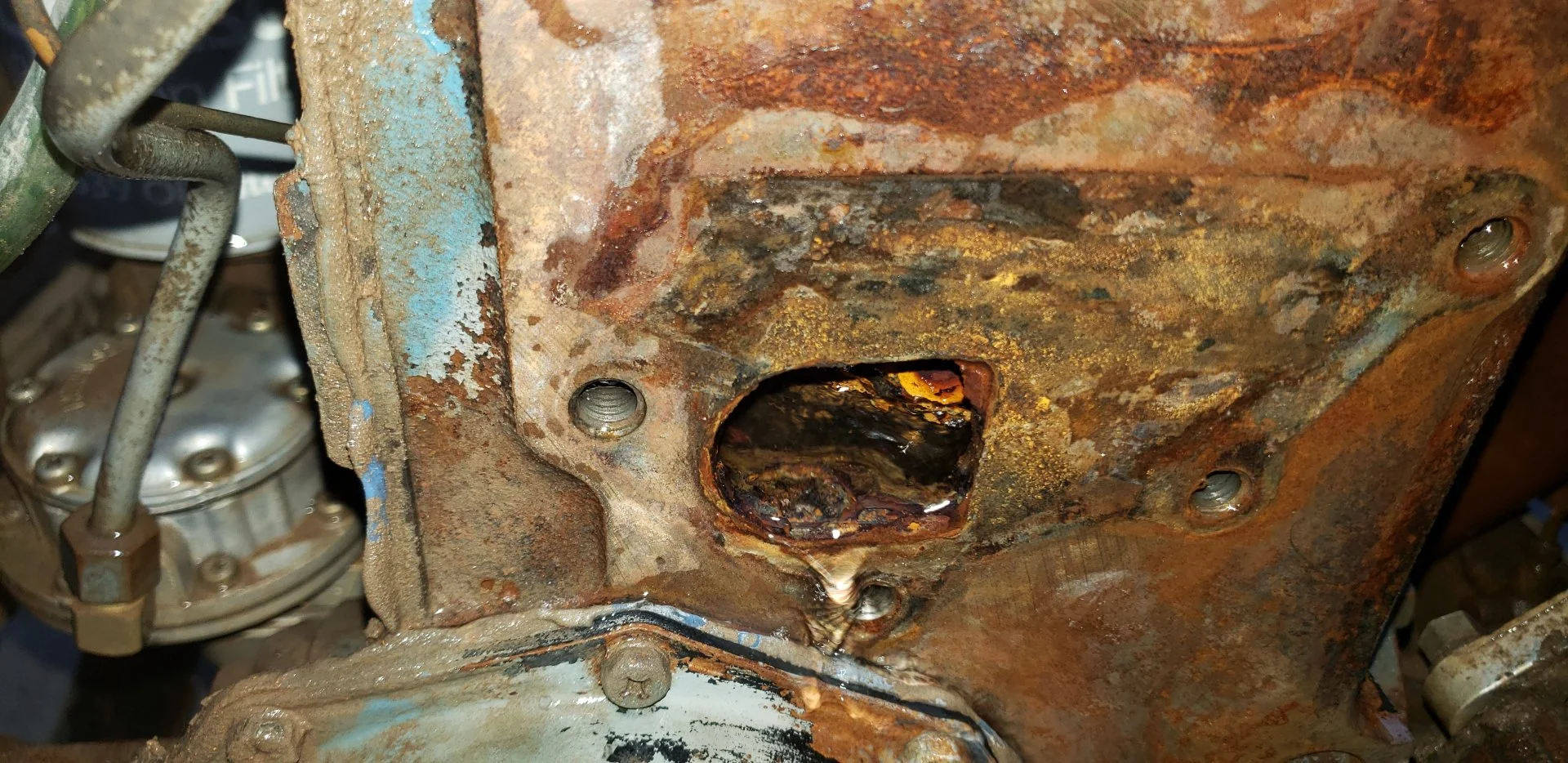

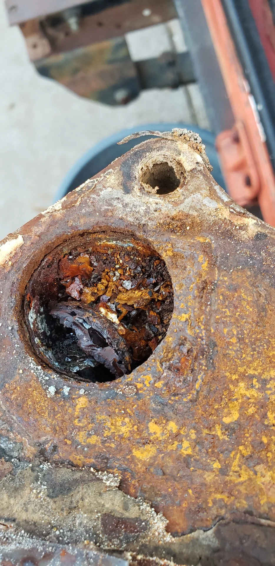

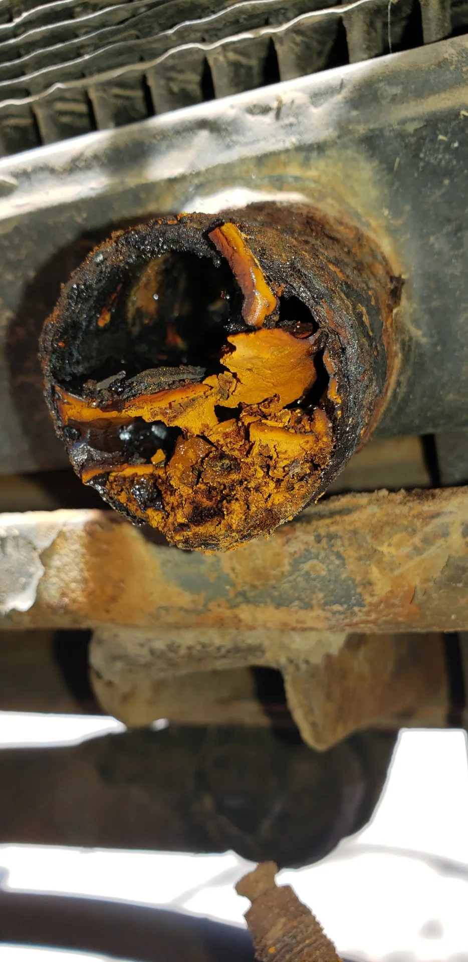

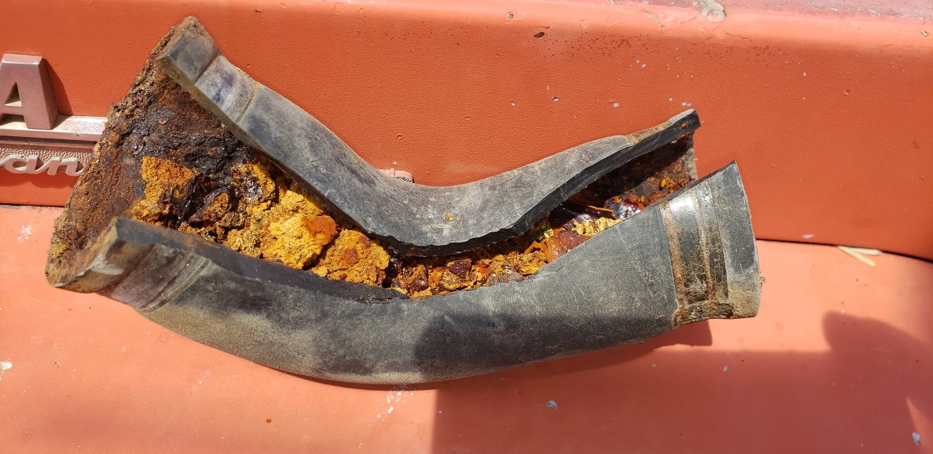

67 FJ40 with possibly stock engine. It hasn't run for 22 years. I want to revive it hopefully. The engine does turn from the crank bolt. But.... I could tell the thermostat housing was cracked. So I started taking the old hoses and belt off. Found all this...

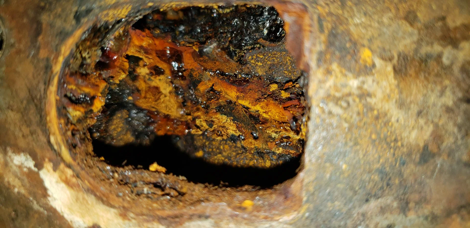

I flushed water from the water pump inlet and water did eventually pour out of the front water passage, it was rusty and dirty. Eventually ran clear. But there's still visible rust inside. I haven't tried flushing water from the rear water hose connection at the top of the head yet.
Is my engine likely terminal? Thoughts?

Do you have better picture of the over all thermostat housing? How about the valve cover and manifolds? As I remember the F135 that ran thru the 67 model has a long outlet neck on the top. Do not remember a thread fitting. If your trying to save the engine because it original would be sure that what you have.
You’ll need to pull the block drain and hopefully eventually get clear flow out that port.
Make a cover for that lower hose outlet that you can seal, then pour as much evaporust in from the thermostat hole till it’s full and let it do the work.
I’ve never seen a thermostat housing crack like that. The only plausible explanation I can think of is running straight water (which is consistent with the corrosion) and a freezing cycle that expanded the water in the housing until it split open.
I would be very leary of what a freeze cycle like that might have done to things that can’t be seen.☹️
Lower radiator outlet

I already pulled the water pump and radiator. The water pump is a goner. Radiator might be saved.
