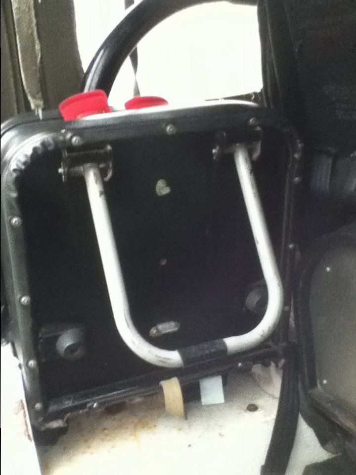

Stock 82 jump seats
From what I've seen, the later years rear seat fold down bracket is narrower and folds down from the seat differently. You can see the difference from the pictures above.

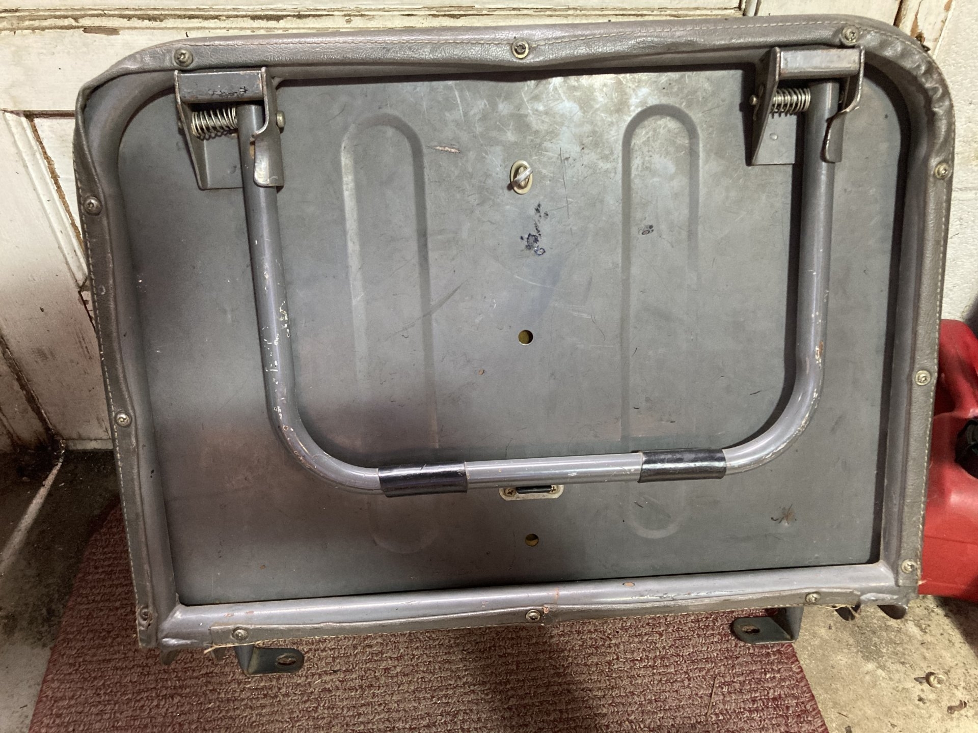

So based on the pictures of mine they are a 79 and up. I bought them a few years ago from someone on Mud for a 1970 FJ40 I had at the time. Now I’m replacing the ones that were in a 74 with the fold down legs.
And no I don’t have the original ones out of my 74. I sold them about 4 years ago.
