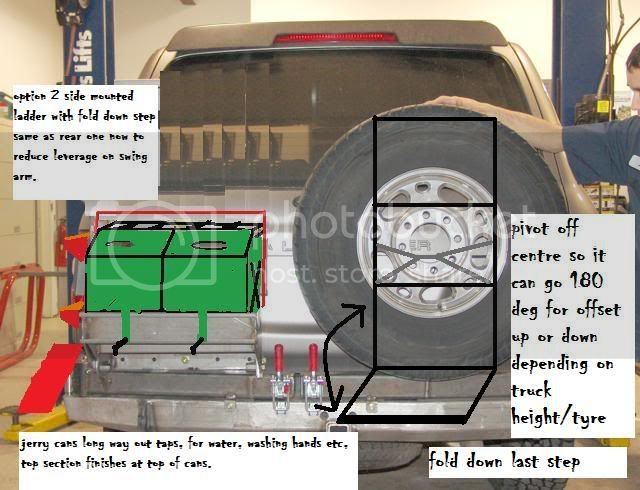

It's true! I captured pictures of the whole thing! :eek:
This design holds 2 jerries, and has a ladder on spare, which can also fold down to become rubbish bag holder, or dirty recovery bag holder, or option 2 having the ladder section similar to the current design but down the side of the carrier to limit leverage on the carrier arm.
The best part of the 2 can lower design is that it doesnt limit vision out the rear either.

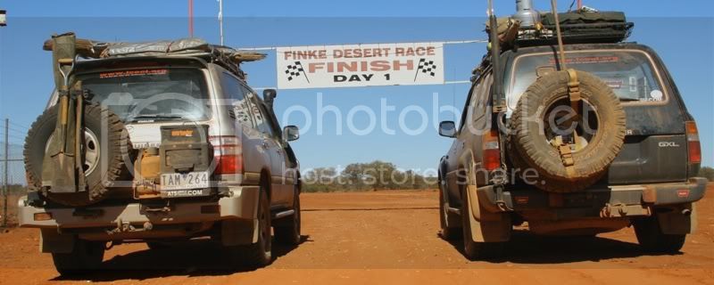

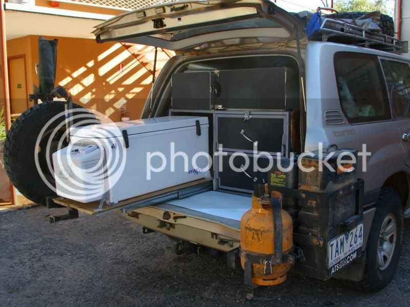

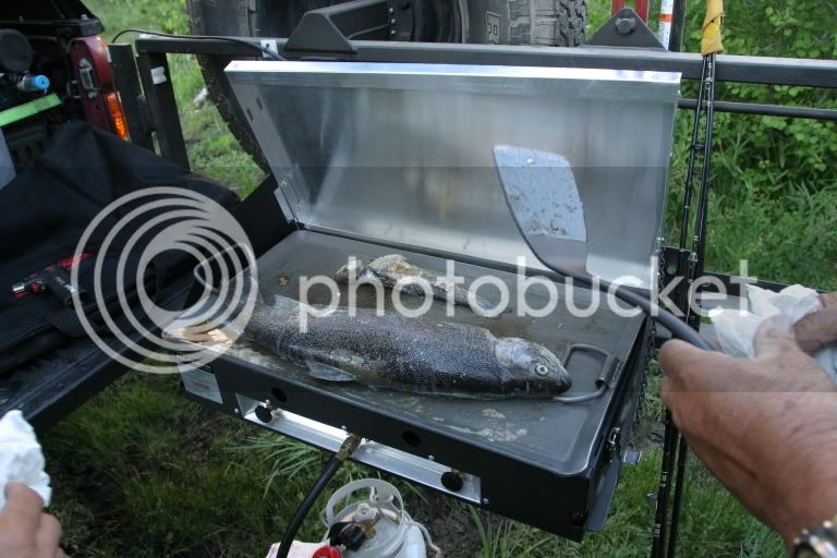

Here is a pic of some of what people do with kaymars here, inc with lpg bottle, having a folding tray section the cooker can sit on at ther back of the car, so set up to boil the billy for lunch/smoko is easy while on the road.

Personally, I like the 2-can minimum, with the LPG tank attachment. As for aesthetics (had to look up that spelling :p ), I agree that it is very industrial looking, but so are the other pics of similar items. Once power coated and painted, it may down-play this (less of a naturalistic welded look). As for functionality, the one thing that keeps coming to mind is if you could make the mount in such a manner as to be able to rotate 180 deg. the same part allowing it to mount on either side of the bumper. The associated thought with that is if you could do the same with the tire mount, allowing the end user to pick which side actually holds either the spare or the cans. The idea around this would be allowing the customers to start with the basic bumper, and then adding either the spare swing out or the can / ladder swing out, at a later, more cash-friendly time frame. From a manufacturing point of view, the more that you mirror the entire bumper from side to side, the easier it will be to create. (This is not to say that this has not crossed your mind. Overall, I am looking forward to being able to purchase your bumper, with both swing outs. We have 4 kids that we take, so keeping the interior for personal space is a premium priority, over all-out storage.) The other, I know it was mentioned earlier, is weight. I would be interested in how much to total package ends up weighing. These are my thoughts. I hope it helps. :)
