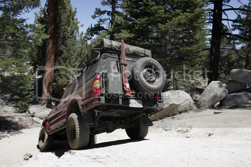

i know i've posted some "questionable" posts on here, but i've asked Mark "Cheezy" Cheeseman about doing a LC100 rear bar...and i assume ATS knows of his work, but of course you can't assume anything!
Cheezy can't fabricate the rear bar for me yet....he's too busy doing the Rock Crawling stuff and has moved into a new shop (factory) but said it would be similar to the GU Patrols rear bars here.
Please note that no i have no affiliation with Mr Cheeseman..but yes Cheezy did my side steps/sliders which have plates welded to my chassis and the side steps bolt directly to the chassis...
if i want the rear bar like on the GU Patrol (which i do) we're talking a few months away if i can get the cash and get the booking then i'll happilly post the pics.
The rear can be a combo of what you want, same as Mr Slee so you need to think about weight. That's the bottom line really and fuel economy and distance is why you want the jerry cans. Yes i have the 4.7L V8, so ignore any Aussie diesel comments on here!! Make sure you check out all of the pics posted above. It's here in case you missed it.
