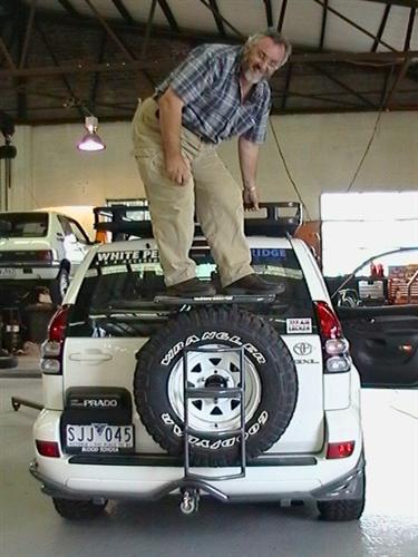

My two cents, I just don't see a ladder on the back end as a useful addition. If I need to secure things to the roof, I either stand on the sliders and tires on the sides or on the tail gate on the back. Only other reason I'd be on the roof would be a tent and it has a ladder (and it opens to the side or well past where the ladder is in the back).
I think the simple ladders on the Hannah and 4x4Labs bumper look great, but I don't hear about many people using them. I really like the idea of a modular system, but I think more basic would have more appeal. Options like:

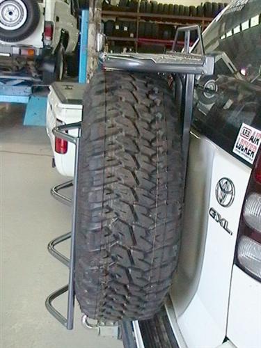

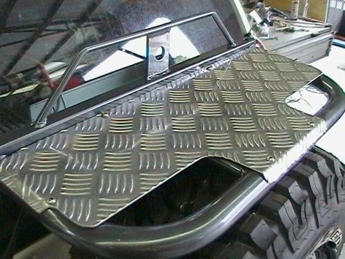

We get a lot of request for a ladder and also for a jerry can holder. What we are trying to do is have a jerry can holder what incorporates a ladder and essentially getting the ladder for free.
Is it because they don't work easily or people just think it is cool to have a ladder? I can see where getting on the roof help, but you have valid points re the tent etc. For those people this would not make sense but they still have the option to purchase the bumper with dual swingouts and have it customized they way they want.

I agree with the above comments that a ladder, for access purposes only, is not necessary, as it is just as easy to climb on the wheels or bumper. But then again I'm tall so its not that big of a deal to me.
I do like the fact that you can store/fasten other gadgets, including additional jerry cans, to the proposed ladder. That is useful, and fairly unique from what I have seen.
Also, I frequently use the 2" receiver for not only my tow ball, but also a bike rack and pintle hitch. For the bike rack, I use an extender which brings the rack back far enough to clear the jerry can carrier. This affords lots of different configurations.
Having said all of that, the only ladders that I have ever liked are the aluminum ones incorporated into the D90 full rack systems. Those work well because of the vertical surface to which they are attached. Obviously apples and oranges compared to the 100.

hard to do cleanly, that was why we went with a ladder on the wheel, and room to stand over it, as here the jerry cans have to be standing up, so they can be used in position as well. The ladder runds are also designed to capture your foot in the corner, so your foot wont slip off.
This type of design could easily have 2 jerrys standing up under it, as a stand alone swing away, with taller storage for shovel etc, or telescopic light pole as well.
The top section was also designed to use a ratchet rope on to hoist the spare up, if running bigger tyres makes it difficult to get onto big lifted trucks.
