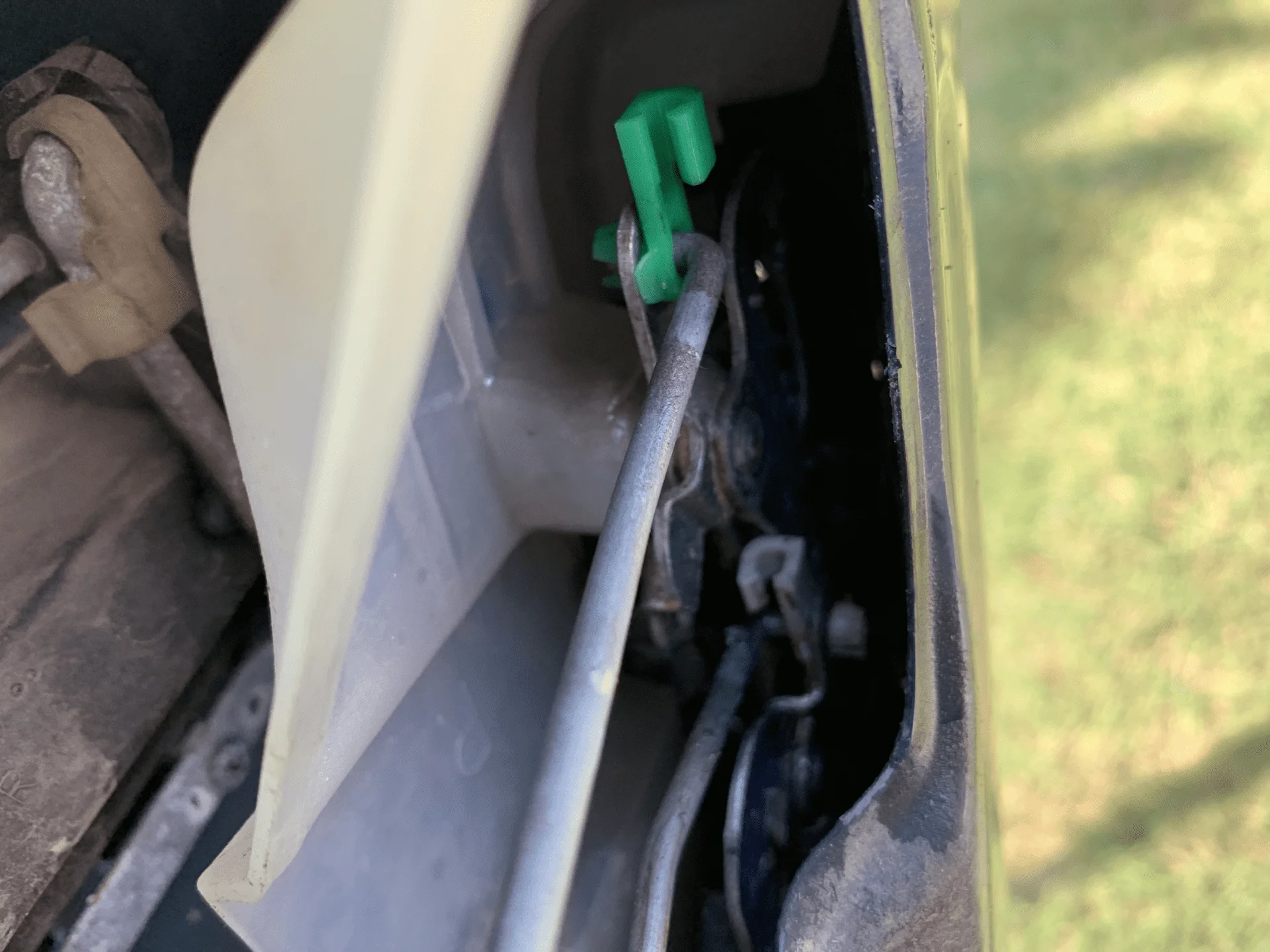

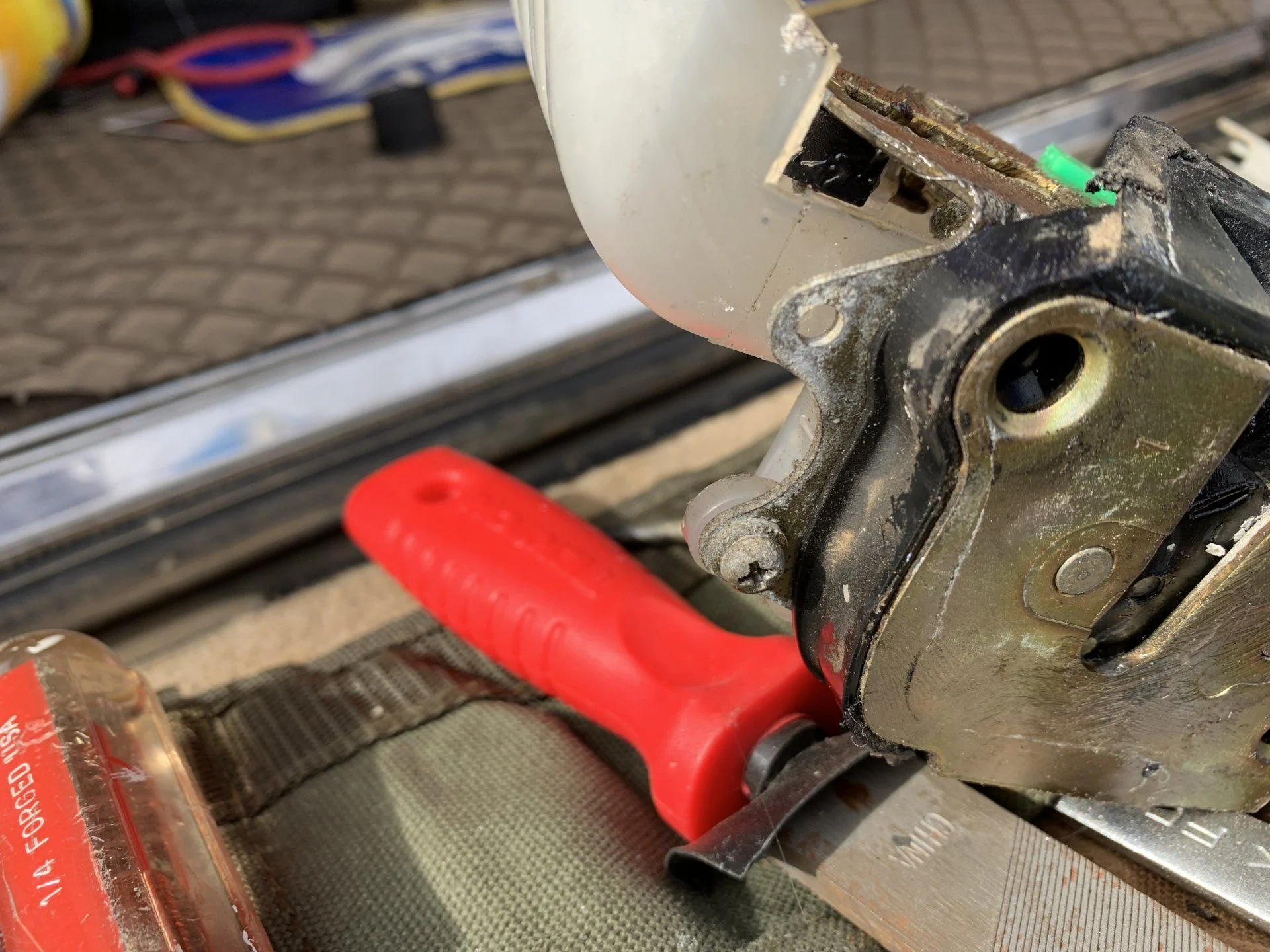

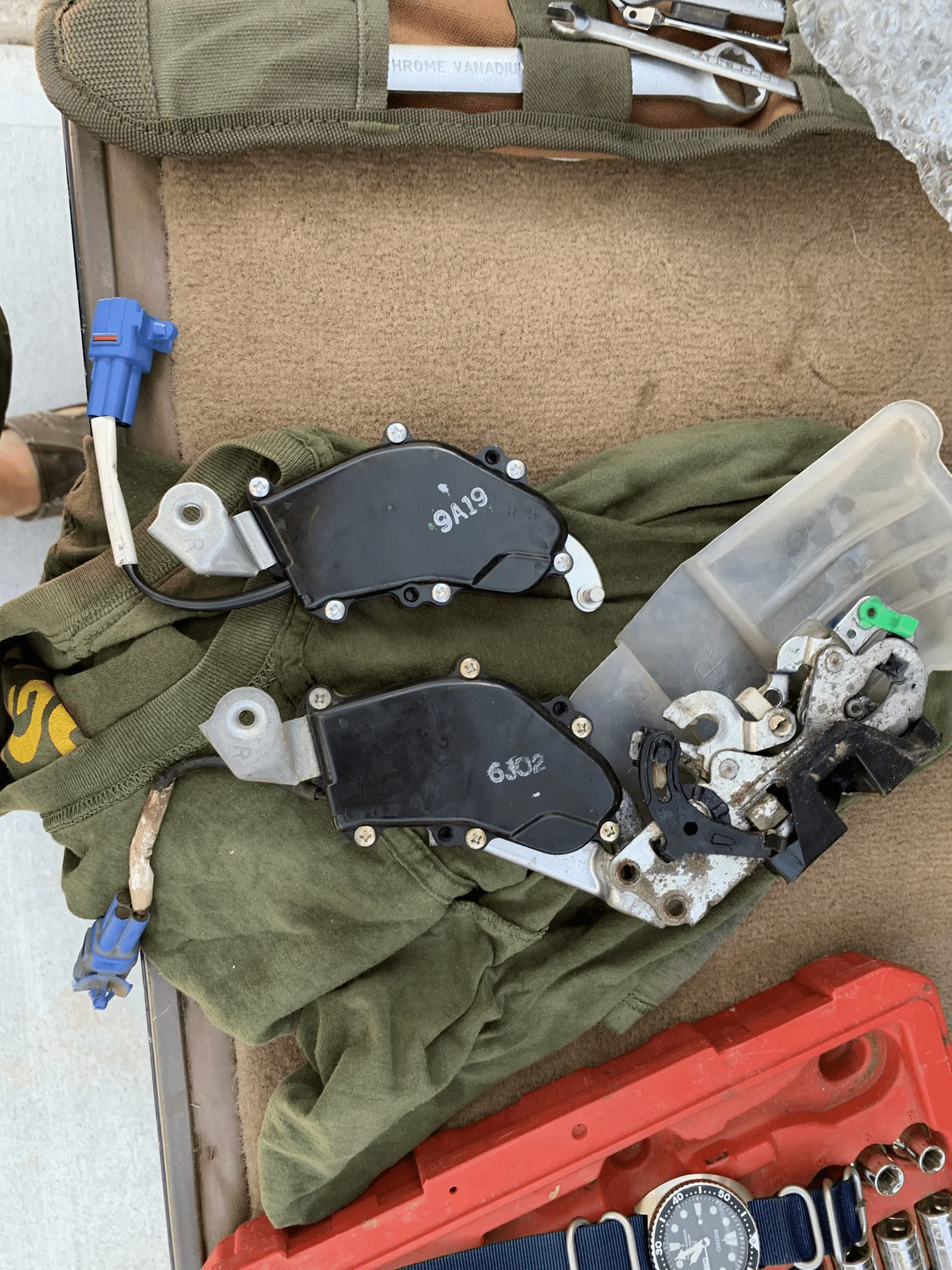

Well, not unexpected since I changed the lock door actuator on the dirver side, the passenger side eventually died during the latest heat wave, climate debacle from last week. So I replaced it. Something that could make it easier for anyone doing it in the future, a little silicone grease spray on the plastic tabs that hold the rods into the actuator makes them less prone to breaking and easier to remove.
There is the green one, the white one below it, and dong forget the bigger white one for the handle that is on the outer side, opposite the plastic shield.
The new Aisin unit from RockAuto goes in, the original Aisin one comes out, 2 screws and done
