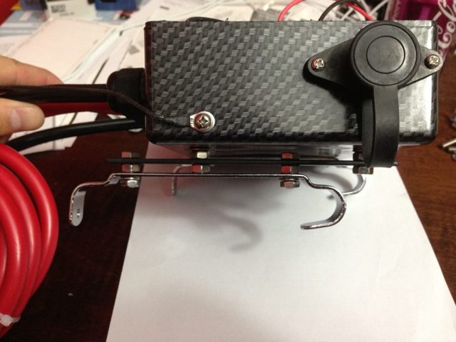

Heard back from Metal Tech. This component that was shipped is a universal solenoid box mount. I didn't know what is was, will see if I can finagle it in there.
The way it would be bolted to the bumper is the 2 slots bolt to bumper lip, the larger flat area would create a shelf to mount box too.
Option 2 might be easier, found this last night googling around. Only one of the box "grips" holds on to the top of the winch. Seems legit enough but not sure, it was on a winch website. https://www.usoffroad.us/winch-fitment/
You can remote mount the box almost anywhere. The only thing you will require is longer wires if you mount it farther than the wires reach.
UUHHH, this may work and be a simple homedepot/lowes fix for me. Offsets the whole box forward.
