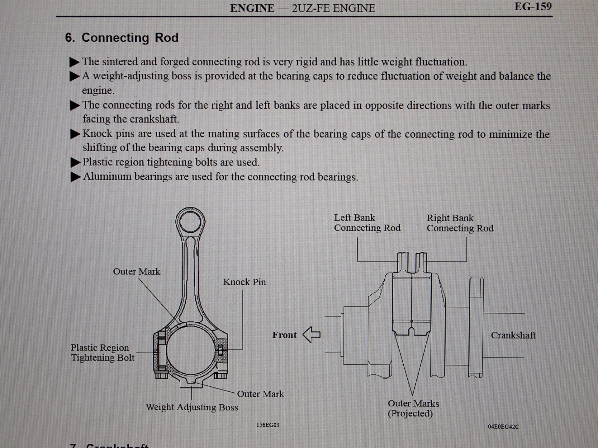

All 2UZ 4.7L use forged rods.

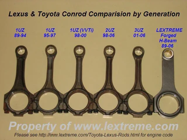

All rod are forged. The early rod used in 1UZ 89-94 can handle the boost, and are said to fit our 2UZ. Toyota went to smaller mass after that. Which is fine for stock. But put on a TC and dial up the boost a little to much and rod gets damaged.
Looks to me like the forget one has more mass. That has to put extra loads on bearings/connecting rod. I would suspect a shortening life of the engine.
It's impossible to tell from that pic. The forged rods there are H beam rods that have a totally different design than the more common rods (I Beam, I believe). The cross section would show very thin walls. The pic angle is deceiving.
Mass isn't typically the utmost concern for those strengthened rods, anyways. They're first purpose is to be stronger and allow more power per stroke. Higher mass will affect all sorts of things, but you could sacrifice some rotational mass if it allows you turn up the boost safely.
