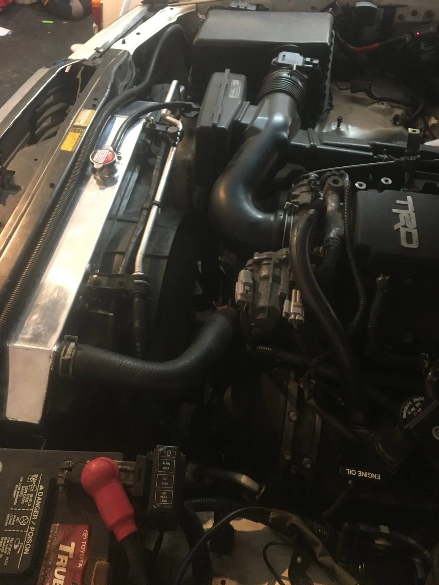

I installed my trd blower around 200k and currently have 225k. I had belt tensioner issues right after the install but thats from the original unit with 200k. Swapped in a new oem one(comes with smaller pulley) and got the right belt for the setup. It has been a trouble-free 25k miles since.
