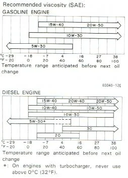

Here's the 80 series recommended oil chart posted in an older thread:
The minimum on the upper end of the recommended range is 30 weight.

I'd happily run an oil that starts with 0W, but I absolutely wouldn't run one the ends in 20! That means it thins out to what a 20 weight oil would at temperature.
