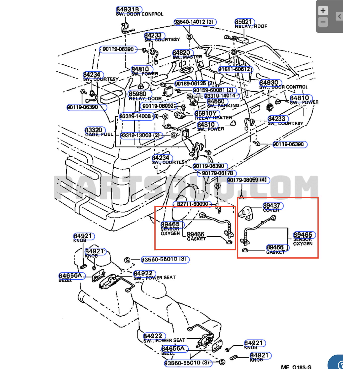

On my 1997 1FZ-FE US spec, the O2 sensors are in one of the electrical diagrams.
I can confirm there is no sensor connected as shown in these diagrams at all. I did search partsouq with the VIN and no results found for an O2 or Oxygen sensor. It might be in the engine bay?

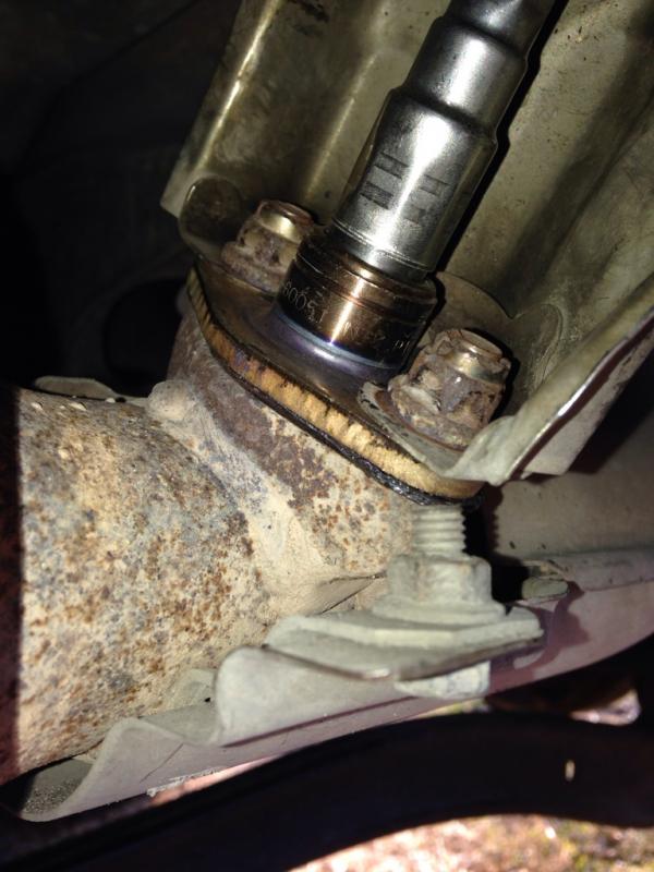

If you have two inline catalytic convertors there should be one O2 sensor attached before the first Cat and another after the second Cat but before the muffler.
Here's an example of what you're looking for:

AU spec 1FZ-FE 97 doesn't have oxygen sensors, no. (Or EGR, or Cat converters)
93-94 with the VAF/AFM had a single oxygen sensor but 95+ with the MAF didn't.
