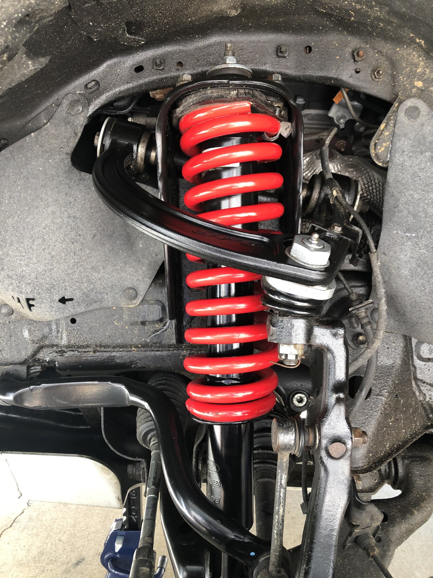

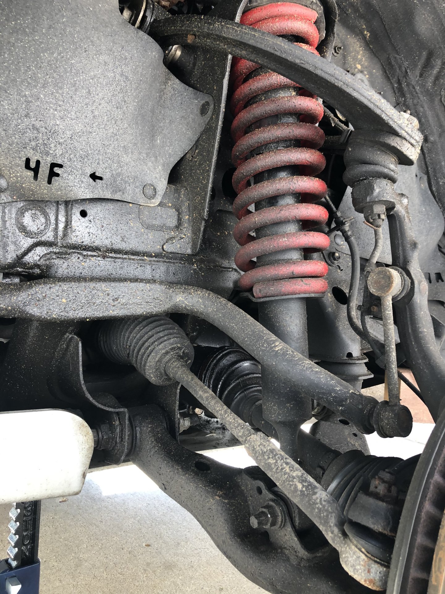

I finally finished a coat of Corroseal. It is kind of a hassle trying to get it in all the nooks and crannies, but it really did take care of the surface rust. Looks pretty good for the moment.
I need to followup with a coat of fluid film, or some corroseal touch up, probably next week.

Did you just applied it directly on the rust or scraped the rust off and then applied? Thanks
My rust wasn't too bad, just surface & not to the point of flaking off - so just power-washed & applied directly.
Hopefully it doesn't return after the Fluid Film is applied.
