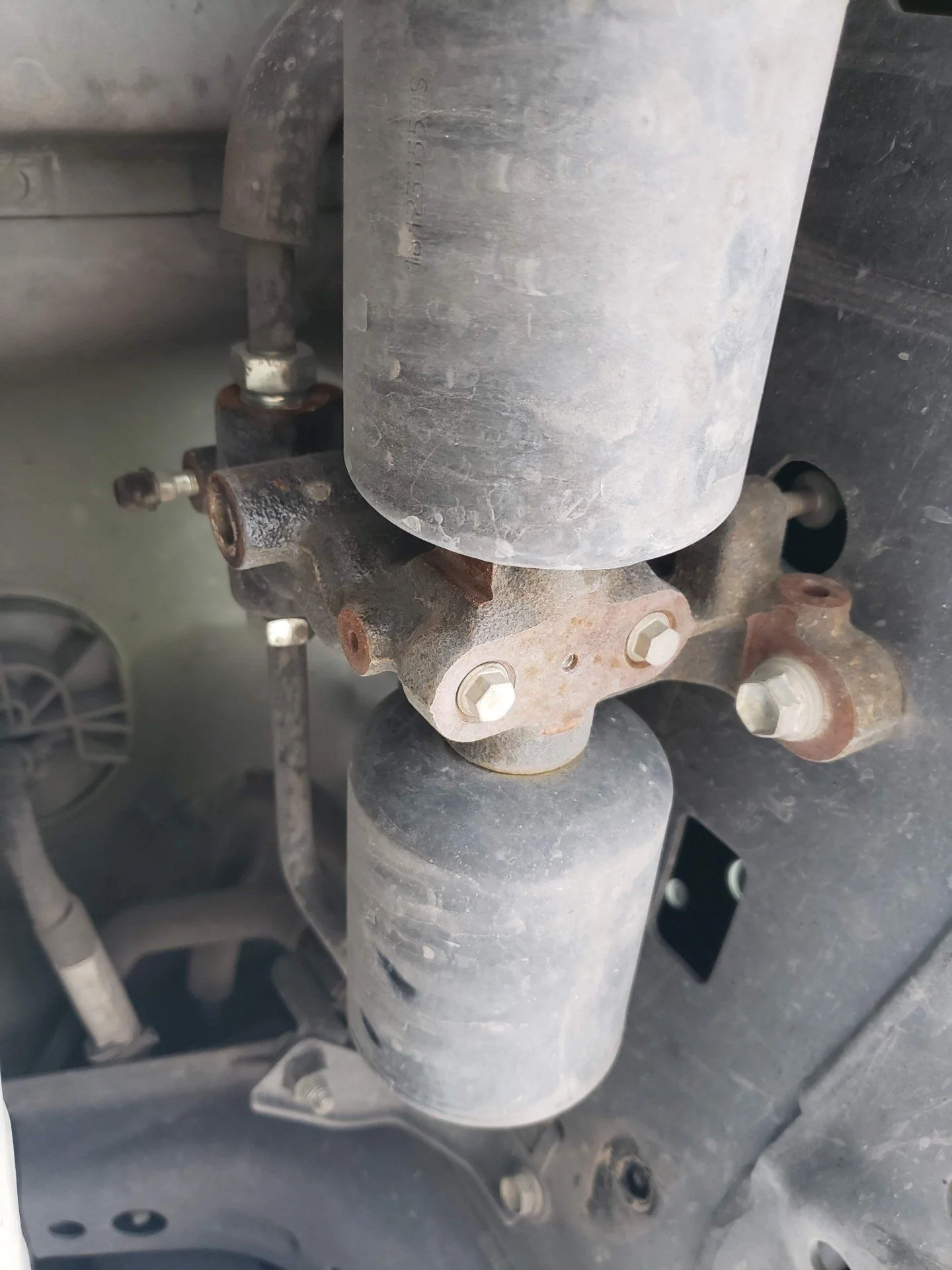

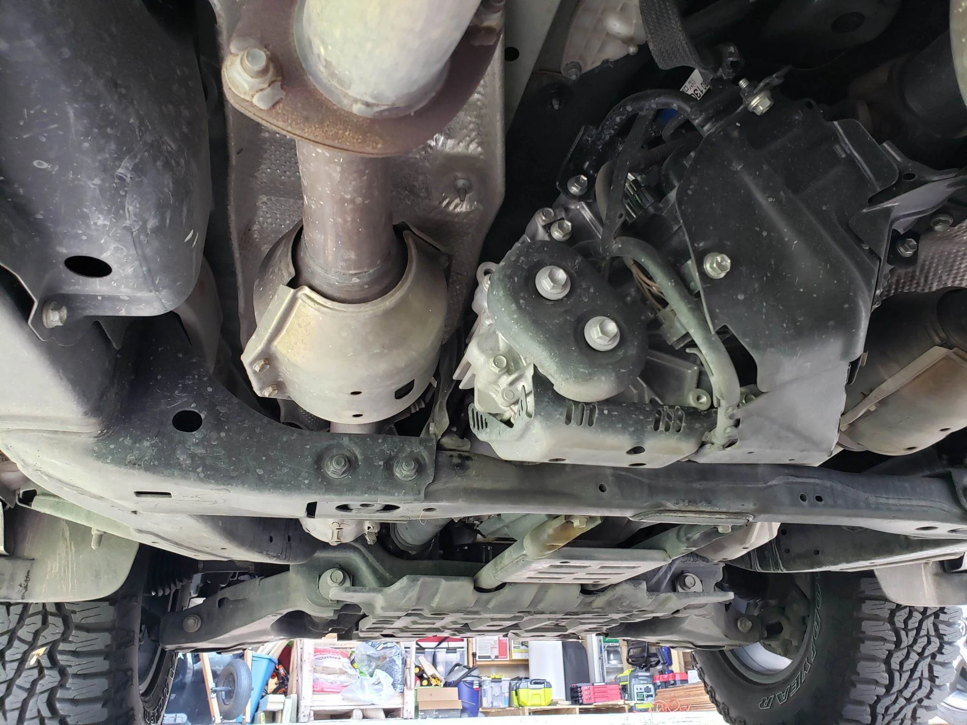

It all depends on where the LC has spent most of its time. My 2018 LC with 52,000 miles has zero rust anywhere, it has been in TX the entire time. If you're looking for something from CA, then you'll probably have no rust problems. This is the general consensus I've seen brought up in other threads, too. The KDSS valve enclosure started to get some thin surface rust, but that is a well known problem with the LC200, and you can prevent further corrosion by covering the KDSS valve with a LPS3 or something similar.

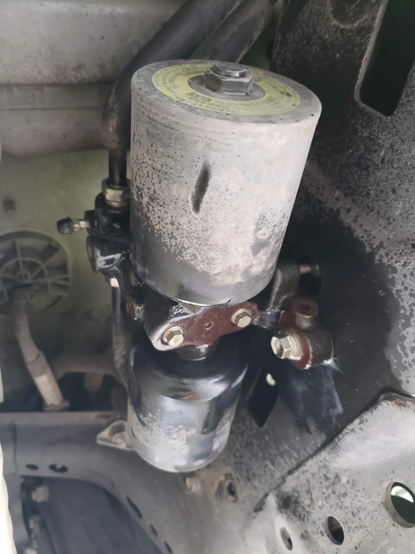

Here's after I coated the KDSS valves with LPS3:
I live in a dry climate and have only taken it on winter salted roads for two weeks and it shows rust. I used LP3 too on all of the exposed parts as you did. I really can't imagine owning one of these in the upper midwest or the east.
