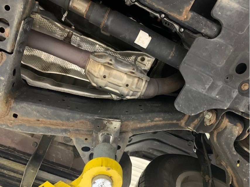

I’m looking at a 200 series with the following undercarriage. I’m not as familiar with vehicles from the northern states/New England. Is this an acceptable level of surface rust for a 2016? It doesn’t appear like anything to be concerned with, but as I mentioned, I'm used to southern cars where this isn’t usually an issue.
Looks good for CT standards. Buy, drive, and enjoy
I’ve got a 2007 LX 470 and a 2013 LX 570. Both are South Texas trucks. The 200 had/has more surface rust since I got it in 2017. The 100 series is virtually clean, acquired in 2011.
Weld joints on the 200 are most noticeable. Not bad, but I was surprised after having the 100 for so long.
Looks good to me, having lived in Massachusetts before
Finally a slightly rusty 200! The coating, or in most cases the lack thereof, on the 200 is my only real disappointment.
Note the spare tire is mounted upside down and it’s not as secure as it should be.
Congrats on the new ride!
Great catch!! Thanks for that. I’ll have them flip it before I pick it up.

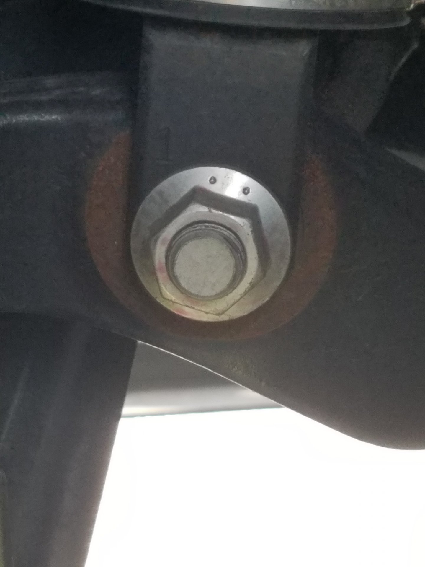

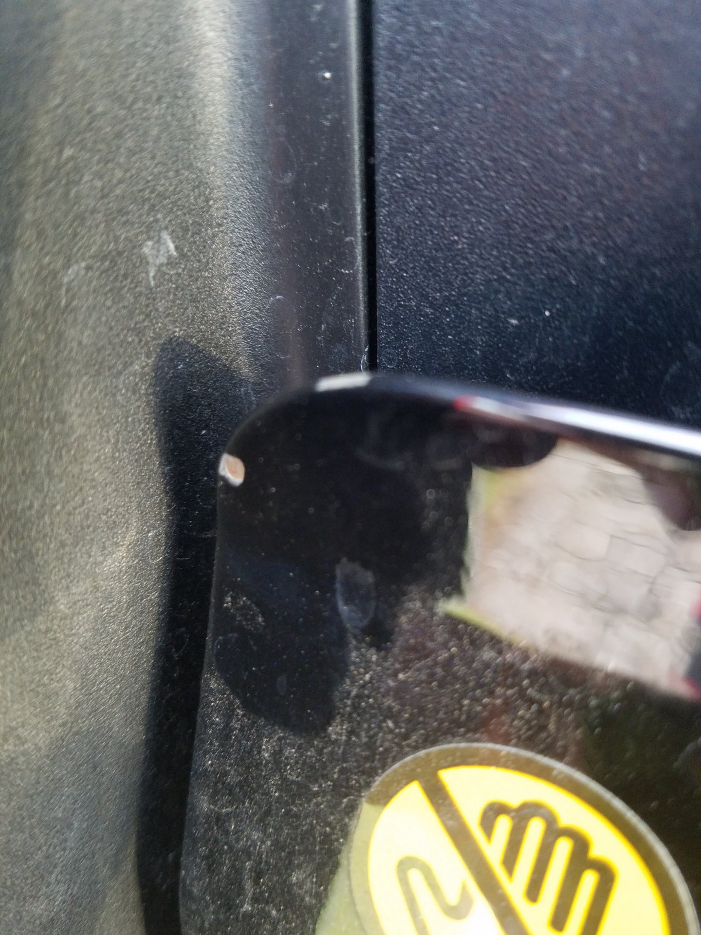

Thanks for the help! My cousin is going to take pictures tomorrow and Ill try to post them. I

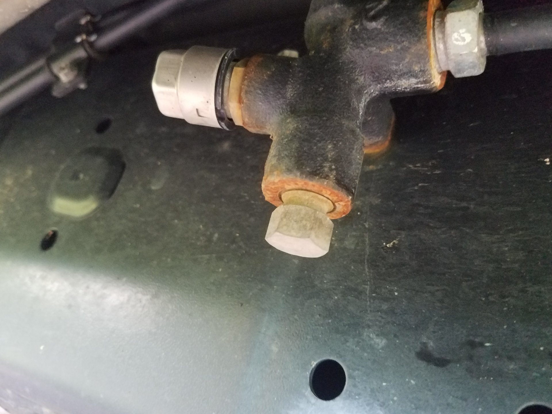

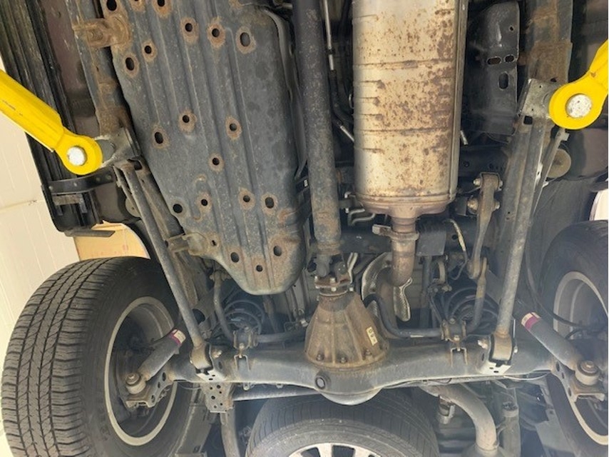

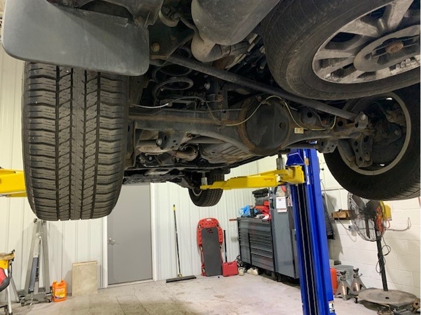

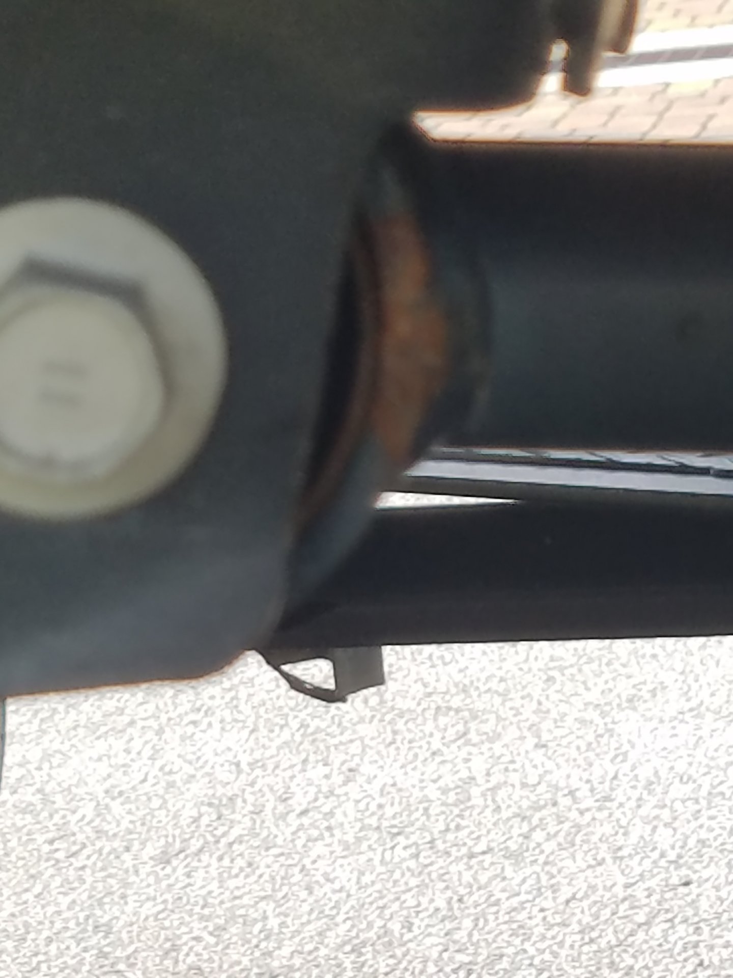

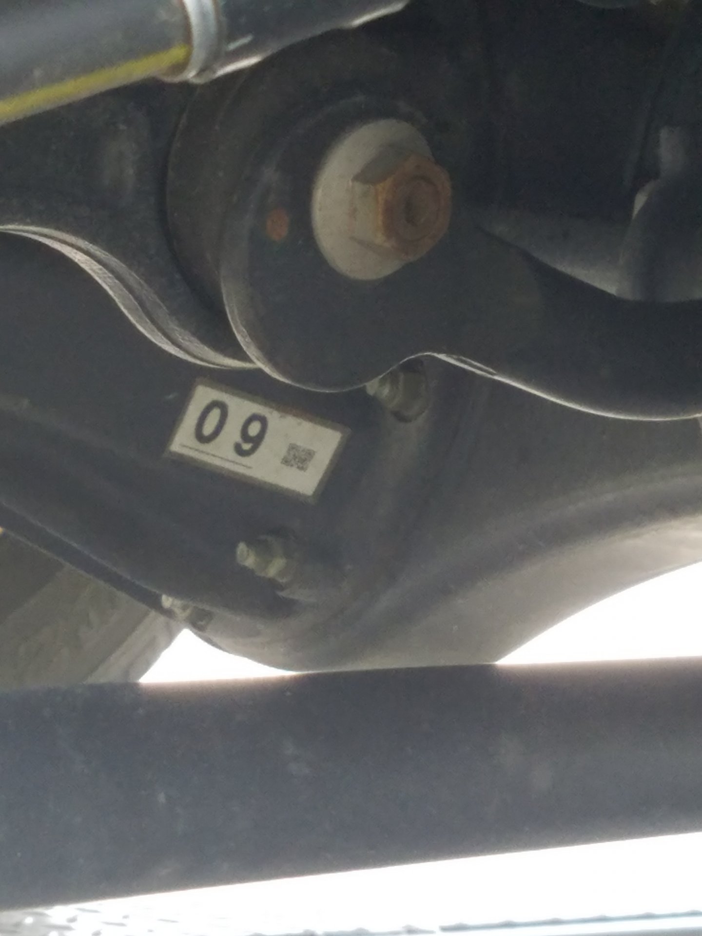

Here are pictures taken by my cousin of the undercarriage. These are the only places with any rust visible. None really noted on the frame. To my it doesn't look that bad but I would like to hear from those on here with way more knowledge and experience than myself. Sorry for the poor image quality.
Here are pictures taken by my cousin of the undercarriage. These are the only places with any rust visible. None really noted on the frame. To my it doesn't look that bad but I would like to hear from those on here with way more knowledge and experience than myself. Sorry for the poor image quality. View attachment 2765885View attachment 2765886View attachment 2765887View attachment 2765888View attachment 2765890
This is no factor at all. No issues from my view.
