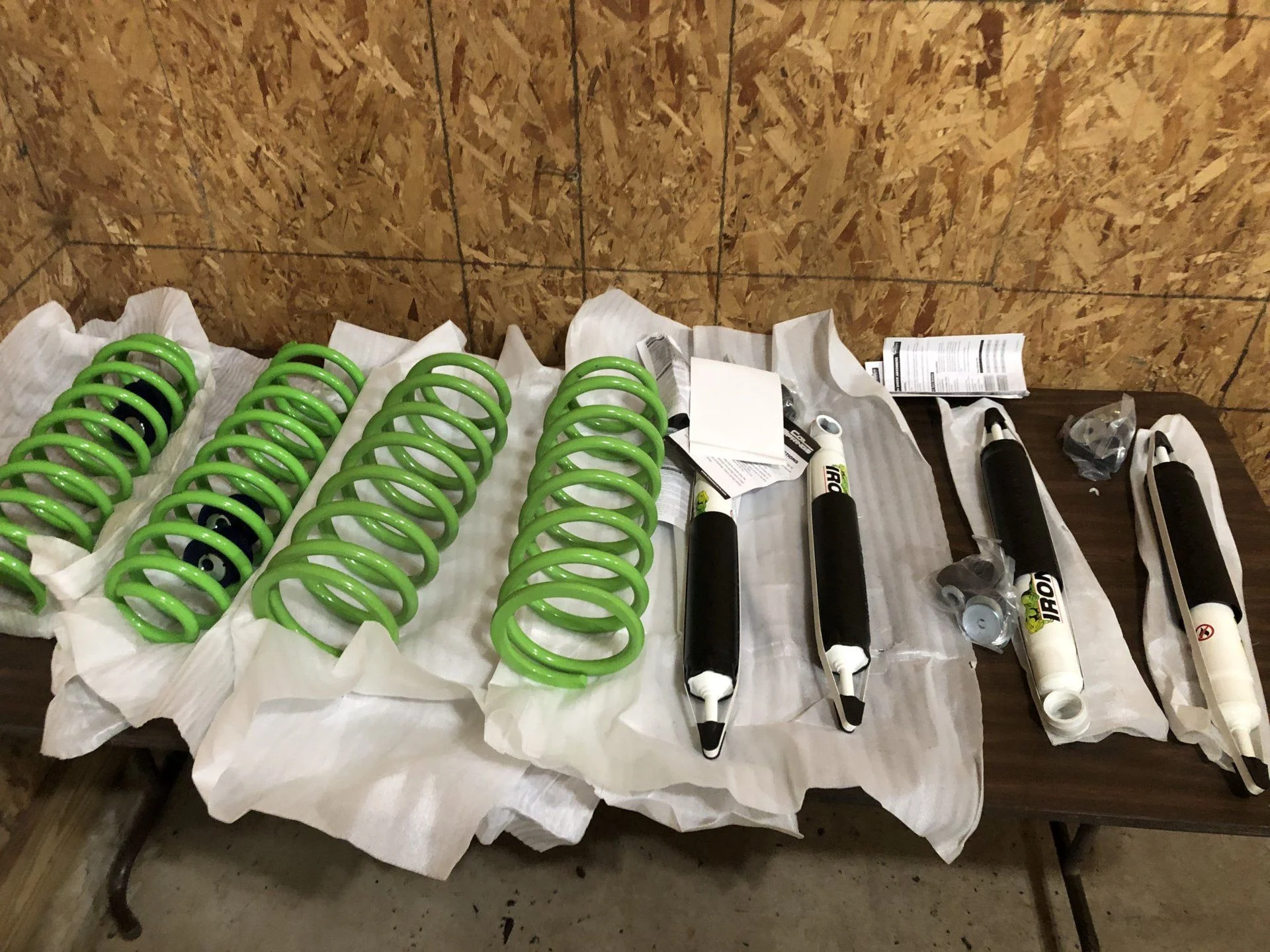

Kyle, did you end up getting the Ironman kit? I am 70% in on buying the Nitro shocks.
Yes sir--everything went well besides some broken bolts and nuts. I haven't had it off road yet but so far it has been great.

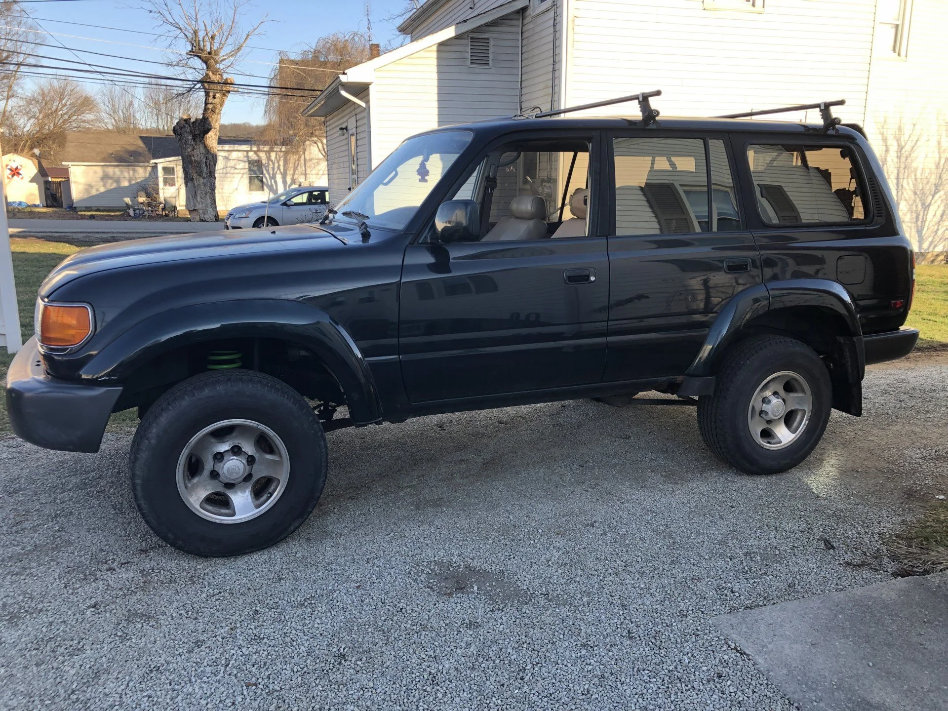

I installed the 2” recently, so far very pleased with the ride. Haven’t gotten it dirty yet but it’s been fine around town.

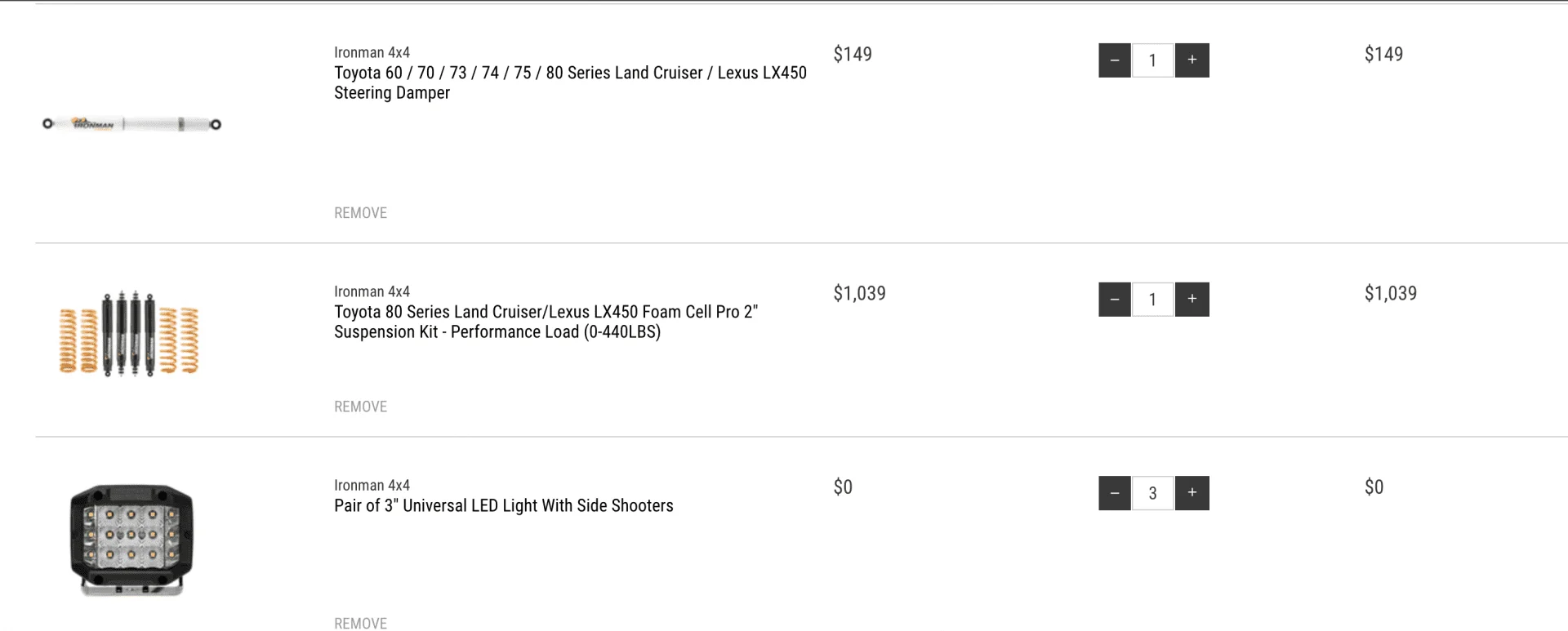

Following on this. Looking at pulling the trigger on the Ironman Foam Cell Pro 2" w/ the steering damper. I do some off-road. I do drive freeway pretty consistently. Will I need the damper? They're running this deal where you get the LED lights free. They were sold out of the cheaper version, the regular foam cell.
Is it overkill for the "pro" version? I have a quote with OME right now for about the same price for the same stuff. Didn't know if this "pro" version was better tech at a discount.

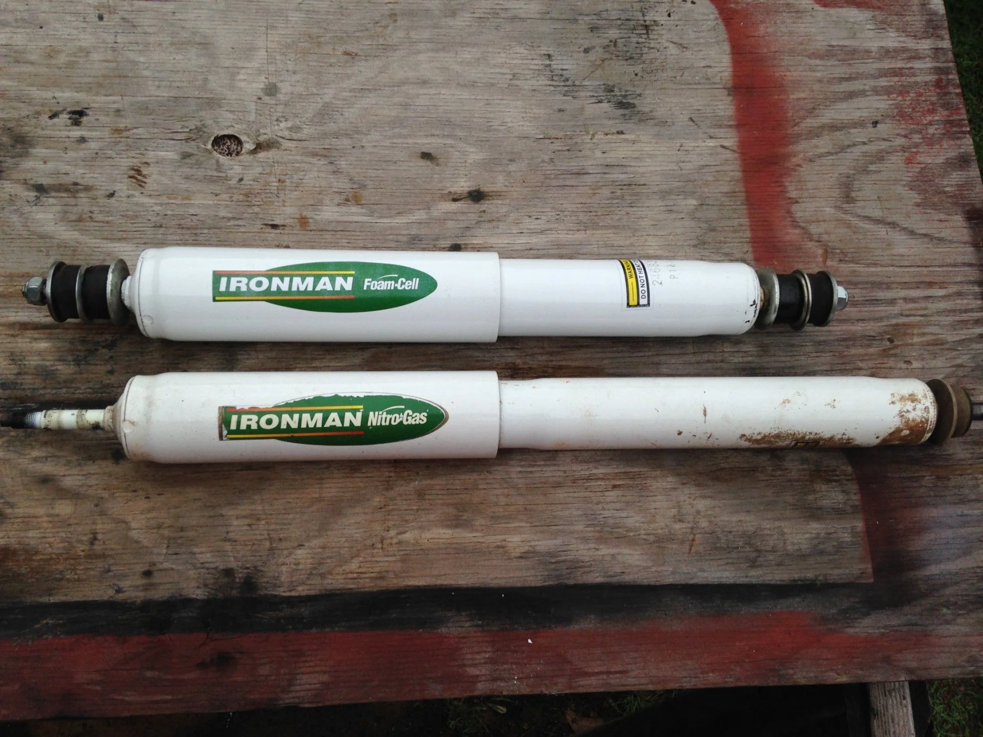

I originally had the nitro gas shocks and then went foam cells which were slightly larger and just have foam inside the shock. They rode a little bit firmer, but that might have just been due to the new shocks vs old ones the replaced. Haven’t really had any problems
I’d bet the foam cell pros just have a larger body diameter.

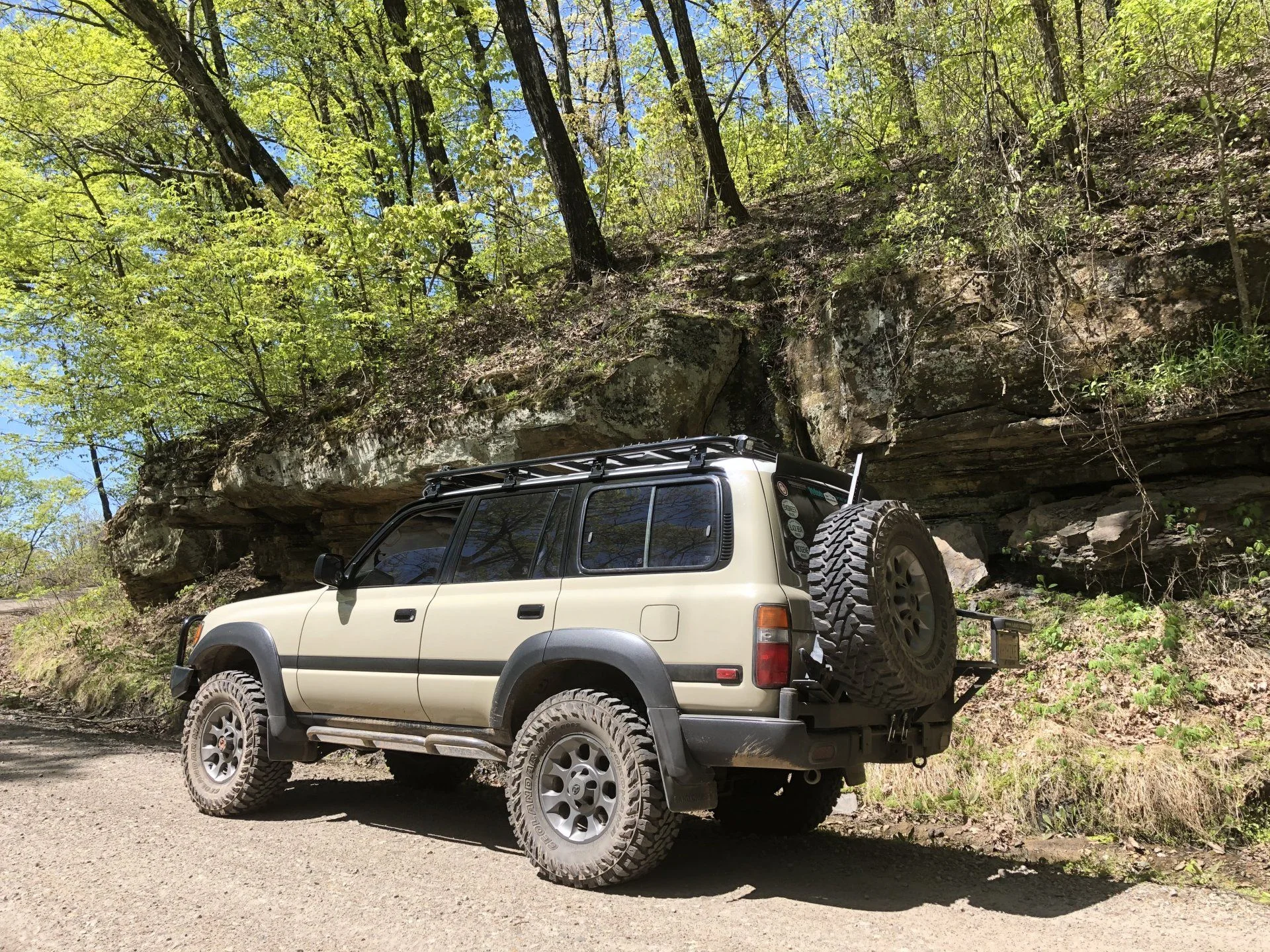

And here’s how my cruiser sits today

This feedback is super valuable! Rig looks super good too, btw.

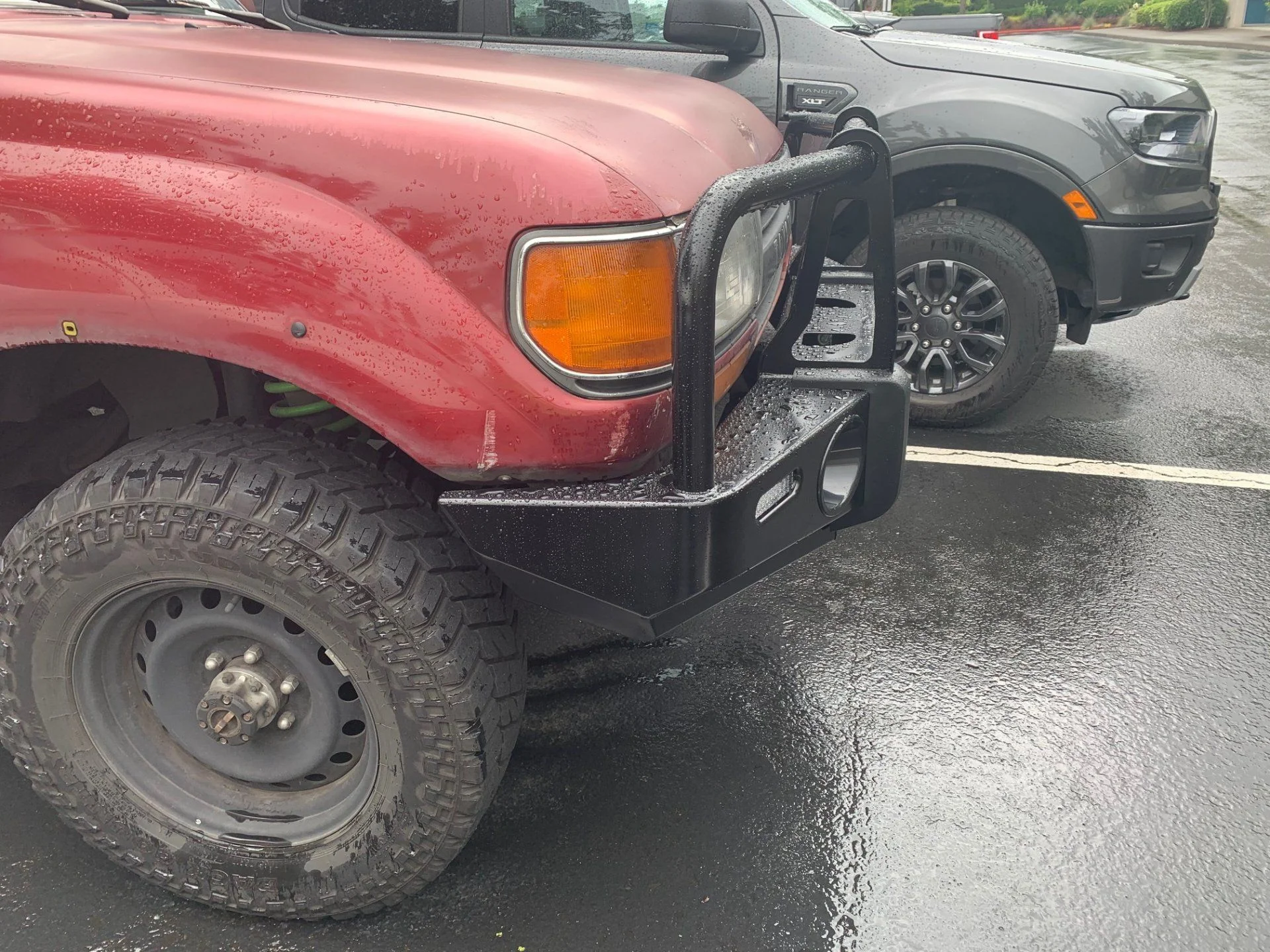

Did you like the Ironman Nitros equally then? For the money, I feel like I could get both a bumper and the nitros.
Currently, on the site, they have the 0-440lbs available in stock. Would the bumper be too heavy of a load for that setup?

Nitros and performance coils work just fine with the bumper... they look good too. *NOTE* I work at Ironman 4x4 America, so take of it what you will. Cheers! John
