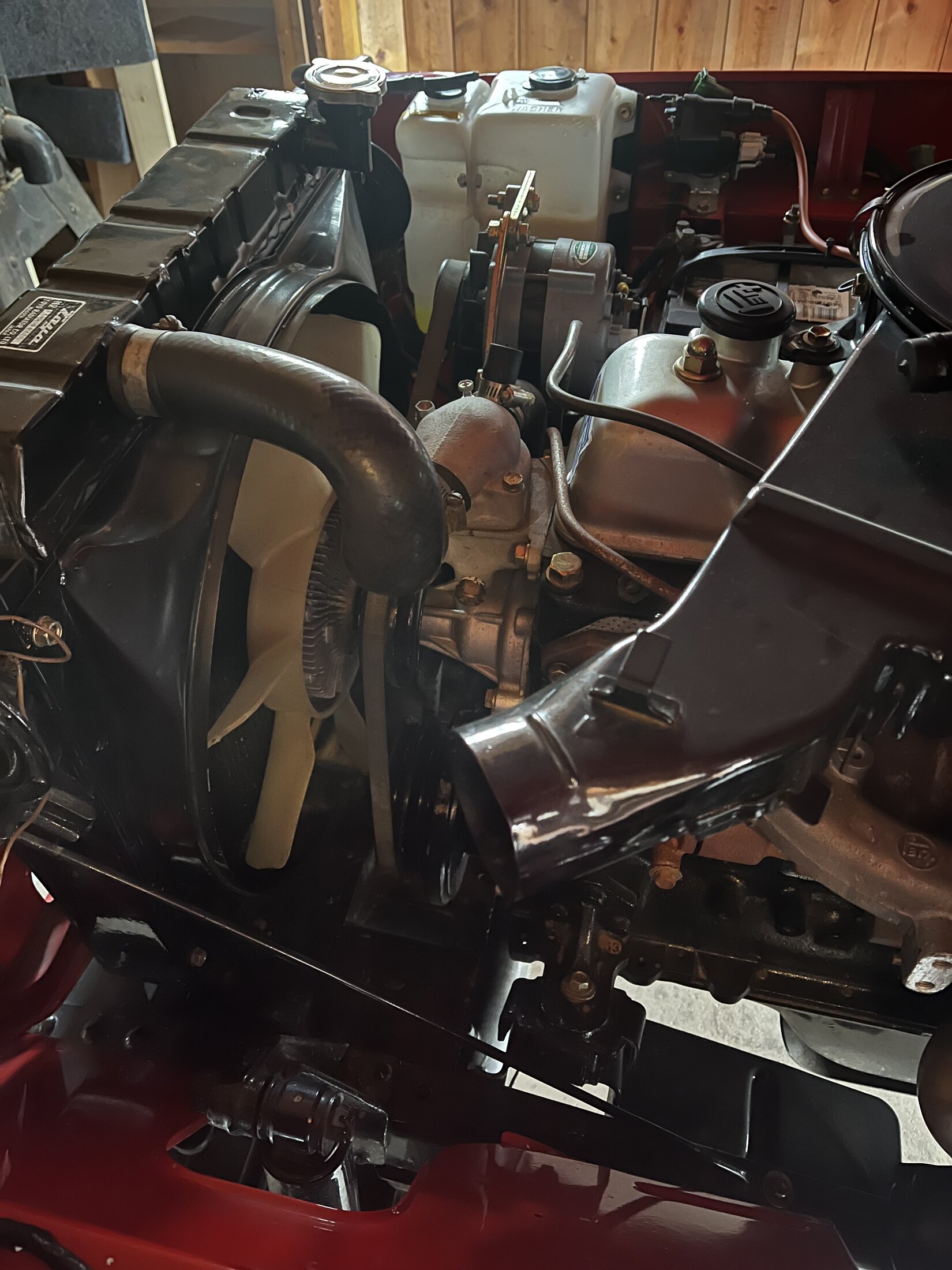

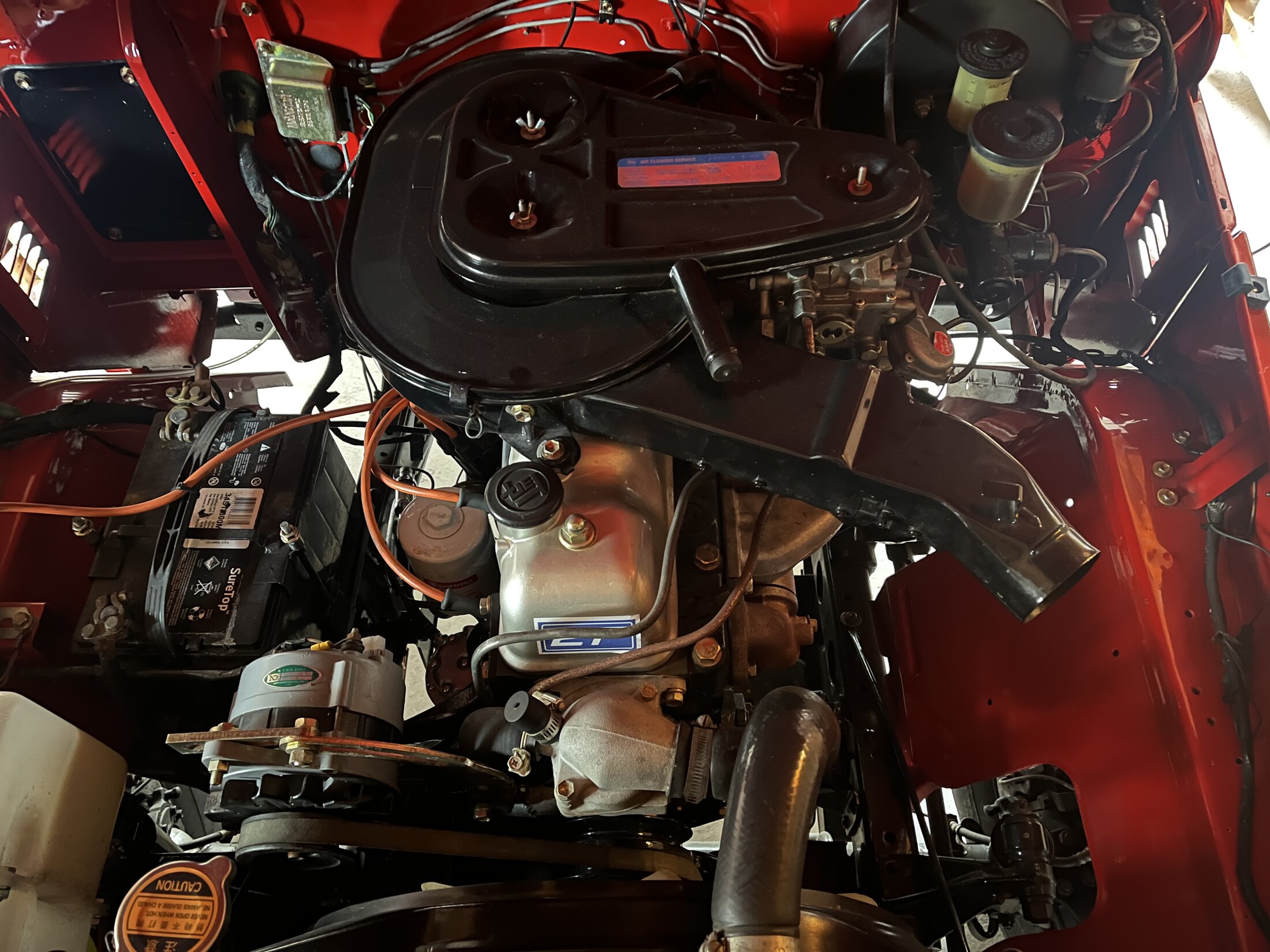

Post some pics under the hood. We can probably tell you pretty quickly if you'll pass the visual for smog equipment. Does it have a catalytic converter?

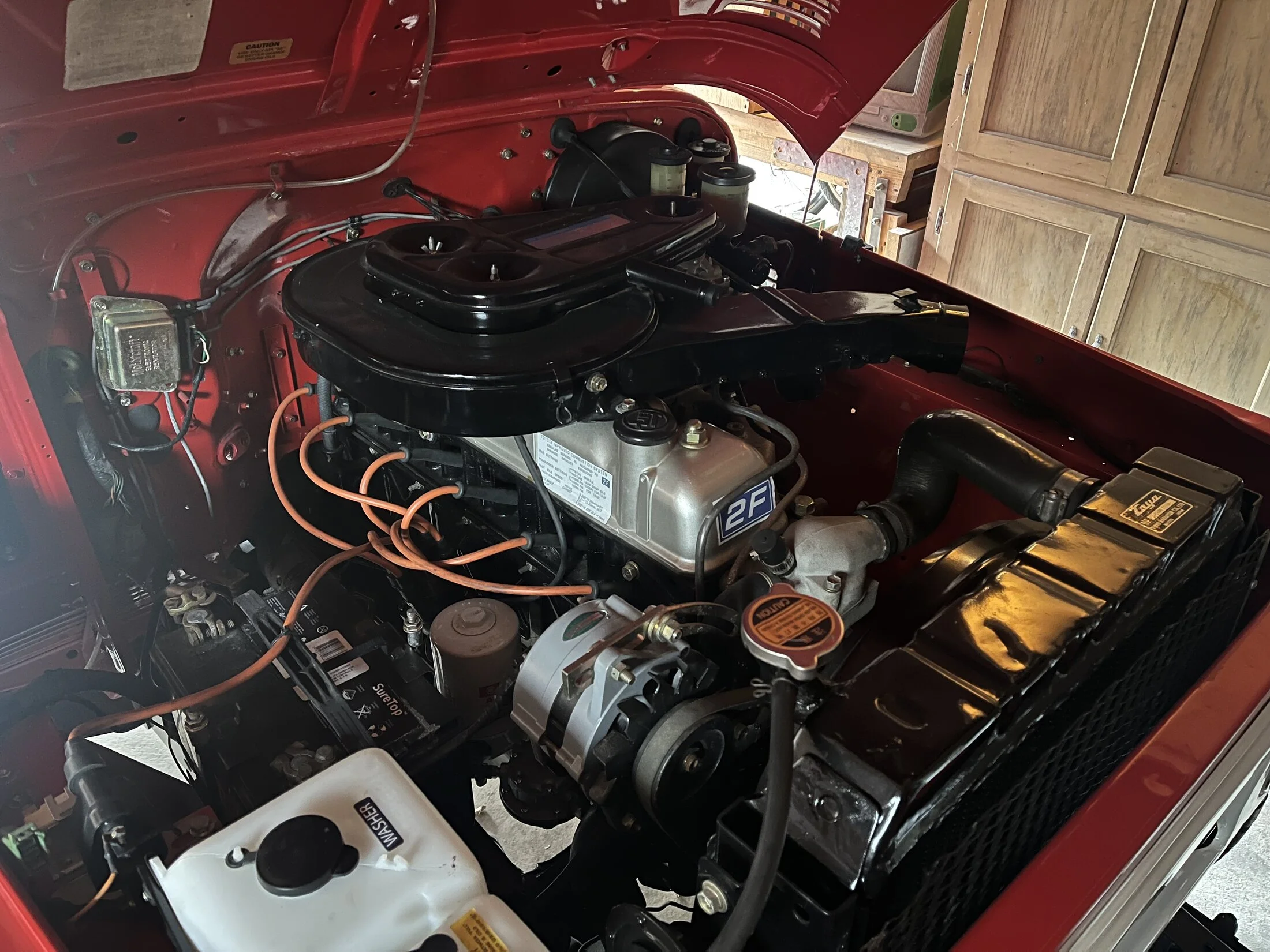

Looks like no cat from what i can see. Here’s the engine bay:
Engine bay looks very similar to my old South American '78.
It also had no smog equipment or hook ups for smog equipment. Not sure the smog system can be retrofitted to an SA truck?
biggest miss is the air pump. too bad I just sold a complete 1978 takeout 2F (from a FJ55, but a lot of the smog stuff is the same)
Yeah, looks fully desmogged. If you're in a county that requires full emissions testing that's going to require a huge amount of work and parts to pass. Any chance you have another address you can register it to?

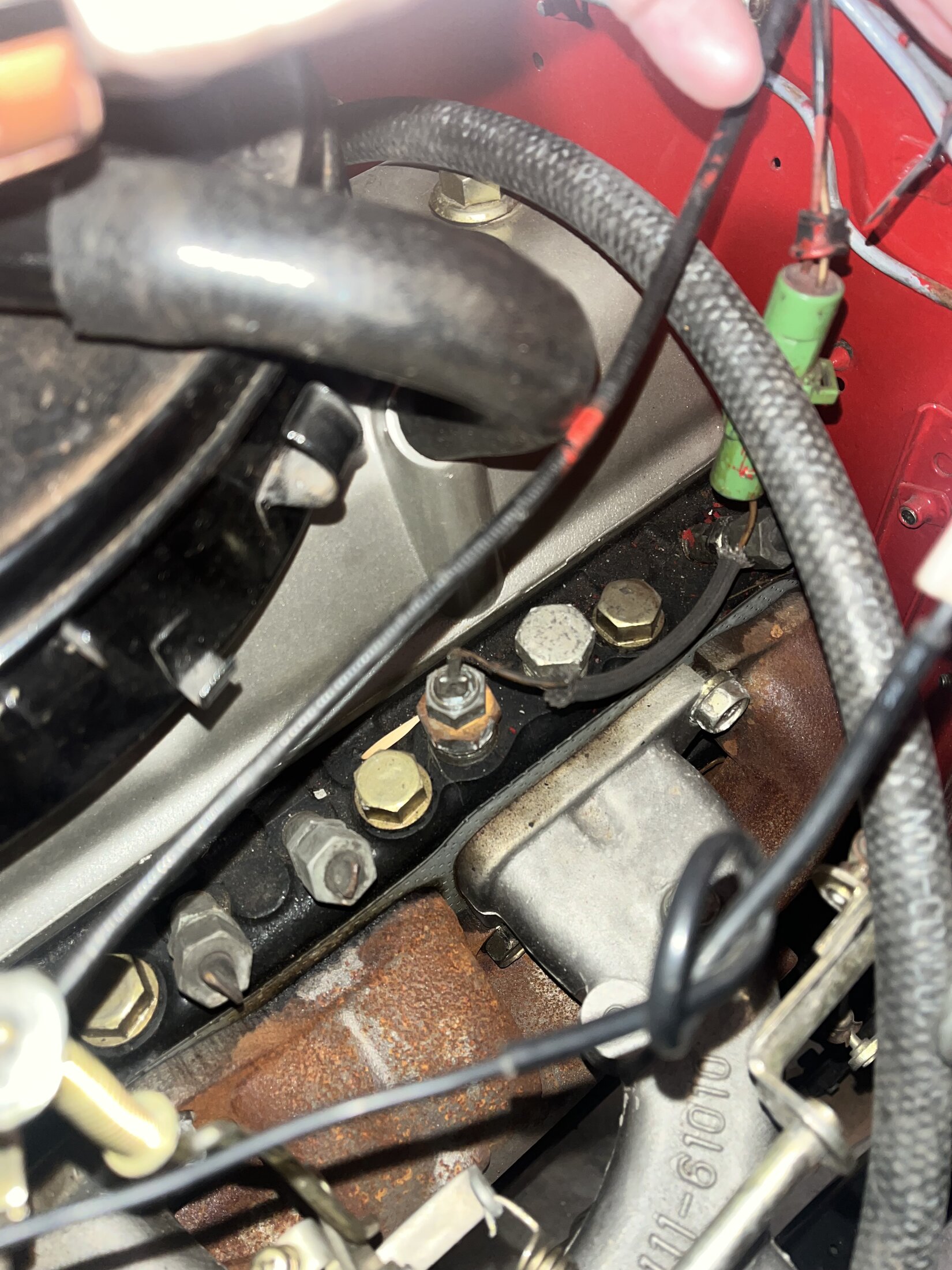

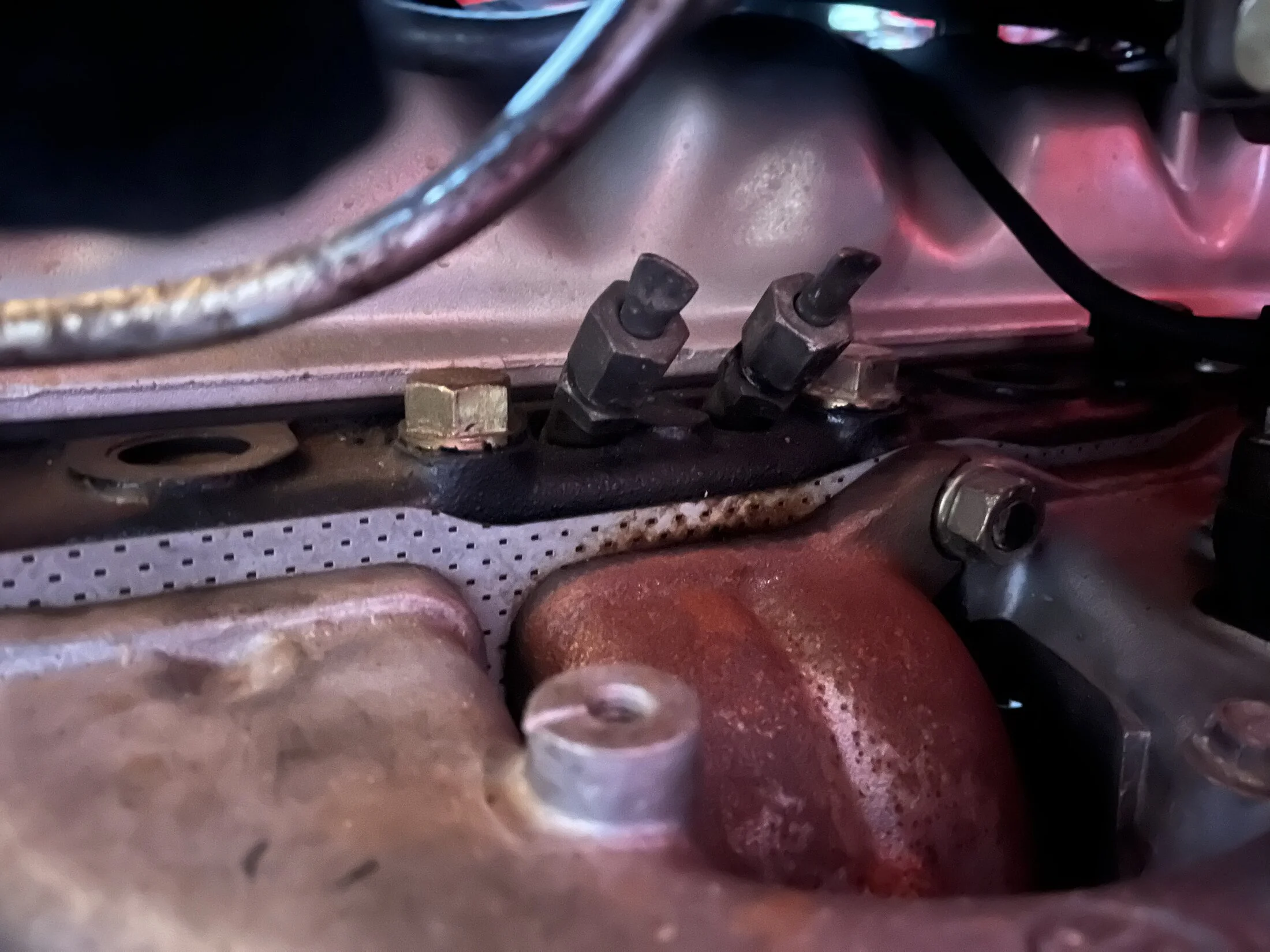

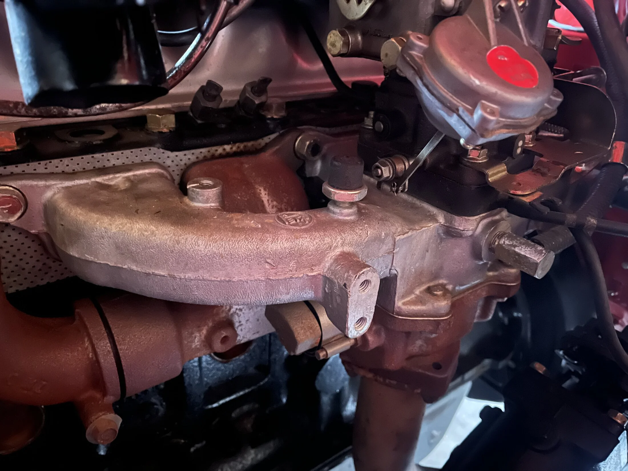

These are your air injectors for your AIS (air injection system), there was attached to them and air rail fed by an air pump and a bunch of other hoses valve and other nonsense that shot air into the cylinders starting mid 1969.
Sound like in your area you will need to replicate all that with parts others have removed from there rig. I have a bunch of that junk I saved from an '83 2F but you may be required to have junk from the same year.
