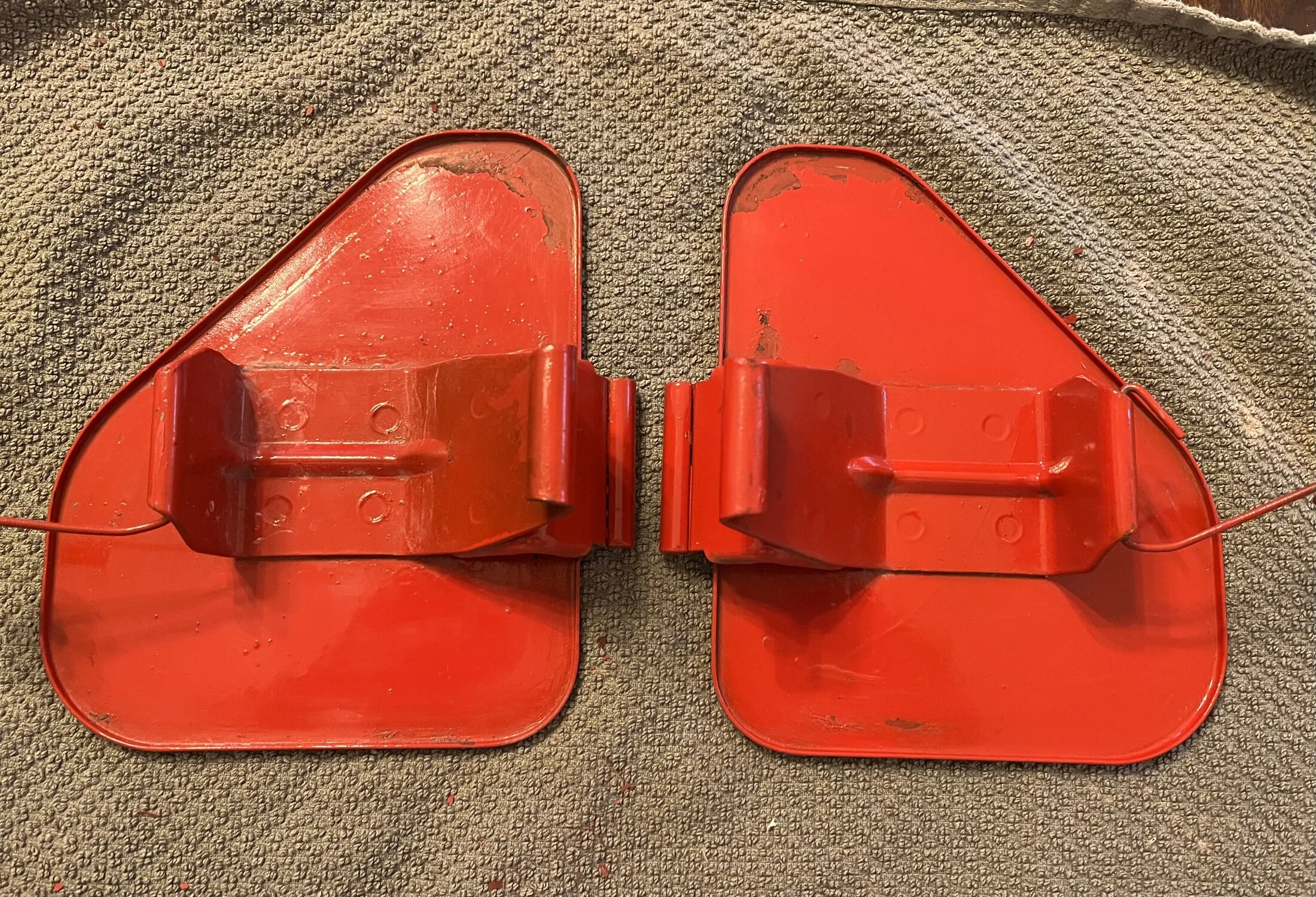

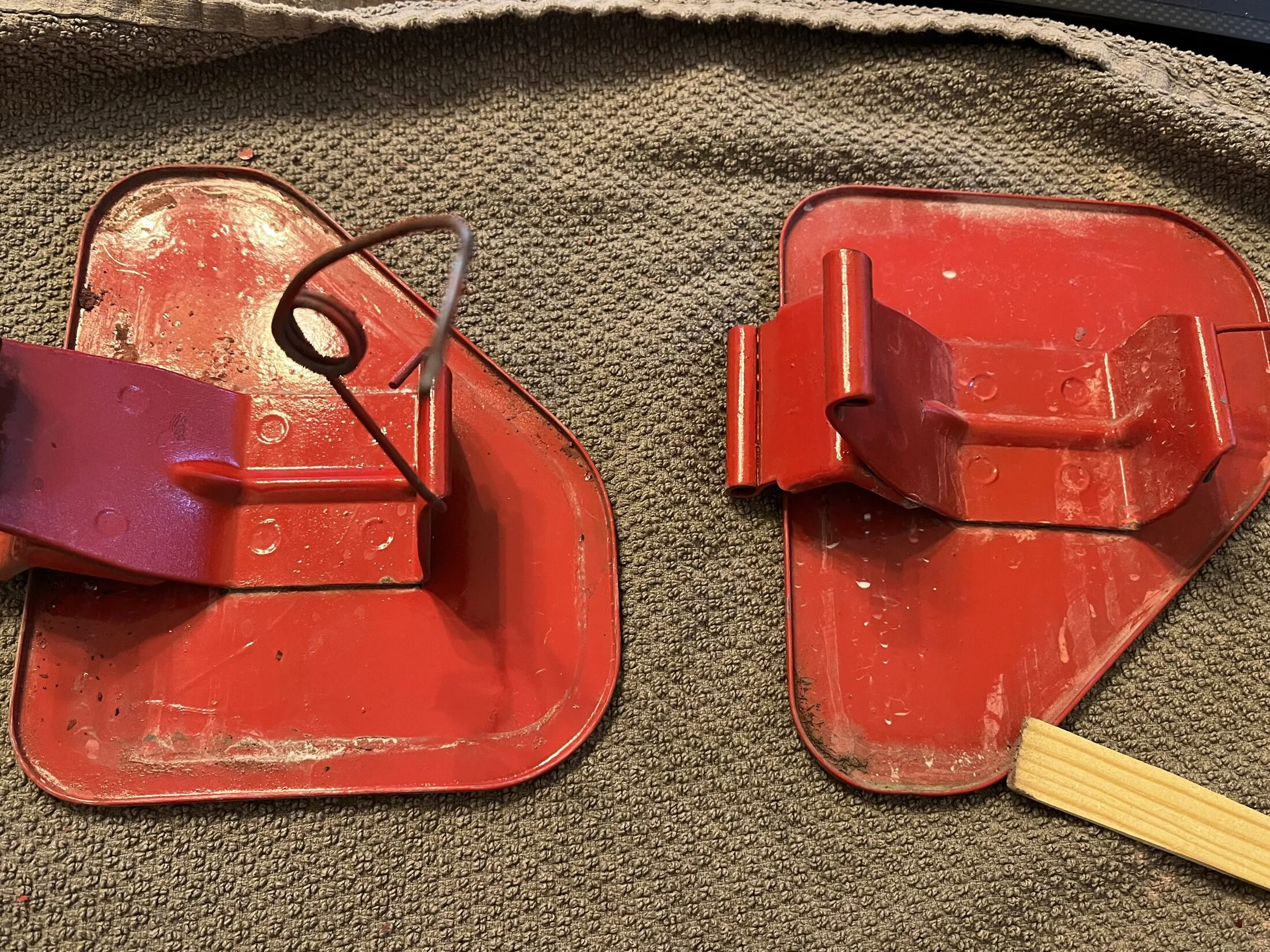

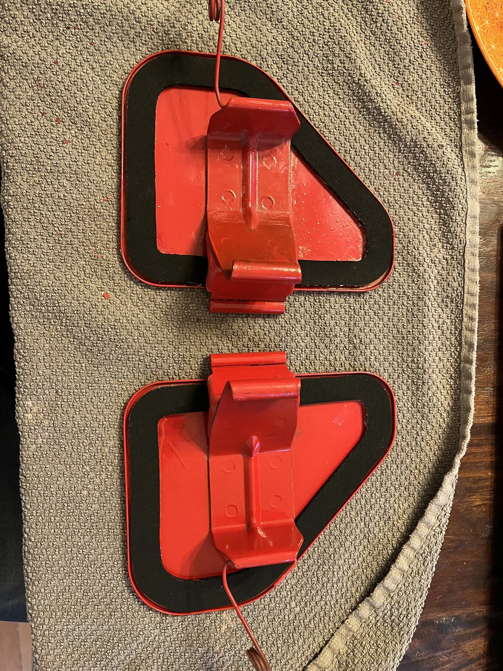

In the mean time while I wait for a gas cap / emissions test, added gaskets to the kick vents…. Cleaned cud off the doors w alcohol and used 3m super 90 to adhere the gaskets.
Had to adjust spring tension a bit and am using some clamps overnight to compress the gasket a bit so the doors stay flat.

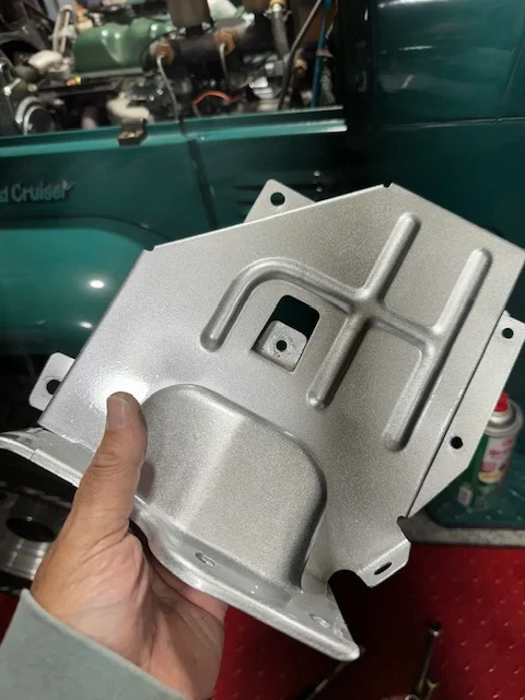

Good luck…hope it works for you…. That vent cover cleanup is a nice satisfying end game. Don’t underestimate a quick shot of clear on the part you might want a little gloss on. I did my fuel hose cover and evaporator cover behind the passengers seat with a type of matching pewter. When I hit it with a quick spray of clear, it looked like a diamond…sparkling under a jewel case lamp,
Just make sure you let the color coat dry or use a compatible clear coat spray… solvent can eat the paint below to a spectacular wrinkle finish (YUK)

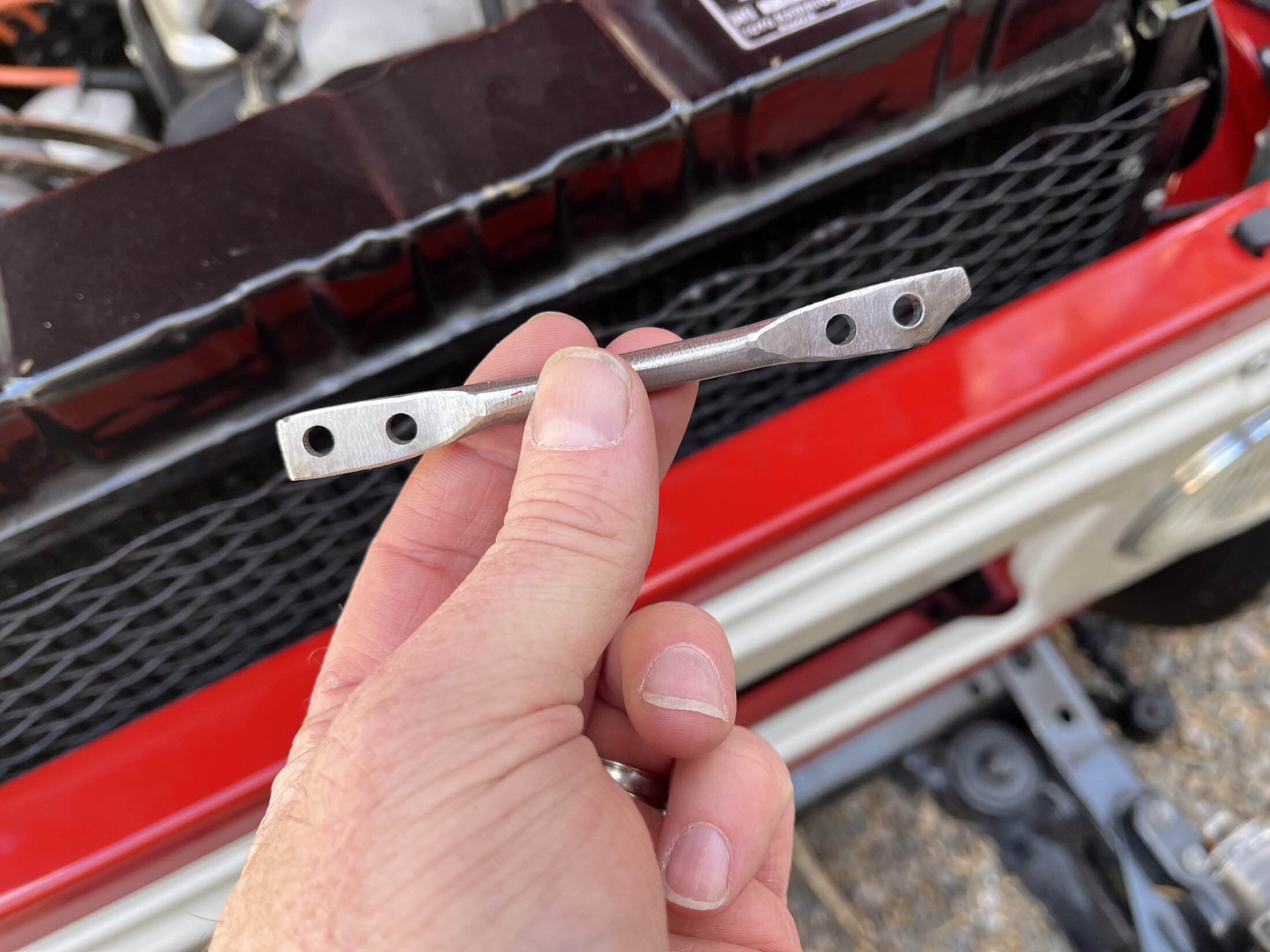

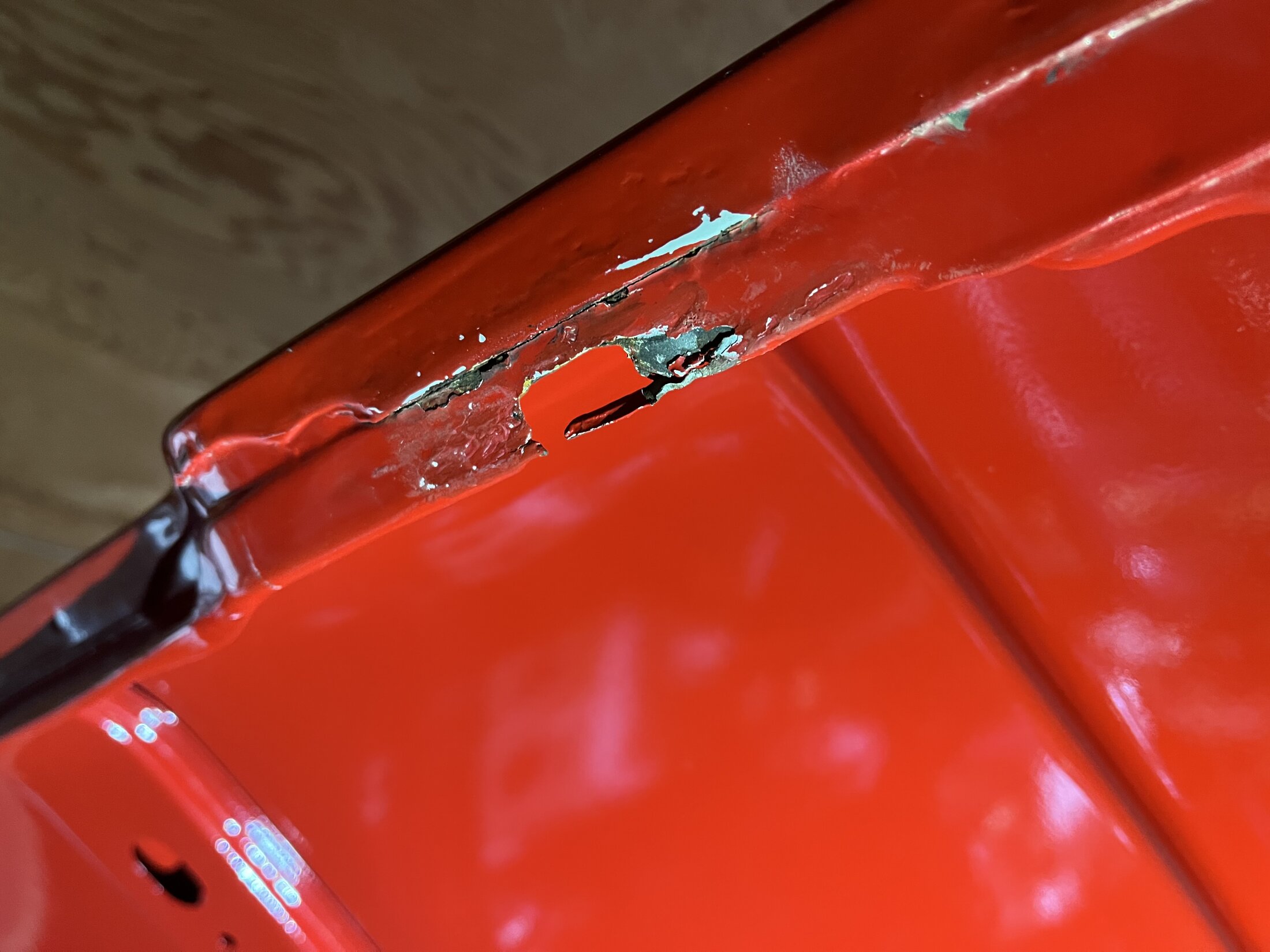

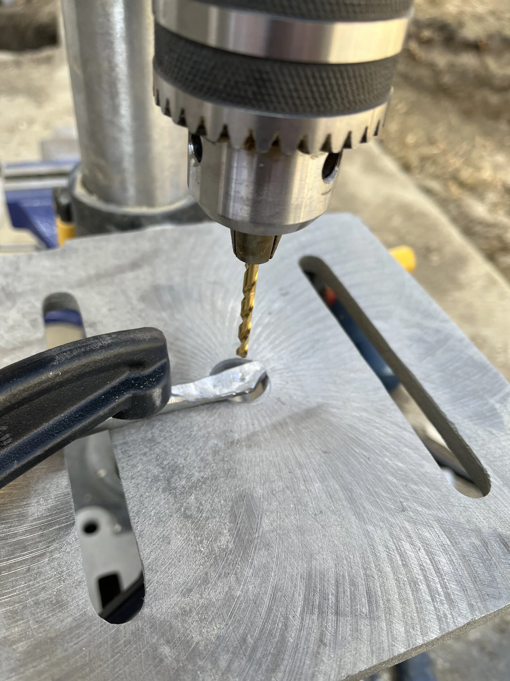

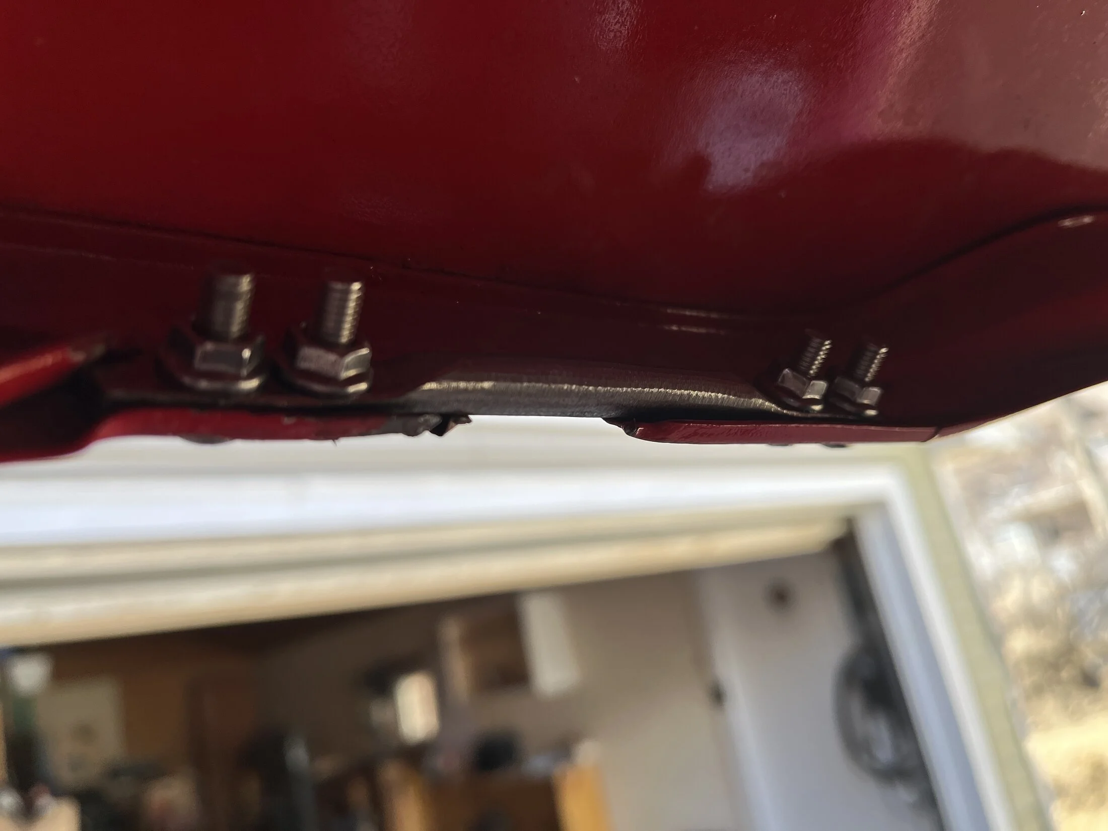

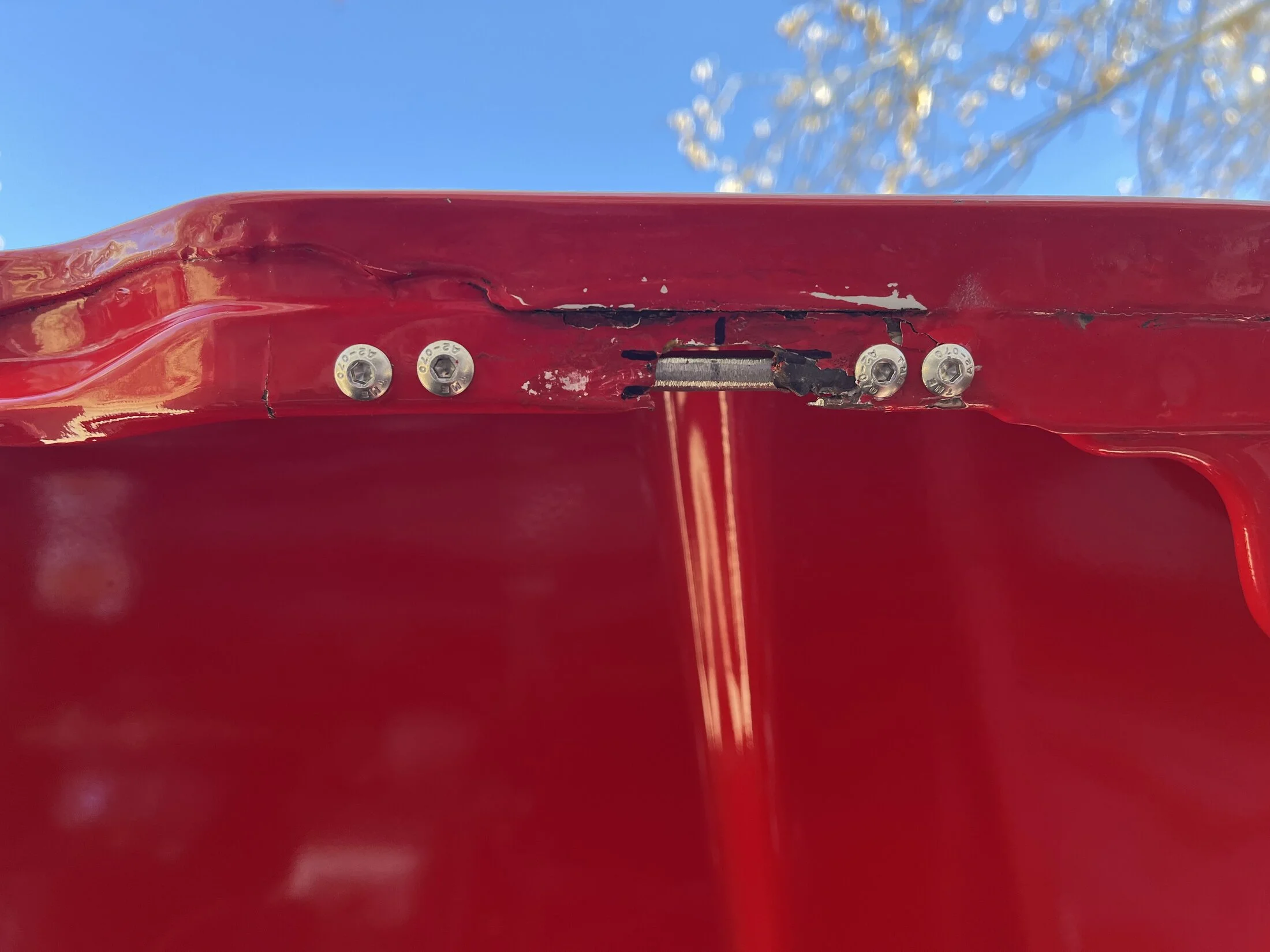

One more thing fixed… The hood release catch was pretty rusted / gone, so I made a new one out if some rebar. A bit of backyard blacksmithing (and a lot of grinding) later and I had a decent catch. A few SS M5 screws / nuts later and it worka great. Redneck engineering to be sure, and hopefully soon I can get it properly welded with a new strip of sheet steel to reinforce the rusted part.
Now I don't feel like the hood will say hi to the windshield!

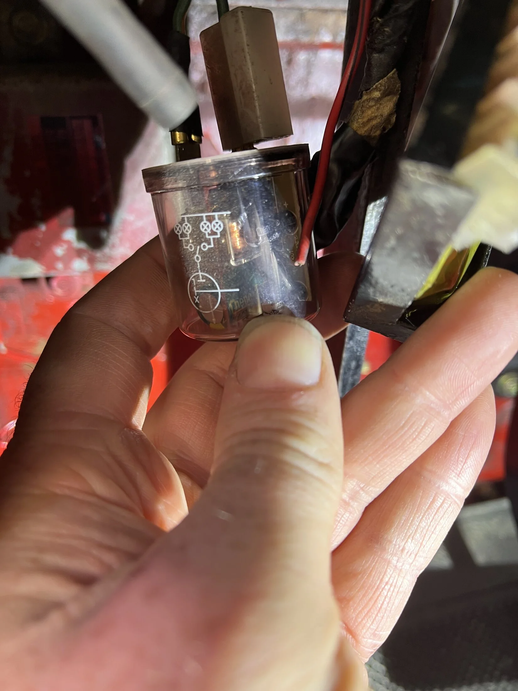

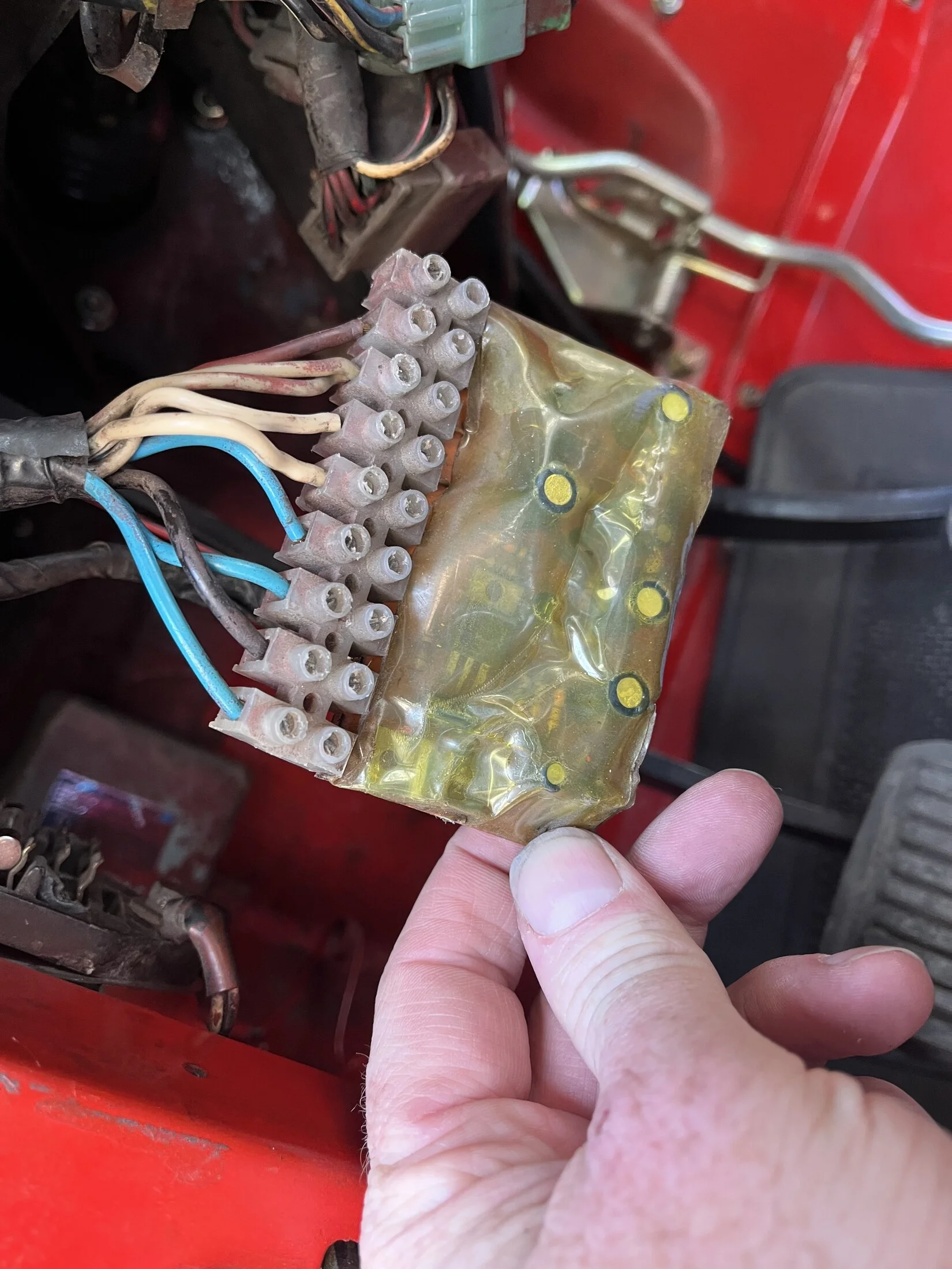

Took the car out to a friends house last night, had to leave it there as the headlights died. T-shooting today after I retrieved the car. It looks like the headlights are wired into the same circuits as the taillights, blew a fuse. While rooting around under the dash found this oddness.

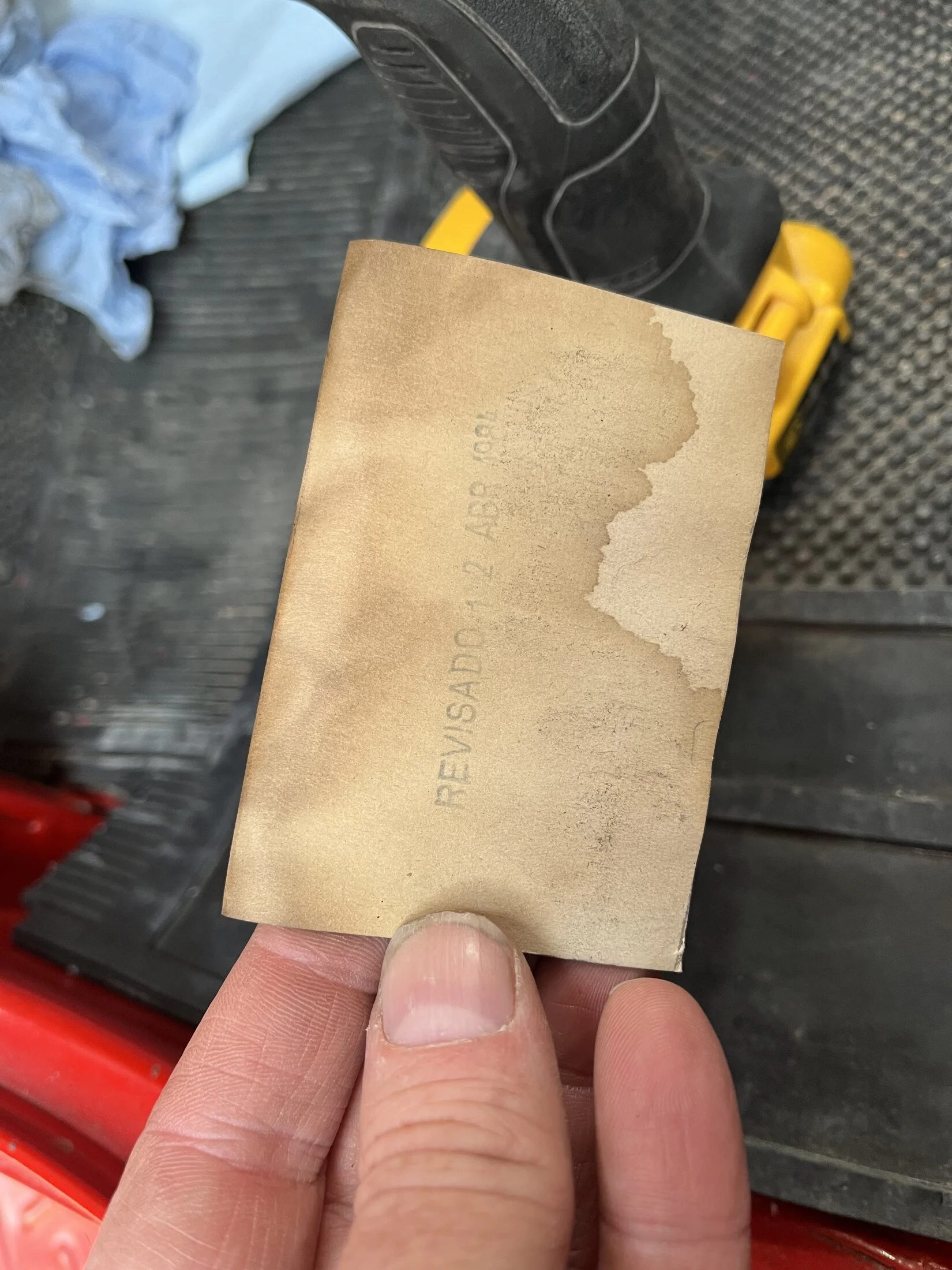

Does anyone know what these components are? They don’t seem very toyota-ish and are just danglin’. Searching for FJ40 computer / PCB didn't return anything that showed terminal blocks or this many caps. The PCB is protected by a little metal box that had that paper inside it.
EDIT: I should also note I did check the wiring diagram for a '78, but not seeing anything with those color wires referenced, nor into a common component. Scratching my head on this one.
The last photo looks like your directional flasher…not stock Toyota. The others ..absolutely no idea although it looks like it is wired into quite a few wire ends. Do you have a multi-meter to see if it is carrying any voltage?
Yep, 100% the flasher on the last pic, turned the hazards on and could feel it doin its thing. Checked every contact on that terminal block against ground, no voltage. Im guessing whatever it was connected to is long gone… Ill start tracing wires when I get daylight. How strange
