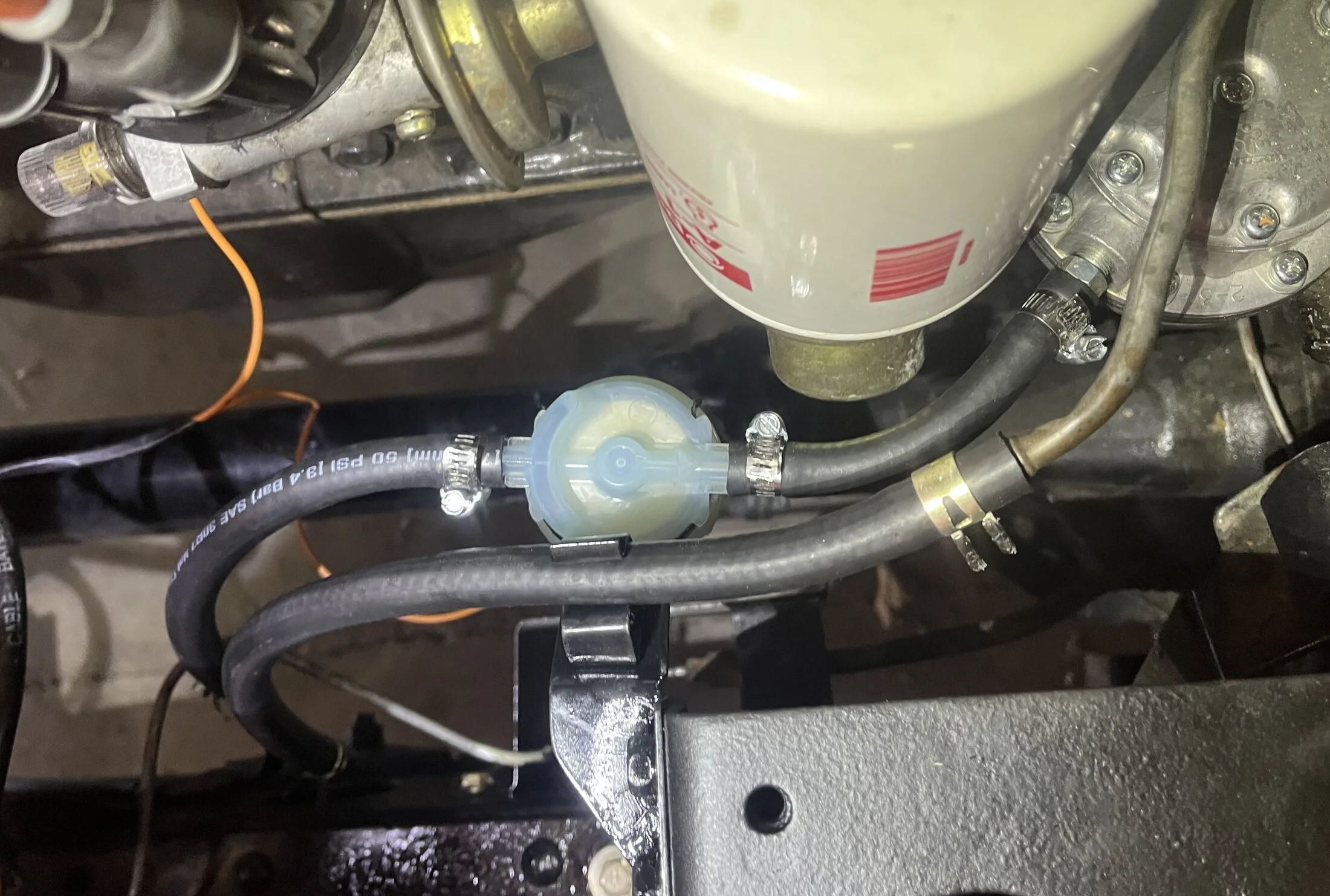

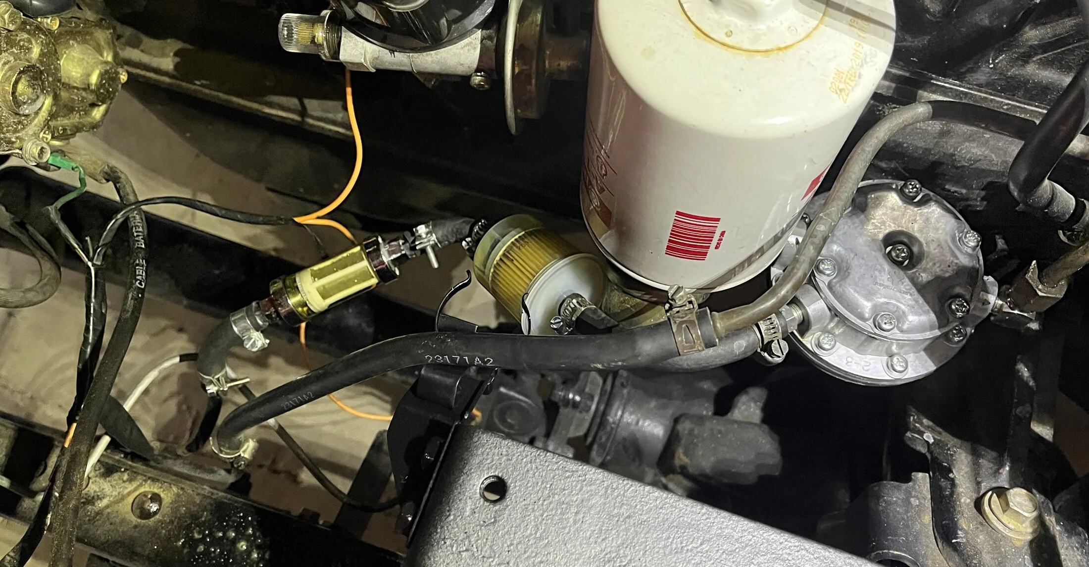

  • They said it was one of the dirtiest carbs they've ever seen. Upon further inspection, I have some crud/rust floating around in the gas tank and the inline glass filter I had wasn't fine enough to stop it all from getting to the carb

Truck is running super smooth since the carb rebuild, although I have been religious about cleaning out that glass filter. I don't need the choke to keep her idling and idle RPM is around 690ish. Was feeling confident about emissions, but failed again (high HC/CO) :frown:. From what I'm seeing, I should try leaning it out and retarding the timing... That will be this afternoon to play around with. A few notes for those in Colorado (at least up in Boulder county where I am), there is no visual inspection of equipment at this point. Have passed "visual" all three times. The shop owner told me they really just focus on what's coming out of the tailpipe. So I'm going to keep at it and not worry about a cat/re-smogging it.

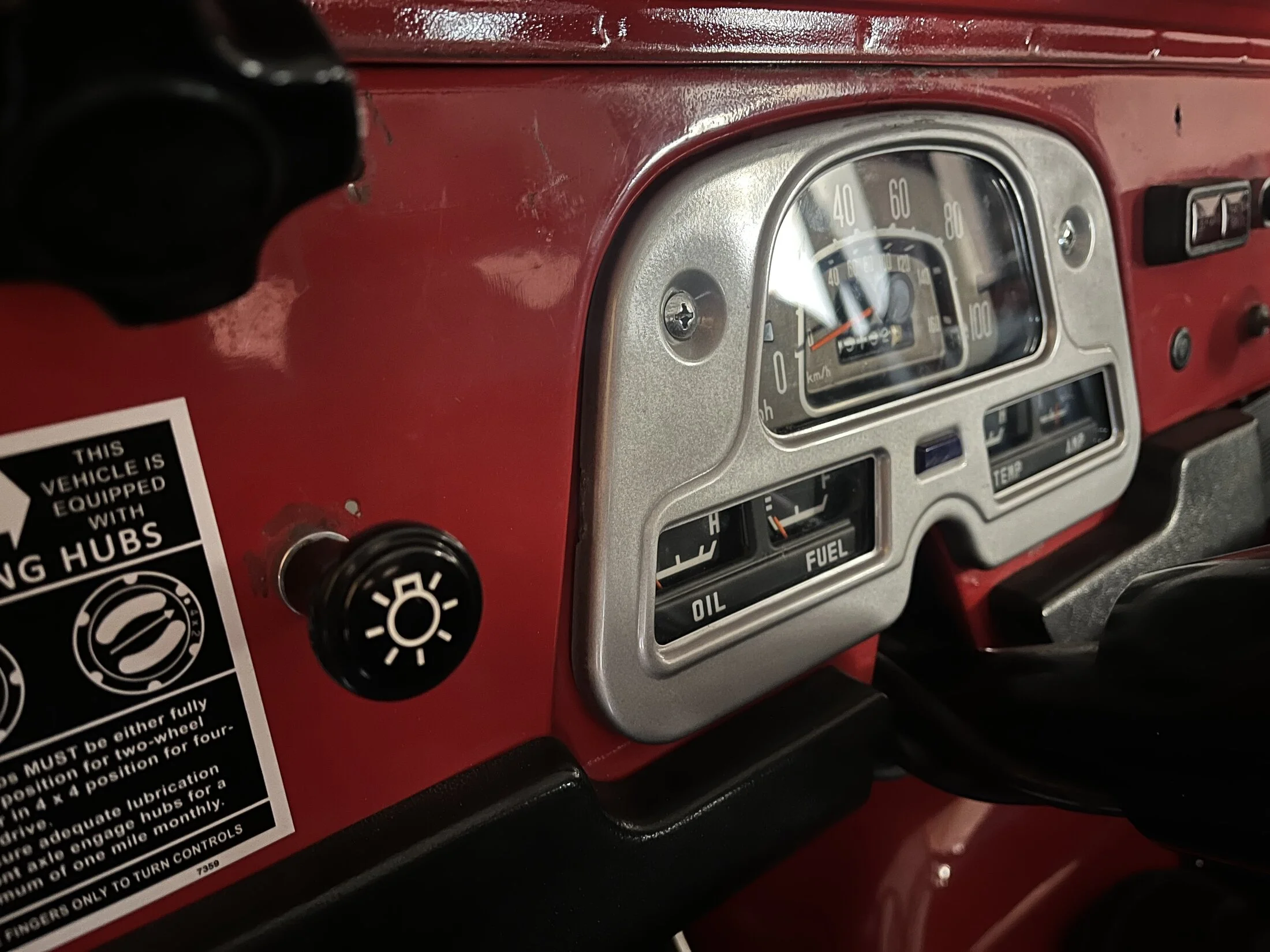

  • Replaced headlight switch with the proper part # (previous one was from an older '40 that had headlights/corner lights on same circuit, and the knob was broken as well). Lights / corner lights all work, no blown fuses.
  • Adjusted headlight aim (was a bit catywompus)
  • Fixed the oil pressure gauge: Found a loose wire in the engine bay, traced it out, and sure enough that was it.

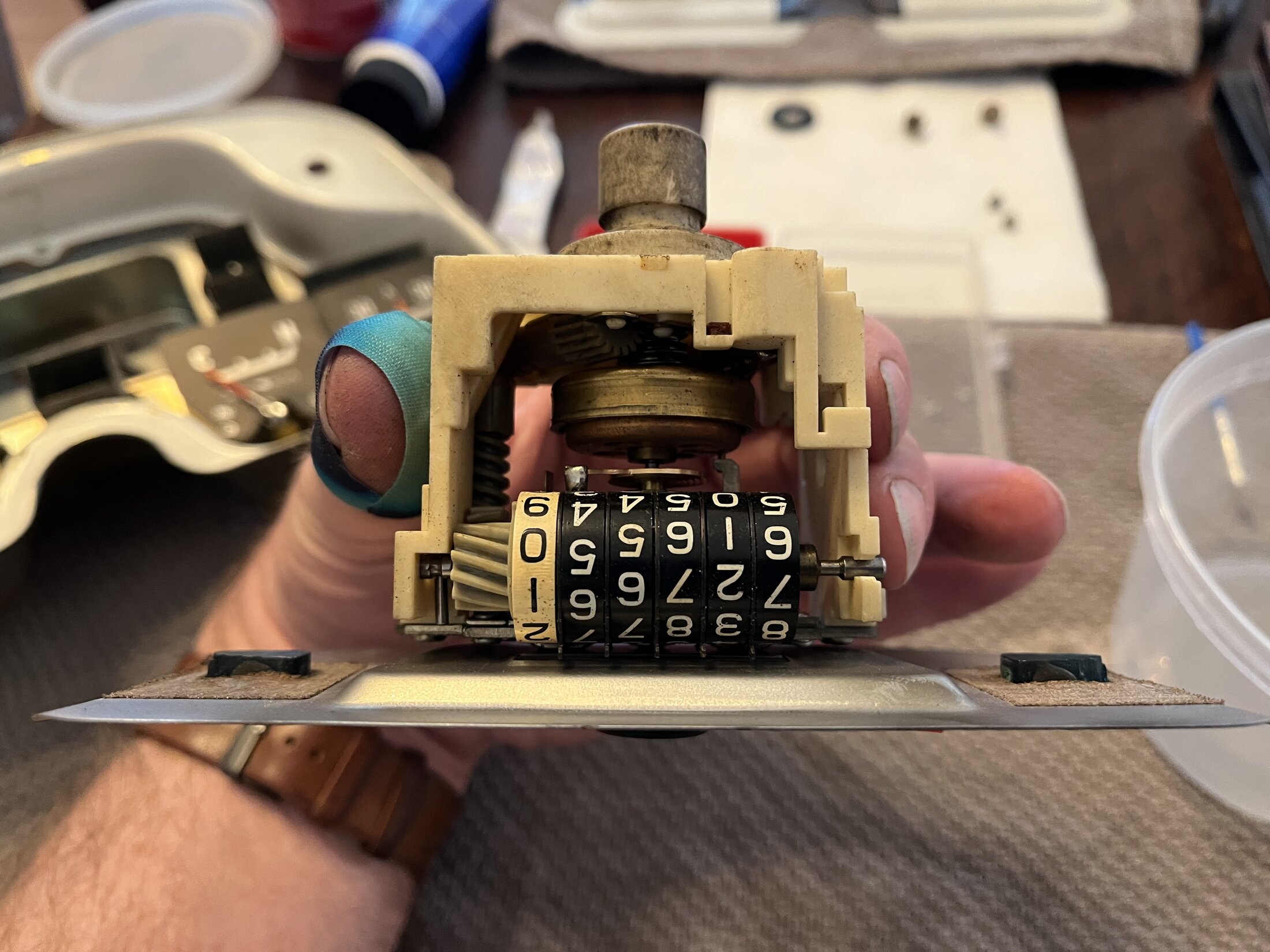

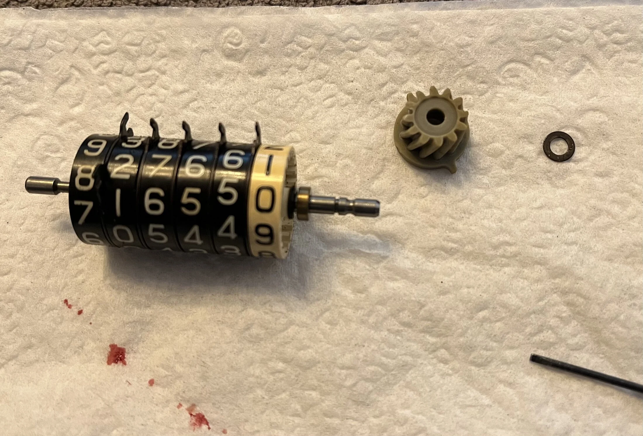

  • Fixed the odometer. I was intimidated by this one, but ih8mud to the rescue. Spent a good amount of time reading through this thread and it worked a charm. The number dials were so stuck on there it was a bear to get em loose, but persistence paid off. Works great now that they are cleaned / re-greased.
  • Cleaned all electrical contacts in the gauge cluster (the round plug) and added dielectric grease. No longer getting flickering / inconsistent gauge issues. All the foam inside the cluster had also disintegrated with age, so I replaced that with thick felt attached with 3M super 90. We'll see how it holds up.
  • Swapped the bulbs in the cluster w/ the high-output ones from CCOT. I can see in the neighborhood now, although I think stock bulbs might be fine as long as you deleted the light baffles inside the cluster. Time will tell on those.

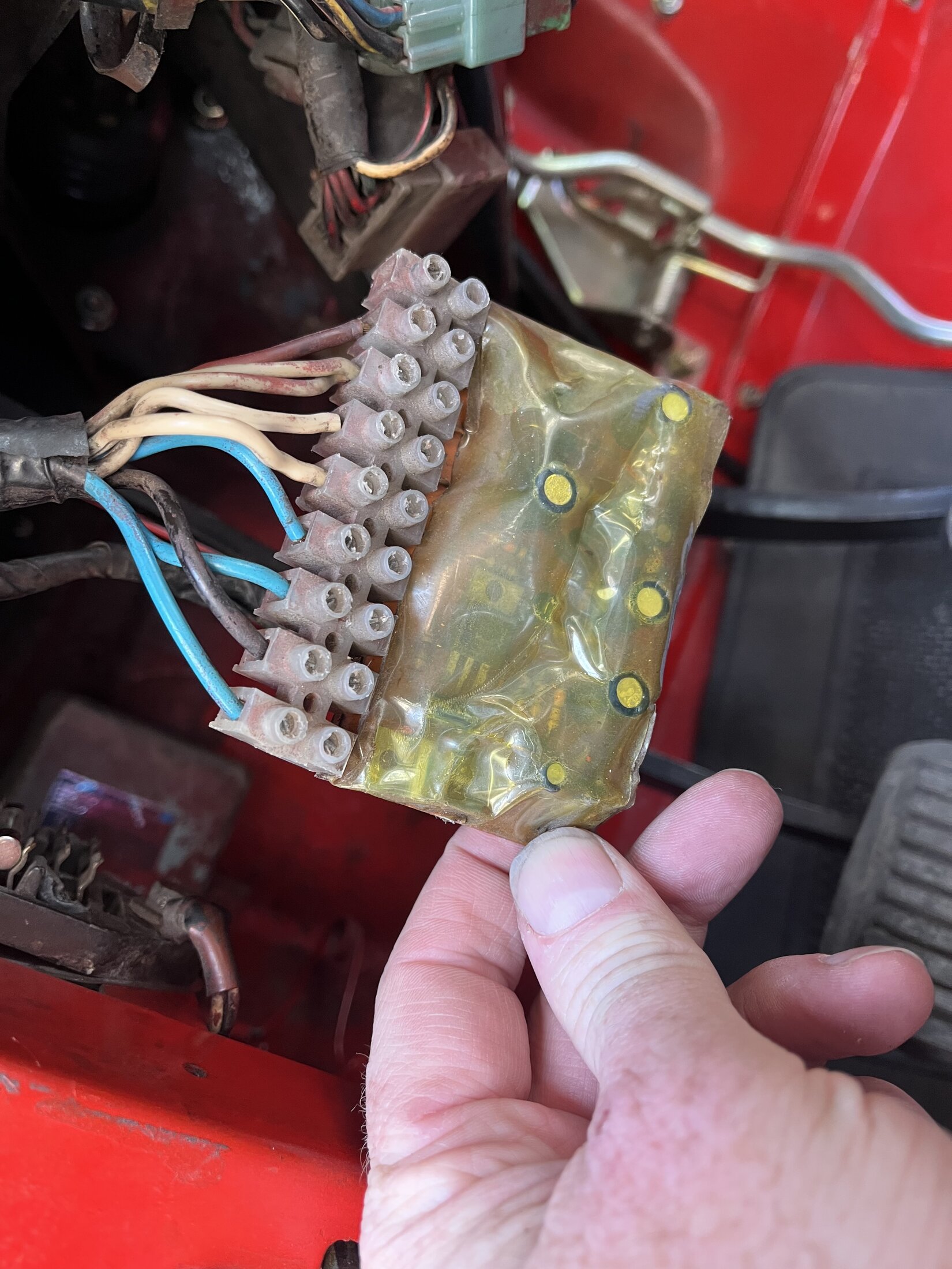

  • Got rid of the mystery circuit board/wiring. The only thing it was actually connected to was a small pressure switch screwed into the dashboard framing and the power cable that would normally be used for the dome light (which is missing). I think it was likely a radio or something, but who knows. 🤷‍♂️

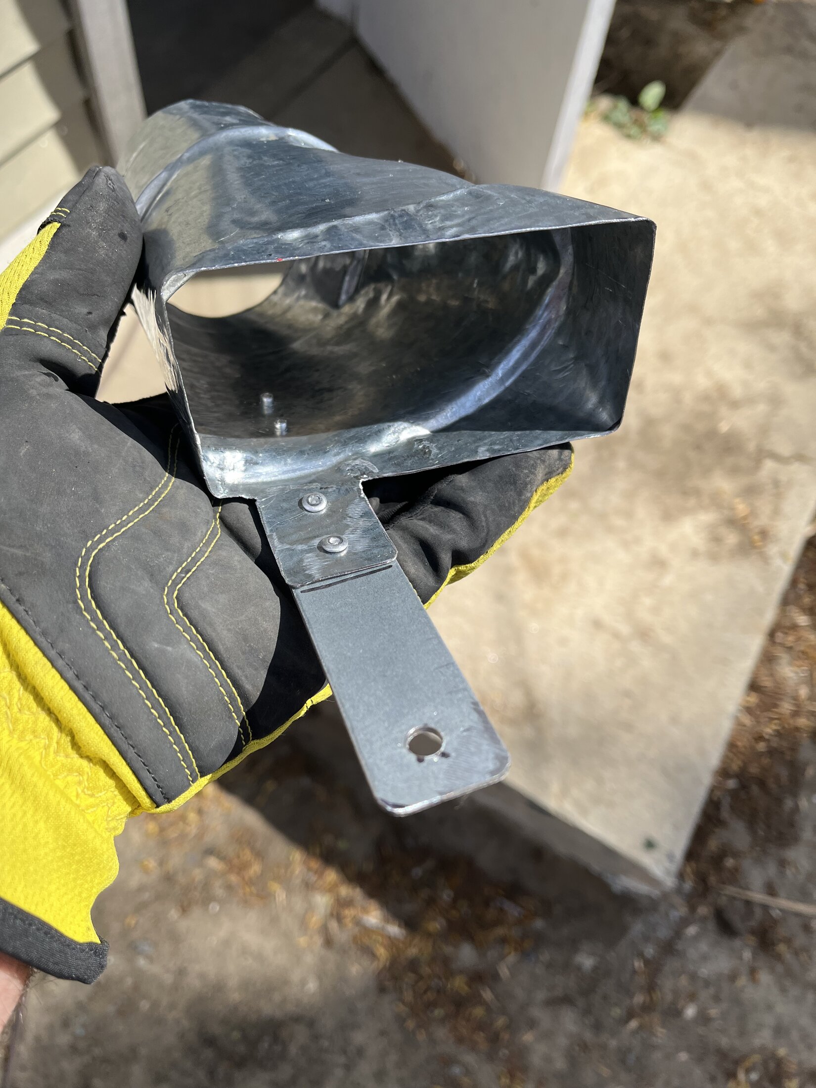

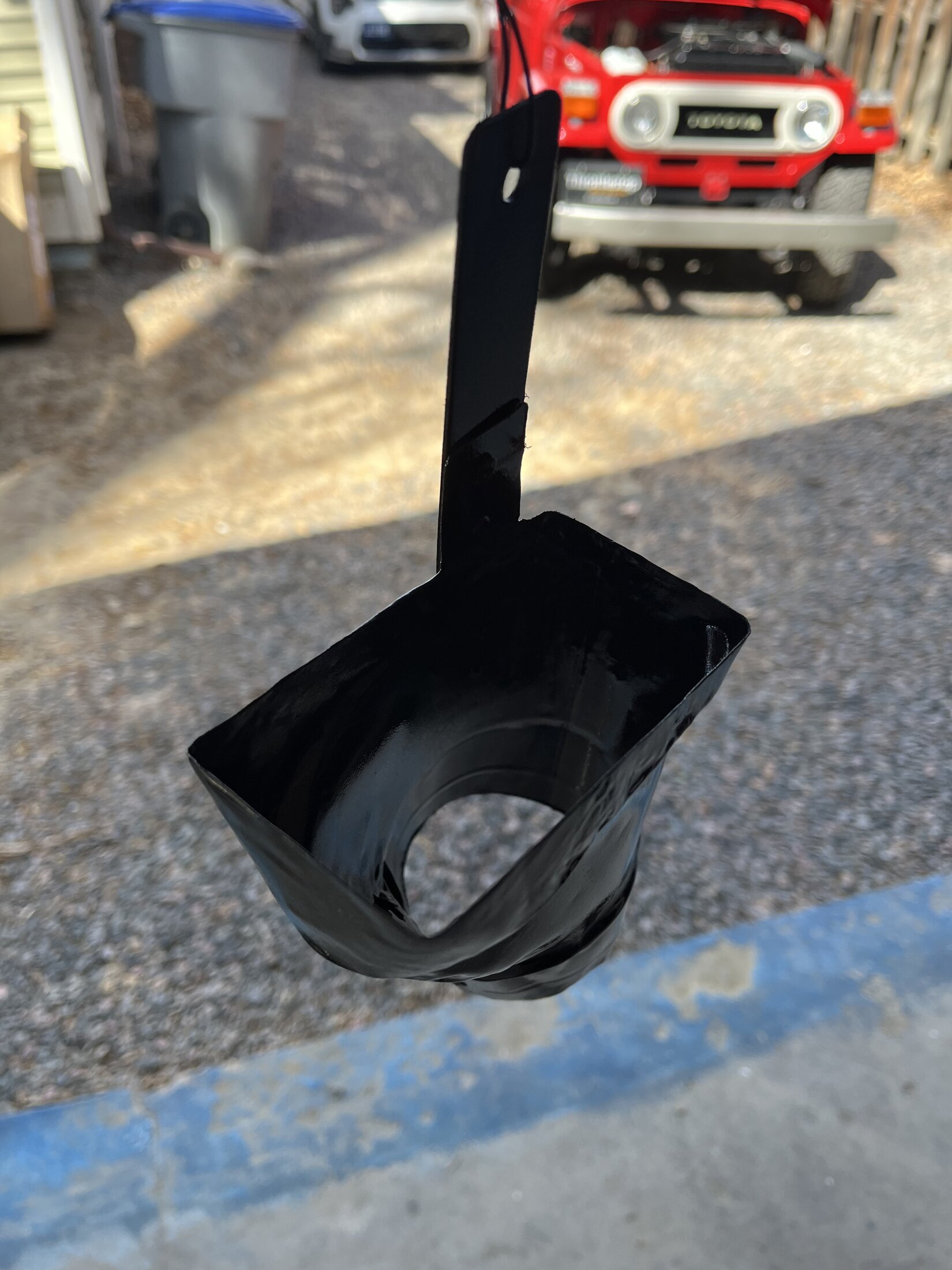

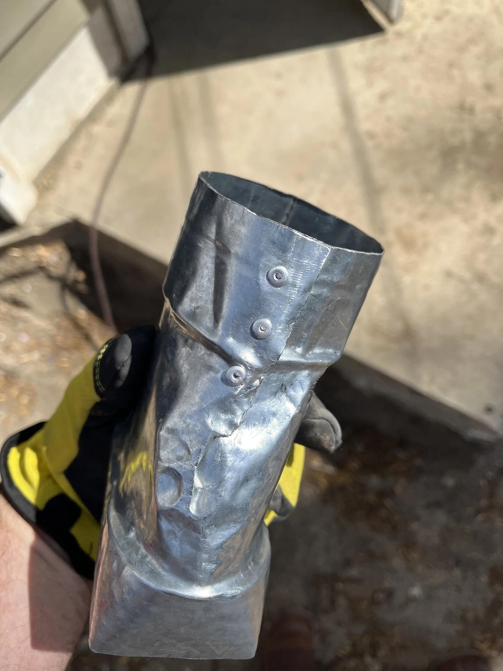

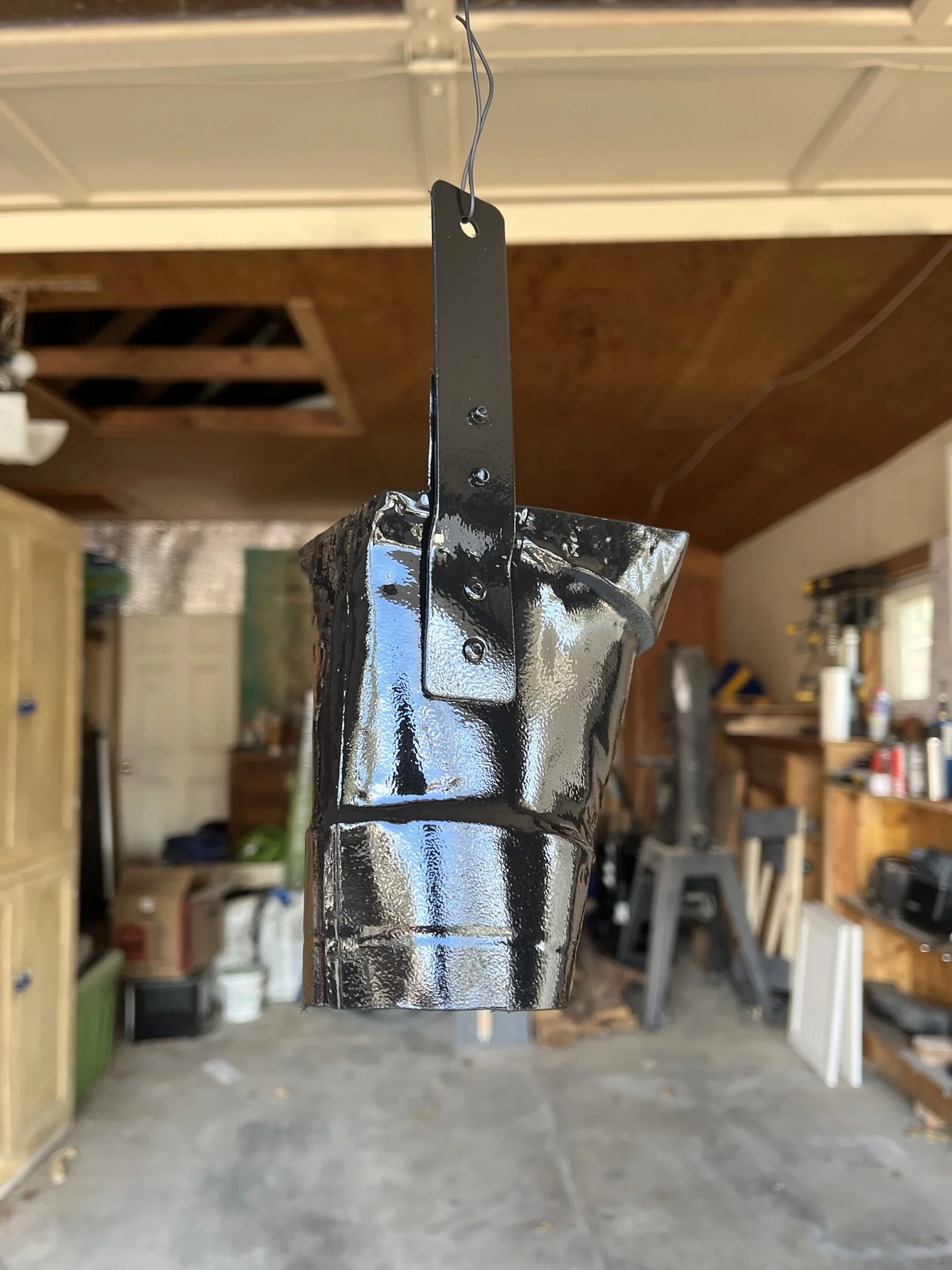

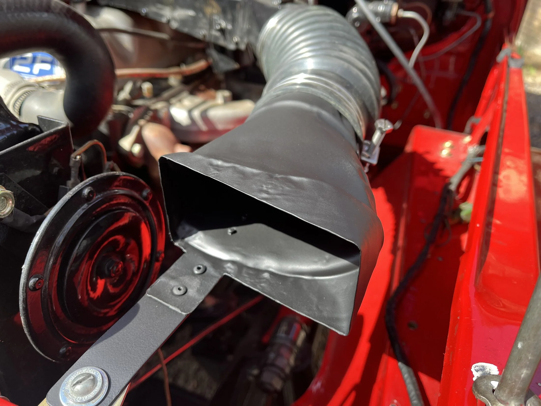

Some more wrenching today. Purists, avert your gaze... I bought a 3"-4" steel HVAC adapter from Home Depot, a rivet gun / rivets. Total in for around $50 and I get a new tool out of the deal.
Spent some time with hammers, pliers, tin snips, an angle grinder and some spray paint. The steel bar / hardware I found from scrap laying around the garage. It ain't pretty, but until I can justify the real deal, it'll do for now.
