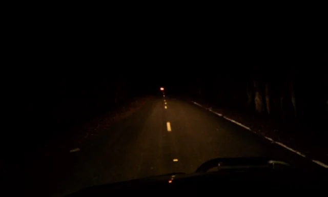

Low, High, HIGH PLUS LED. Here is on the road but my cellphone is not sensitive to pick up the light as it looks with naked eye...but you can get the idea:
Low, High, LED (by naked eye the LED also illuminates the trees on side and canopy above road. I might have to try long exposure on regular camera and replace these...but you can see the difference relative to eachother if nothing else. :D:D
Looks amazing Brock. You put the flood version on the roof. I still think you should be one on the rear of the truck.
Nothing on roof....will just keep the spot on center hoop as it actually spreads out as much as any flood pattern Halogen I have had before.....I am very pleased.

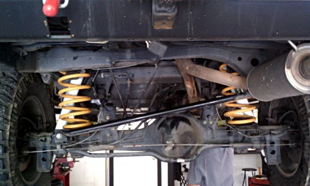

6. Now you have rear springs and rear shocks off. Next get hacksaw or cutting wheel and cut the steel mounts from top of shock off from hydraulic hose. The hose is steel braided inside so it is a tough nut to crack and not a lot of room. 30 minutes with hacksaw or 30 seconds with cut off wheel...your choice. Once again have drain pan handy and wear eye protection during this removal....

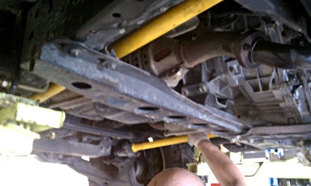

7. While I was doing this, he was removing front torsion bars and placing new TB...the IronMan setup also includes a support reinforcement bracket...that requires drilling and using two bolts on each for strength. Read instructions and do one hole at time before moving to drilling second hole as the bracket flexes when tightened down. Also, the TB are not indexed from IronMan so layed them with arrows up that were stuck....pinged them with punch to line up a line with original models and then counted over I think 5 teeth to index the offset mark as well...marked with chalk for installing properly.
8. Now I put the new springs on each side...did passenger side first....was able to push up on the much thicker and stiffer springs to pop into place on doughnut. Rotated to get end of spring about 1/4 inch from stop on lower mount. Did drivers side same way but a bit tougher so pryed up on bottom spring coil with pry bar to get on edge of mount and pushed into place. Aligned bottom end of coil..done.
9. Got shocks...ones ending in 6 go in rear...will be evident when you compare them. Setup washers with large washer on top bolt first...concave up to hold rubber spacer...then next with concave down over rubber spacer and ridged inner circle up....this part sits in frame mount hole and helps align sock in hole. Stick up through hole...put another set of washers and stops on top in reverse order then finger start top nut. May spin top of shock to get it snug and then get wrench to tighten by hand as much as you can until it wont budge. Then put lower bushings in shock mount, rotate into place and add bolt. I found it easier to put first cone spacer on shock mount on axle....the rotate and push empty lower shock hole onto it...then add external spacer...then bolt finger tight. Then did opposite side the same. Tightened lower bolts and double checked tops again....double checked springs were seated properly and aligned evenly. Done.

12. At this time the shocks are installed in all four corners. The coil springs are installed in rear. The TB are in place with extra brackets but are just bottomed to mounts not torqued...so are as soft as they can be now...just in place. All four globes with actuators...all height sensors have been removed. he is now removing more line that is hard line...trying to keep it from rattling. We have cut the steel top mount for hydraulic shocks on all four corners and pulled as much of the thick hard lines from within frame and around fuel tanks as we can find. Bend it, twist it, cut it to get it out or will rattle like hell.
13. Now we lowered vehicle to see how it sits...rear was way up...front was way down...about 5 inches of difference as the front was just SHOCK...no TB really as they were all the way loose. We put skid plate back on front already and checked that shocks and springs were in place properly and started setting them up. Using lift and large ratchet bar....went up and down about 15 times adjusting. Ended up with rear at 32.75 inches from bottom of wheel (allow wheel) straight up to lower portion of fender. Ended up with 32 on front with both sides being level with same reference point. In between each lowering of vehicle to floor...we would bounce it to help settle torsion bars. It started easy like a bouncy board and at end was firm. After driving a couple weeks I think the springs and such will settle more and will measure again and adjust as necessary....but did not want to twist up the TB too much...so I tried to get them within 1/2-3/4 of an inch from front....taking into account I was almost empty of fuel....no gear in rear, etc...that will help level it some as well.

Picture of rear setup and front setup installed....
as you can see the IRONMAN bars and springs are bright yellow and shocks are white with IRONMAN logo on upper shroud.

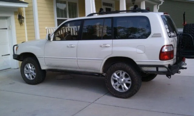

Picture is with IRONMAN OFFROAD SUSPENSION... It is almost 2 inches right now but after settling I bet it is right on the 1.5" they claim. I was not looking for more height really but rather suspension that works good with the extra weight I am putting on her...more preventive maintenance so I dont have to worry about it failing in middle of nowhere....very happy with change.

I thought the LX looked great. Did you do a diff drop?
Here are some pics I took today next to my 100.
No diff drop...Ironman Suspension and Camel said not required for this lift due to limited change in height....I will watch the CV boots for any signs of leakage and decide later.
