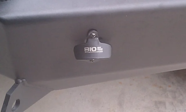

The most important trail gear.....beer opener on front bumper!

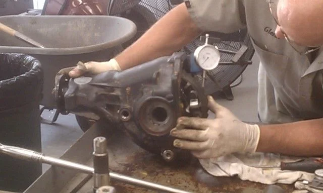

Bad ring gear with three teeth damaged...pinion gear had one tooth damaged...and carrier had gouge where one tooth got wedged between it and the case. :(
New 4.88 with diff drop started....took quite a few tries to get the settings right...do one thing and there is another reaction somewhere else...must have had that thing apart 8 times trying different shims and such. Then air compressor motor went out.....so while he continued to set it up I went and picked up another air compressor (80 gallon tank) and helped remove the cheap one that finally gave out.
When I left we had front done and installed....diff drop installed...everything buttoned back up except right side as it appears when the Toyota shop in Durham did my CV Axle last month they damaged a seal.....so got to put a new seal in it as it was letting water in we noticed when it was taken apart. Just another thing I guess....
rear is out...completely disassembled, cleaned, etc. Monday can start with setting it up again and hopefully be done Monday night short of waiting on a new seal to button it all up again. What a job!!! I am so thankful to have someone that knows what the hell they are doing....cuz I sure dont. LOL
Got her finished and tested...if not for tires would be whisper quiet. Now to check speedo with new gears...and an easy break in for 500 miles.

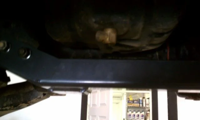

Here is diff drop before put skids back and you can see the fancy oil drain ball valve.
