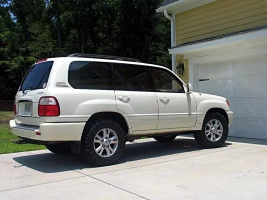

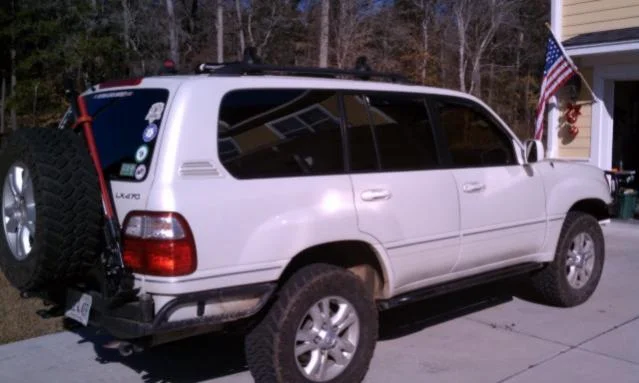

Before Picture....you can see trees, building, etc through to opposite side of vehicle if you look closely. no, it is not the plastic bumpers that make it lighter :)
After Picture.....not exact same angle but is in full sun and pretty much evenly blocks especially for front windows. I will set up the exact same shot and take it with my good camera instead of cell phone for better comparison later.
In the one you can see how the front tint really has little to no impact on being able to see corner of house and even the color of green leaves in tree on lot next to me. In the after picture you can tell a definite visual difference on the trees on same woodline...nearly cant see them at all even though the bare trunks are lighter even.
