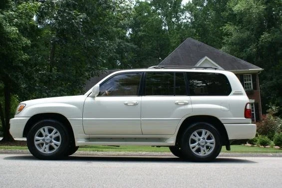

I will get some today when I am changing my oil...and will try to find an older pic of BEFORE to compare.

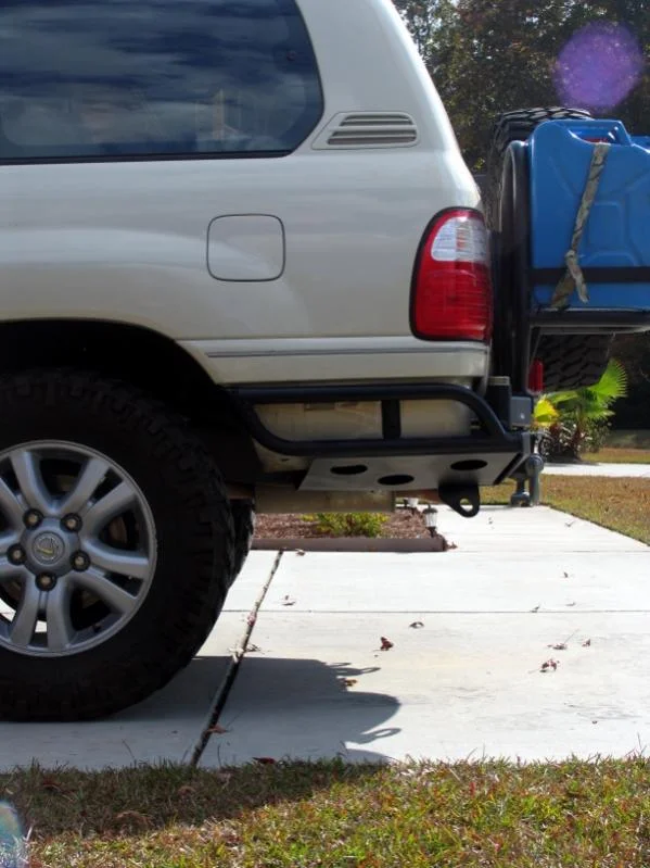

Here are two similar pictures though not exactly same...to get idea of difference. My rear tail pipe is lowest thing back there now. Think I need to get some new pipe bent to take it up where spare tire used to be and then maybe out in between tire and quarter panel skid from bumper. :D
Pretty much in oem form the bottom edge of bumper at HIGH AHC setting with my tires was at center of hub....without the bottom edge of bumper skid is level with bottom of V shape in tire spokes. If I took off the driver side tow eye it would be higher. Same for passenger where the tow hook is there to protect the muffler which is now BELOW the bottom edge of bumper whereas before it was up above lower edge of bumper...with tire being lowest point underneath.
And NO, I did not clean the rear quarter lowers before mounting bumper....and now I see all the scum in there.:bang:
