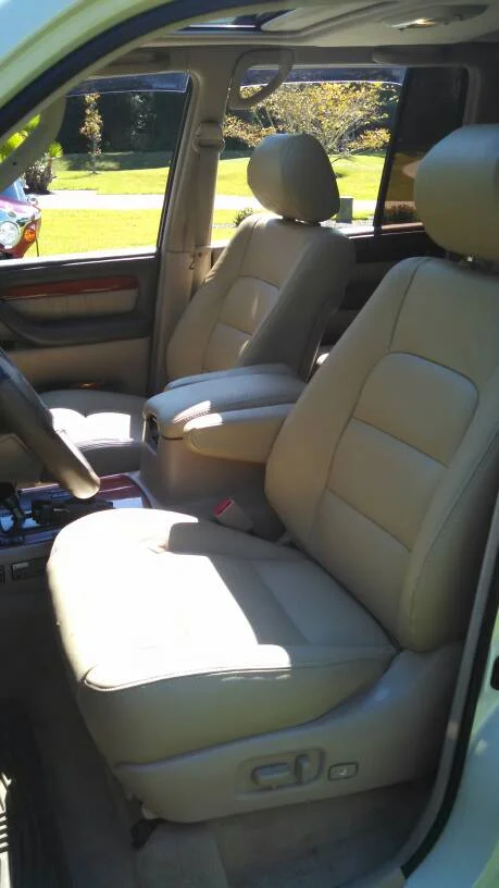

New seat covers. Not as nice as MetricTLC but didnt want to wait another month or two...so ordered from Leatherseats.com Not perfect match but well made and fitment is good. I got two front seats including console...headrests and armrests included. Now for drivers door handle and steering wheel.
View attachment 952101 New seat covers. Not as nice as MetricTLC but didnt want to wait another month or two...so ordered from Leatherseats.com Not perfect match but well made and fitment is good. I got two front seats including console...headrests and armrests included. Now for drivers door handle and steering wheel.
Great build thread, how much were the front seats?
$729 for the premium kit including shipping (both seats, headrests, console cover, armrests)...it is not the smooth leather like from Lexus and has a grain pattern on it...but I tried to get with MetricTLC but got tired of waiting. I did get hold of him a couple weeks before I got them installed but by then I already had the new seat covers and scheduled appointment. So figured since it was my offroad vehicle and not some prime stock all original Lexus I would not worry. Might do back seat this year to make it all match....and be done with it. :)

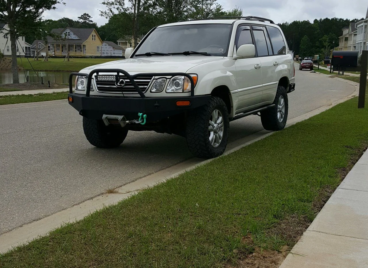

Here she is right before pulling off for Durham NC tonight in the rain.

Here she is right before pulling off for Durham NC tonight in the rain.View attachment 1252170
Thanks man I truly appreciate it! And ya got just a "tad" lost. But we made it xD hope to see you soon!!
