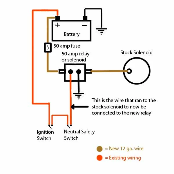

There have been some problems with the stock ignition start circuit as cruisers age. Personally, I think some of these problems come from the troubles with the stock solenoid going bad. Starter solenoids usually have two windings (coils) in them. This is to provide the extra power while pulling in the plunger to drive the bendix out to engage the flexplate (flywheel). In a properly operating system the solenoid can see 40-50 amps until the starter starts to spin, then the amps will drop to 10 or so until the motor starts. I think what happens when the solenoids are going bad is people are holding the key on to the start position for extended periods to try to get the motor started. This then allows 40-50 amps to flow through the ignition start switch, neutral safety switch, connectors, etc. for extended periods putting a burden on these parts. In the drawing is a simple solution that can take the burden off the ignition circuit allowing even a defective circuit to flow enough amps to start the cruiser. All it requires is a 50 amp fuse. A 50 amp relay, and a piece of 12 gauge wire. Run a wire from the positive battery post through a fuse to one big lug on the new relay, the other big lug down to the starter solenoid, connecting on where the stock solenoid wire now connects. Then take the stock solenoid wire and run it to one coil post on the new relay, the other coil post going to ground. This way all the ignition circuit has to pass is just a very small amount of amps to pull in the coil of the new relay.
The con with this idea is it adds another component that can fail. If it would fail all that would have to be done is to switch the stock solenoid wire from the relay coil post back to the starter solenoid and the system would be back to stock. An external solenoid can be substituted for the relay I mentioned.

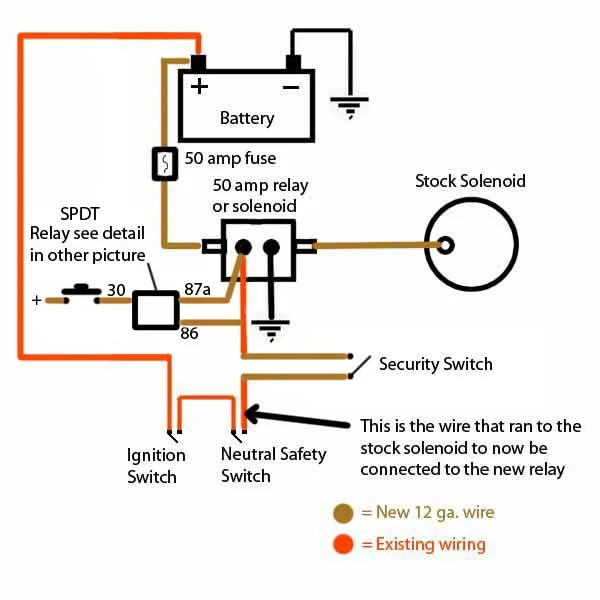

You know it has further occurred to me that this new circuit would be a good spot to install a starter disabling switch or some such for security. An ST 80 solenoid only draws a small amount of ohms to operate (16-21). Since the stock starter circuit now only has to pass roughly ½ amp to start the cruiser, adding a hidden switch in the circuit with additional wiring would not be that much of a burden. Just a thought.

Bill, do up a schematic and I will try it out. I've been talking to the 12 volt guy about his kill switch: 12VoltGuy.com: Theft Switch
I was just going to wire this in between one of the lugs on the solenoid for your set up. But if this thing can kill two birds or if there is a way to combine them that would be most excellent:grinpimp:
I would put it on the coil side of the relay. With this new circuit this part should only see very low amps. The big wire side could still see 40-50 amps so I would not run that side through a switch. By the way, I would use a good quality switch; otherwise after a while with a cheapo, the cruiser may not want to start. One switch I had considered when doing these types of things was a simple key switch. That way even if it is found it is a little harder to defeat it as long as the switch is installed through something so the wires are protected. The old Ford 9N and 8N tractors have simple two wire ignition switches iirc so one like that would work.

Looks good. If you prefer using a larger relay or solenoid here is another way to do the original idea and it will allow bumping the engine. It would just take a small automotive relay and a momentary push button switch. Many ways to do things.

Im trying to do this mod but im trying to figure out how to wire from st80 solenoid to stock solenoid. Specifically which terminal? Im assuming the power terminal. But how do you trigger the starter itself? Did u guys use jumpers to connect the power and ignition posts?
The stock starter/solenoid has two wires going to it. A large wire from battery positive and a small wire from the ignition switch. The small wire is the one you are interested in. This wire gets cut and extended. The one end that goes to the stock solenoid goes to a large terminal on the new solenoid. A new wire is connected from the other large terminal, through a fuse to battery positive. The other end of the cut wire; the one from the ignition switch, goes to one of the small terminals on the new solenoid. The other small terminal on the new solenoid goes to ground through a new wire that is added.
In action, when the key is turned to start whatever power is available that comes through the neutral safety switch and ignition switch now goes to one small terminal on the new solenoid. This activates the coil in the new solenoid causing the contacts to close. This allows full power from the battery to flow to the stock solenoid through the large terminals on the new solenoid.
