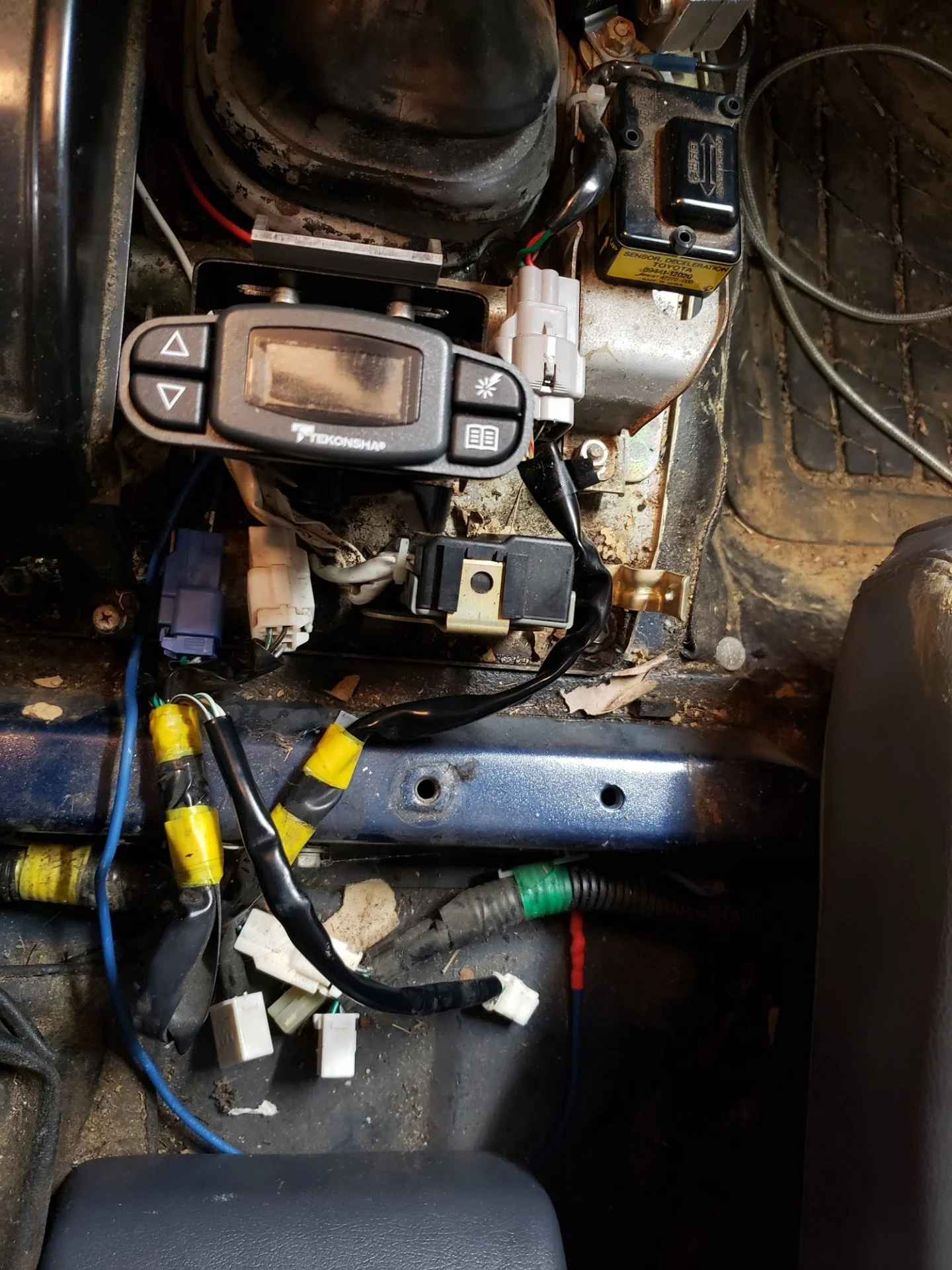

The (D) light on the gauge cluster does not light up (never has). All of the rest of the lights do. I've read some about this being controlled by the neutral safety switch.
When I was installed my brake controller, I moved around a few wires near the shifter to make room for it. There are several connectors that are not used, but did I unplug something that should be plugged in?
It's probably worth noting that I recently pulled a rat's nest of factory security system wiring out of the driver's kick panel/under the driver's seat/under the steering column. I didn't notice the shifting issues immediately after that, though. So, I don't think I left something unplugged.

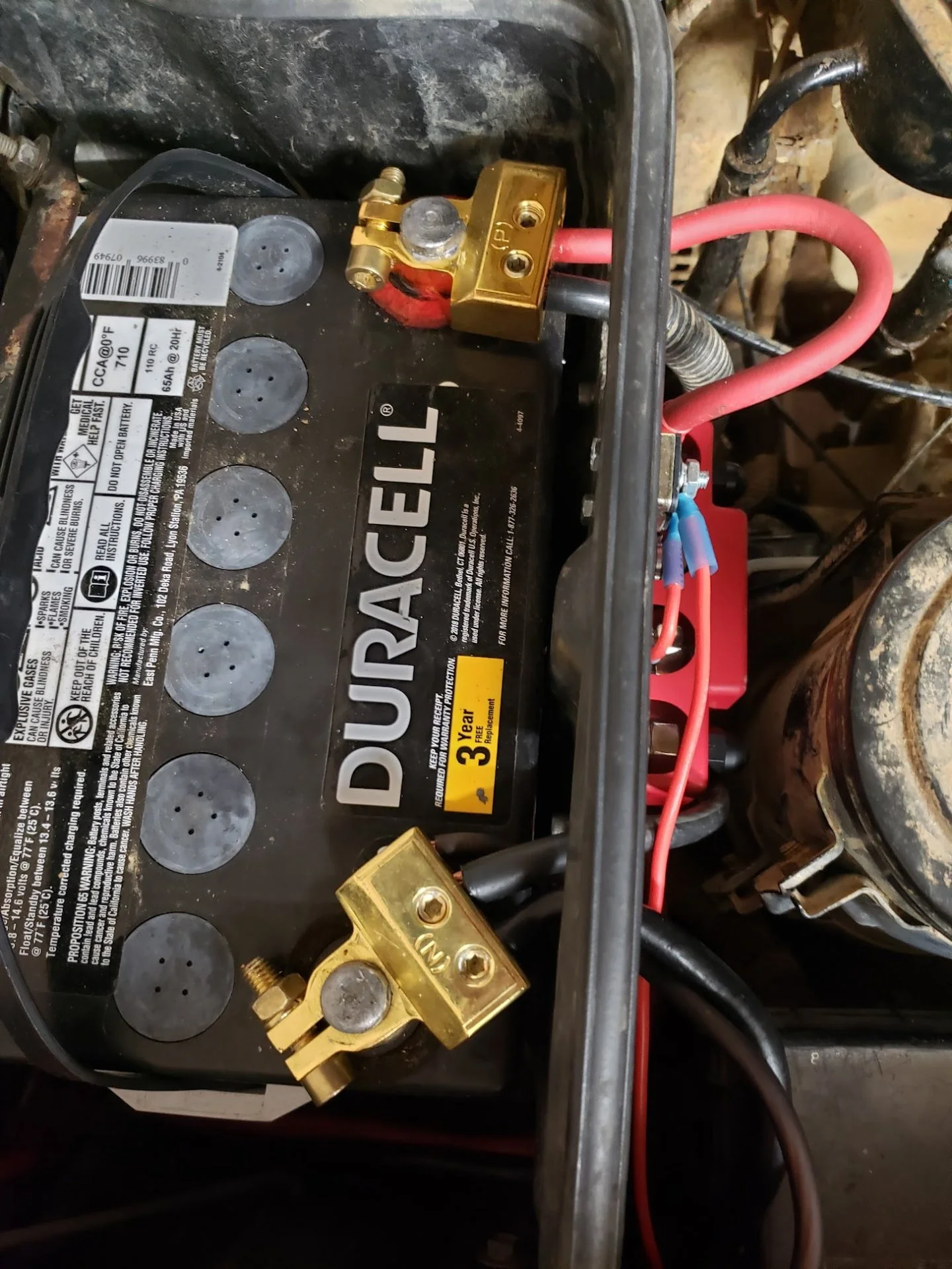

Also noteworthy, I just replaced my battery cable ends, added positive bus bar, and added a trailer brake controller. One of the fusible links broke while I was wrangling all that wiring. Replaced the fusible links w/ the factory part.

Can you pass along that thread you were speaking of? Just started having intermittent shifting problems my self. I too just did some battery alterations which is suspect. Sencondary batt, lights, new terminals, pos bus and battery isolator. My problems def feels more electrical than mechanical. Does not happen every time and each time it does its not exactly the same. Please let us know if you figure anything out.

Did you check the connections for your NSS? That caused me huge headaches and messed with my transmission behavior.
