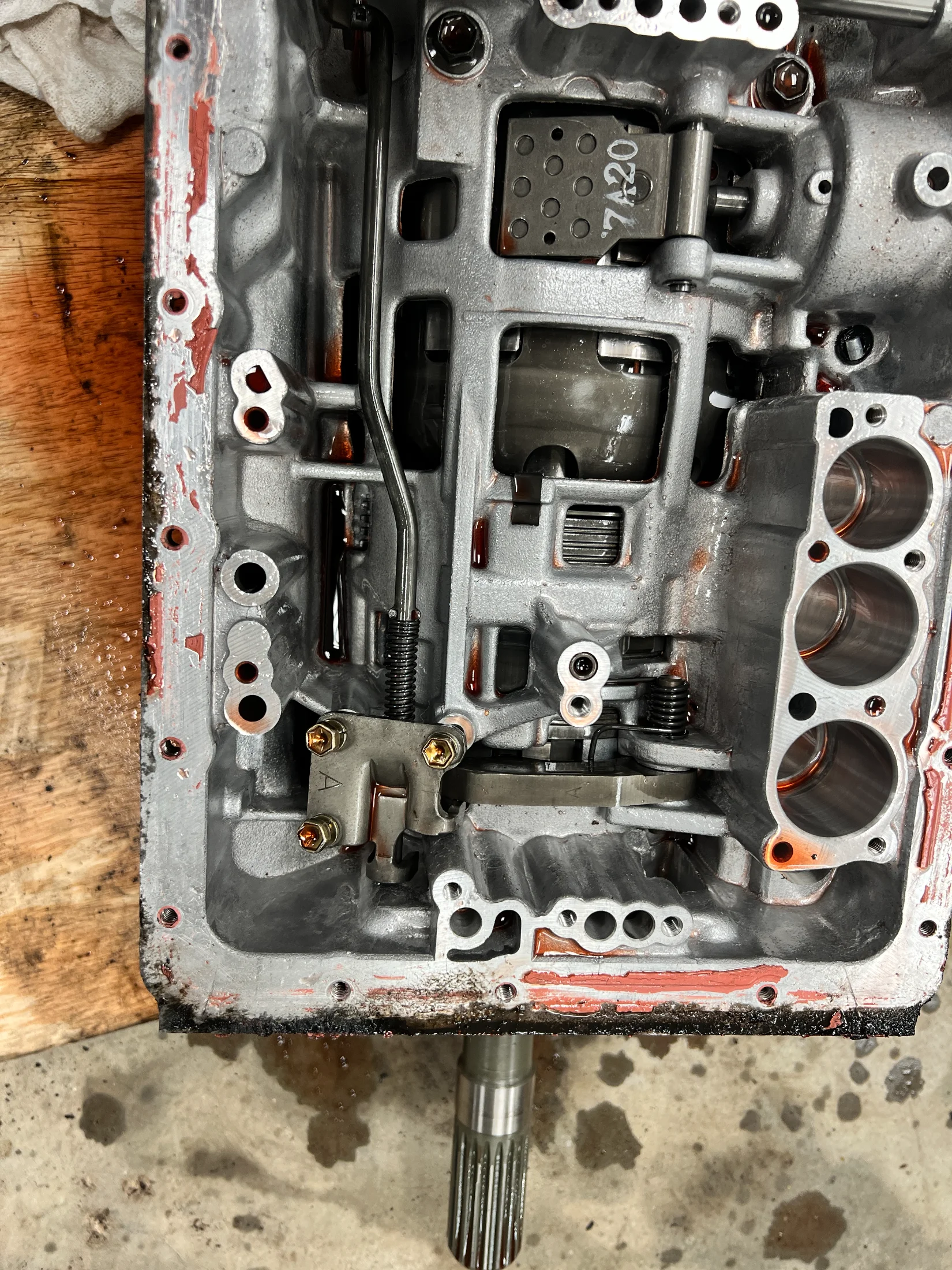

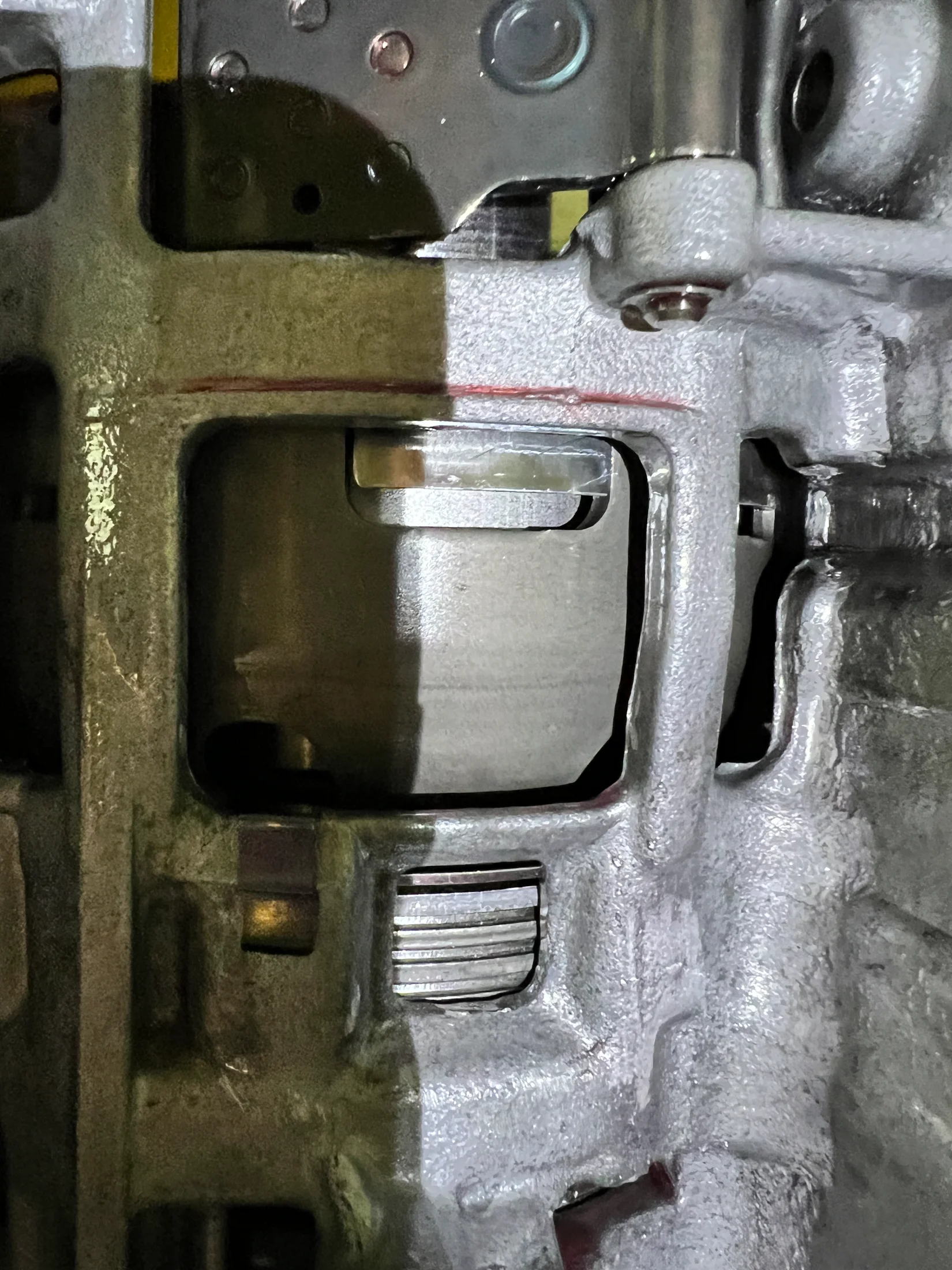

Here is the question. I also attached two photos.

There is another clearance measurement requirement between the sun gear input drum and the direct clutch drum. The FSM says this distance should be between 0.209" to 0.287". It also says to use a vernier caliper for the measurement, but I found that not a workable option, so I use a stack of various thickness feeler gauges, which ought to be at least as good as using a vernier. It is a simple measurement, and mine comes in at 0.190". I have taken this thing apart maybe 10 times now. I can now do it in my dreams, but no matter what I do, what I check, or what I measure, it always comes out at 0.190". When I did the original disassembly, I took a photo of this area as part of my documentation. I have attached this photo below along with the same area today. I am not seeing an additional 0.019"+ in that original photo. Has anyone else made this measurement and found it within the FSM specs?

See Step 10 in the assembly procedure; yes, feeler gauges are acceptable.
