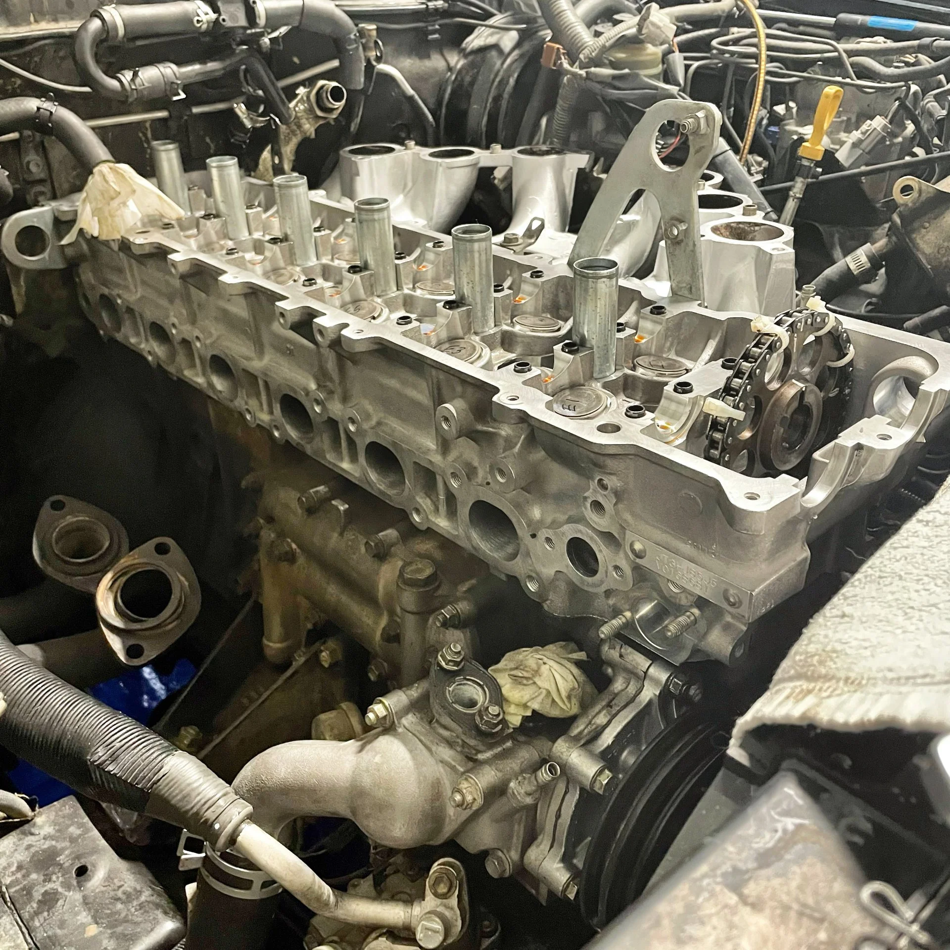

I just finished my head gasket. I put the head on then attached the lower, then the upper. I don't really see how it would make it that much easier out of the truck. It would make it much heavier too, making it harder to manipulate into place.

I have about 500 miles on mine now with the arp studs i used arp instructions hand tight not torqued down into the block also bought the thread chaser oncehead is on torqued to 80ft pounds this is what the arp nuts and washers look like. I also put the head on with the intake manifold on it all torqued to spec not sure how to do it and torque the intake bolts in the truck was wondering how that could be possible when i was removing the intake manifold in the truck.
