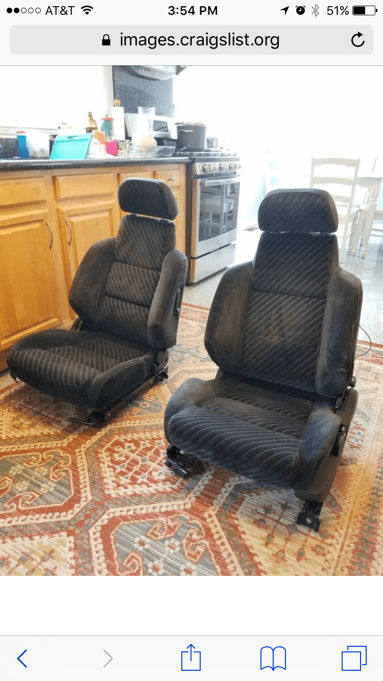

I made custom mounts for them. Work great. My favorites are still the honda prelude I put in the UTE.
Hmmm. Prelude. Never considered those. These are up for $450 on CL.
From a 1990.
I'm quite happy with the BMW seats.
1990 Honda Prelude - noted and logged.
Any other recommended CLOTH seats?
More than one option is a help when hunting for salvage units.
View attachment 1784111 Hmmm. Prelude. Never considered those. These are up for $450 on CL.
From a 1990.
Check ROW52 for a junkyard near you. I got mine for under $40.
There is a JDM version of these in leather, but they are hard to find and typically $500.
