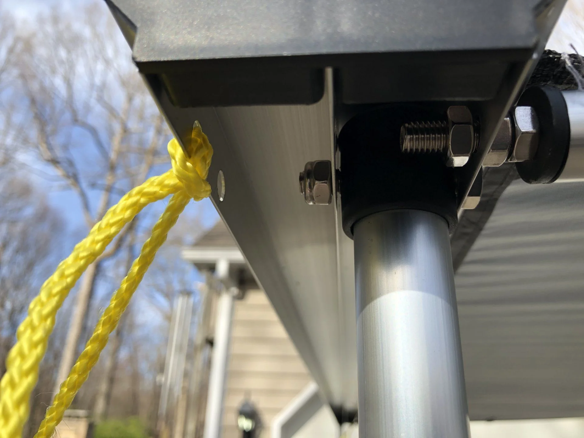

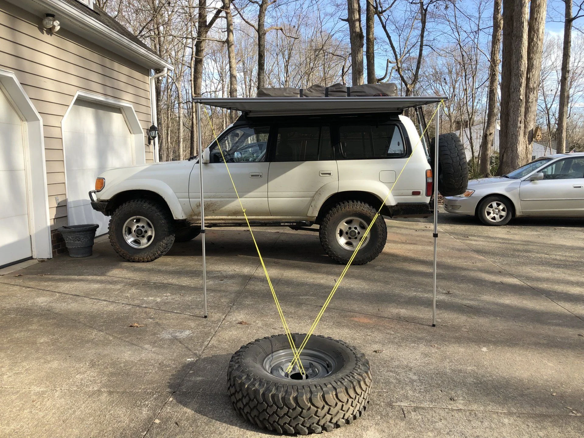

Damn Walmart is fast! I ordered on Friday and the awning was on my doorstep today! I have installed the awning and deployed it. It’s a good deal for $94. Don’t hesitate to buy for this price. The L brackets seem sturdy to me. Brackets bolted right up to my Bowfin rack using some stubby M6 bolts slid into the T channel slots. It looks like they fixed the issues that folks complained about regarding hardware (specifically lack of nylon nuts on bolts). Mine had them. The only flaw I found was that the awning fabric was installed upside down on the truck side extruded aluminum channel. I had to remove an end plate (two screws), pull the fabric out of the bottom slot, flip it over and slide it into the top slot. Then re-install the end plate. Took me 5 minutes to do this. The rest is cake. It seems sturdy enough. It’s definitely not ARB sturdy, but it’ll do fine. It got dark on me so I’ll take pics tomorrow. If you’re on the fence, this one is a go in my book.

Here’s pics:

Looks great to me, I assume the fabric is also on par? Quality looks nice from the pics. Would be a nice addition to the 40,55, or the 60 before the relic run!
