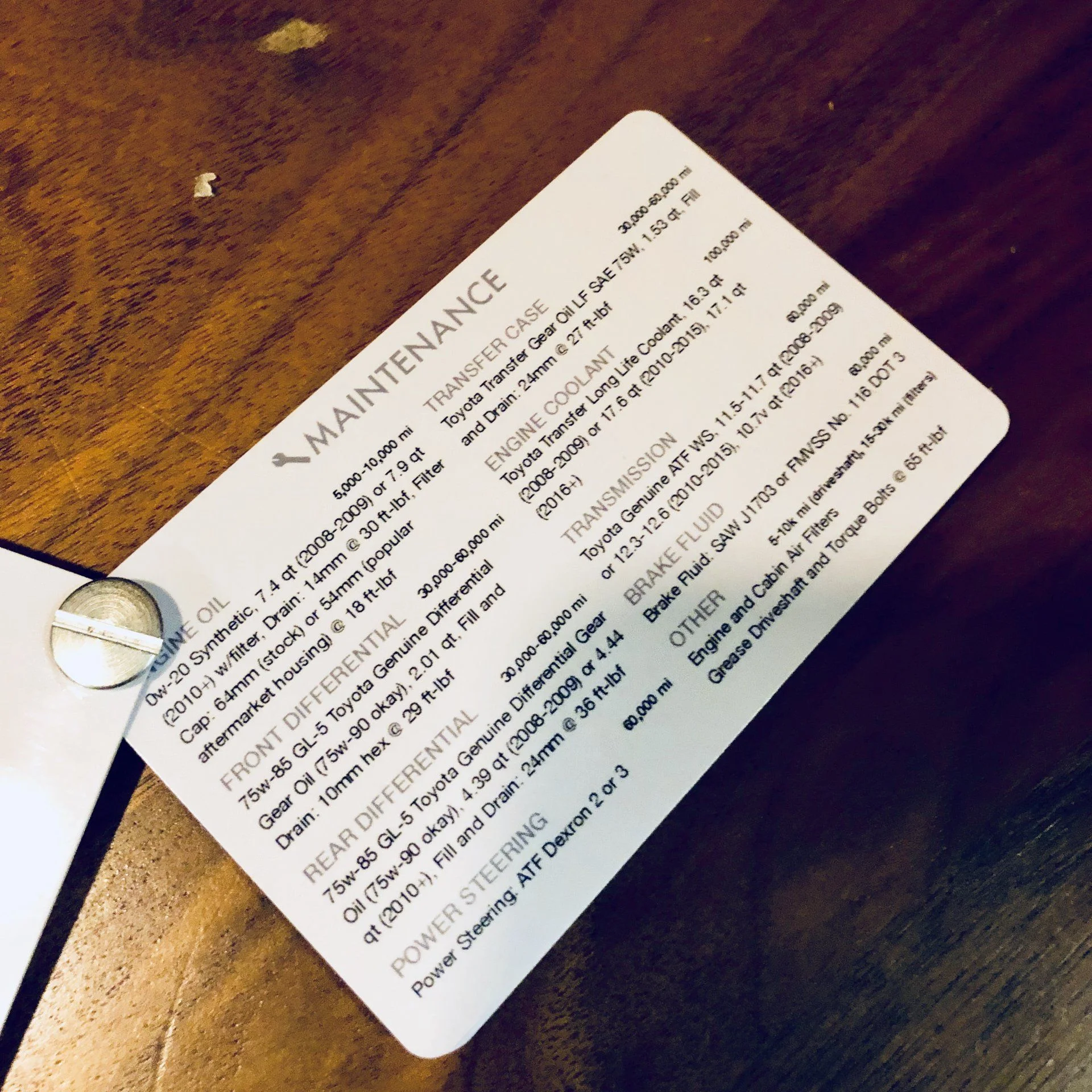

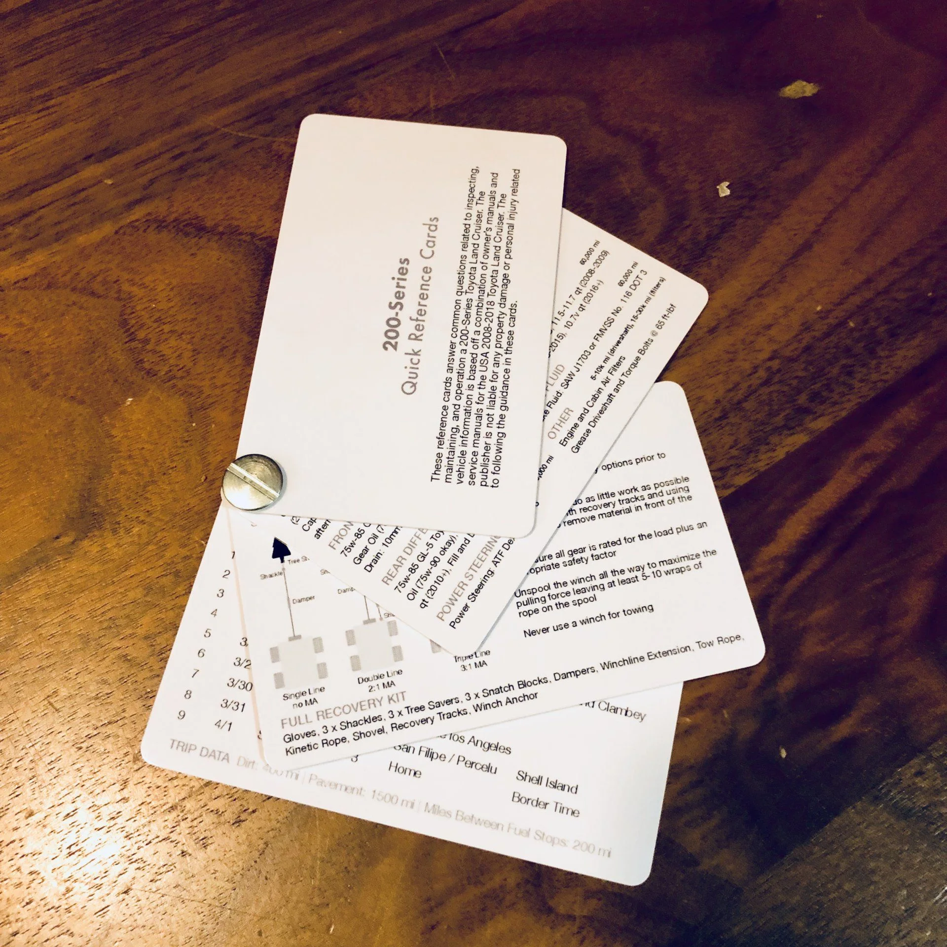

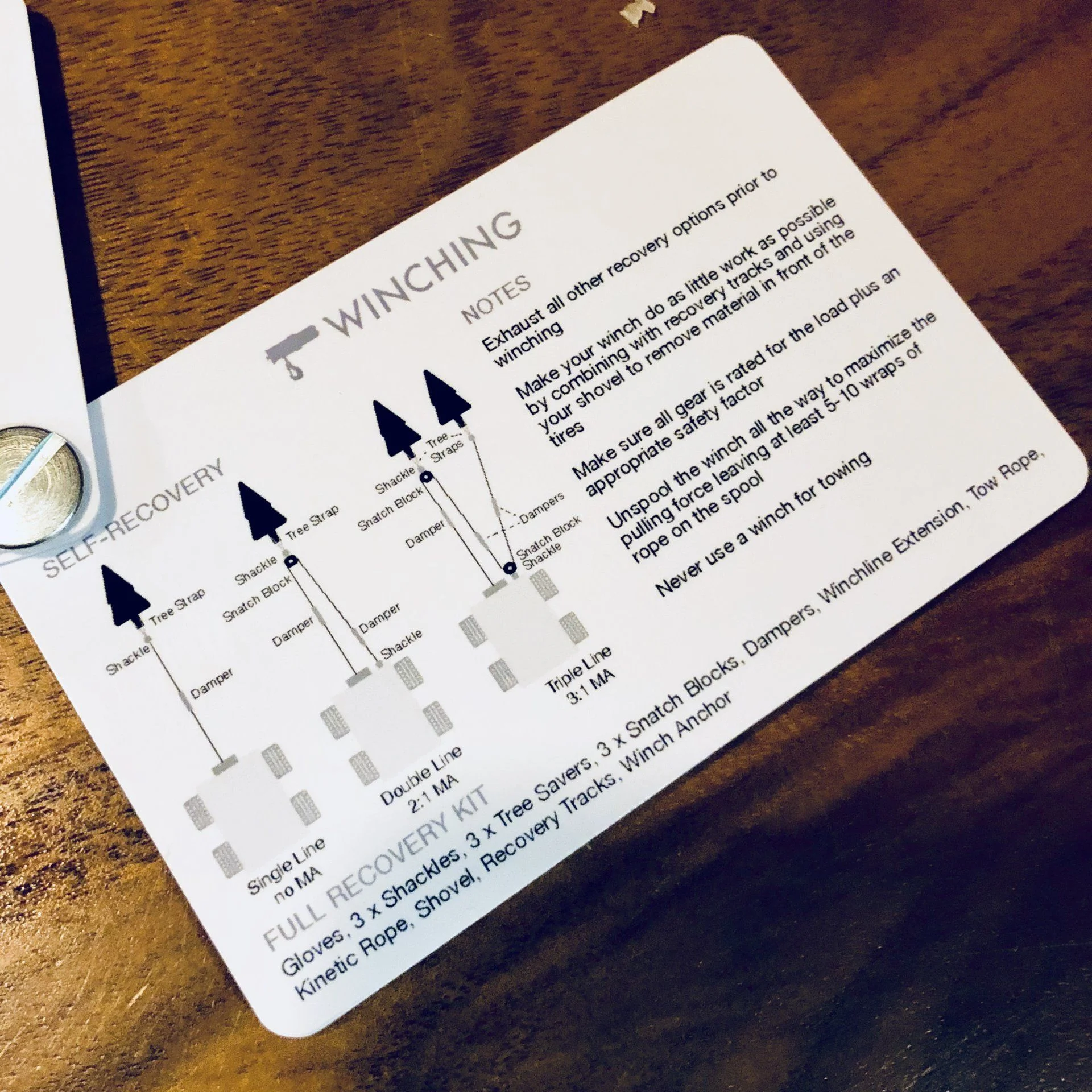

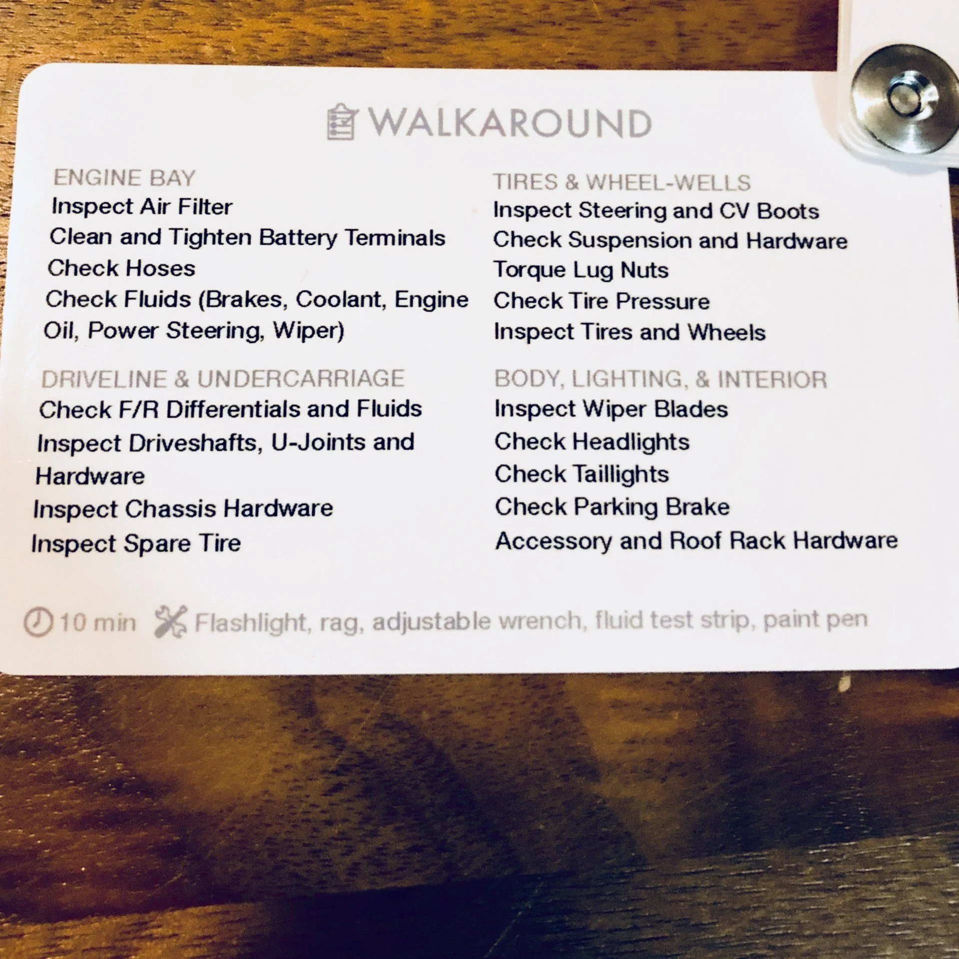

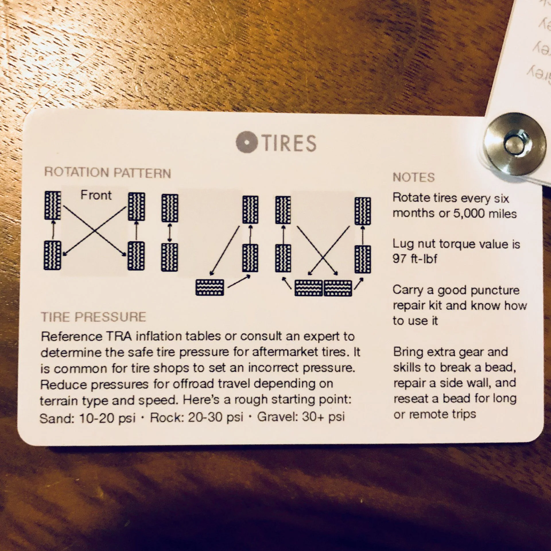

While the truck is at the metal spa I found some time to work on a project I’d been meaning to get to for quite some time: making use of the card slot to the left of the steering wheel.
I keep a copy of the FSM on a USB stick in the glovebox but it’s a bit overkill for many tasks. The idea was to write down some reminders and maintenance items on a card that would fit in the slot. Here’s where I ended up.
The slot will fit 3-4 PVC cards that I was able to print on using a regular inkjet printer. If I were being serious about this I’d probably print white on charcoal with a thermal printer. I bound the cards together as well. I think this will be handy.
The card not shown contains Baja info with phone numbers and such so I didn’t take photos.
You could sell these.

VERY cool idea, Cole. Very very.
Someone said you could sell those, and I know he's right...because I'd buy one!
(Or plagiarize from your photos! :) )
Thanks guys. I have just enough extra cards to print some for the Baja crew so a handful of folks will get some freebies.
Beyond that, I'll look into how many I'd need to have professionally printed to offer at a reasonable cost. The inkjet approach is nifty at a low volume but it's really time consuming. You could also probably fit 2-3 metal cards in that slot and use laser engraving for extra swank. I'll revisit in a month or so and will let folks know.
In any case, I'm actually pretty happy with being able to make use of that space.

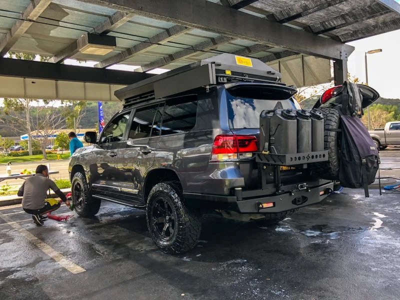

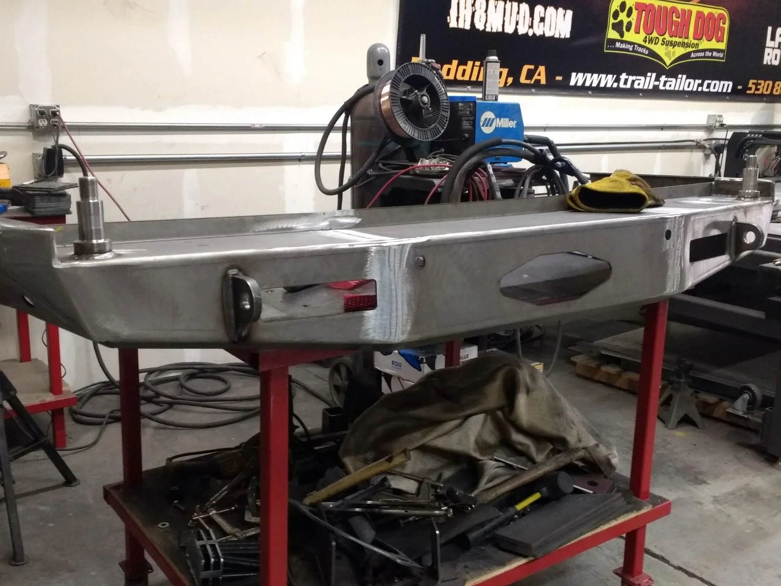

The truck was out of my hands for most of March leading up to the trip as Jason did final fitment and installation of his rear bumper. The bumper itself is pretty spectacular — the frame support for the wings, the clearance, how it can fit two tires or one tire and a basket, and the overall attention to detail, fit, and finish. I'm very happy with the product and the service. I'll try to take some more specific bumper photos next time I'm out with the truck but here are a few I found from the trip.

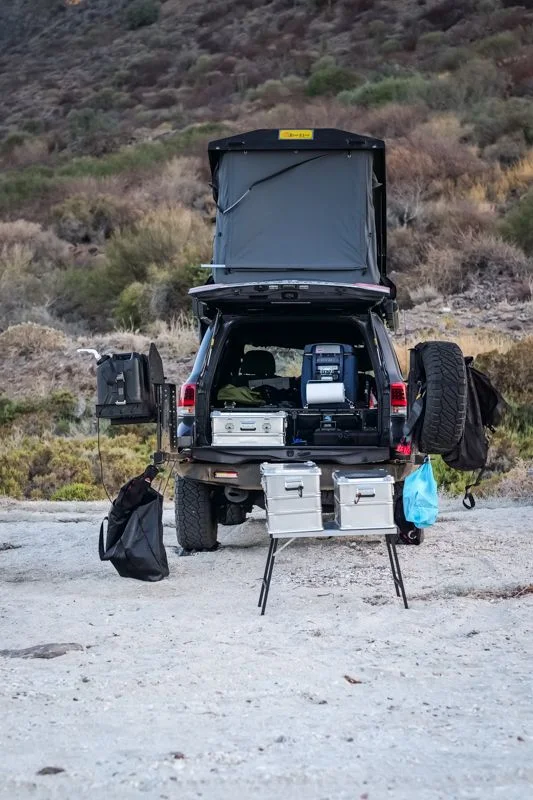

For me, a rear bumper was needed for equal parts off-road ability and for gear storage/camp conveniences. I loved not having to lug around the water jerry cans for the camp faucet or shower setup. I was able to leave the cans in place and still connect the pumps/faucets to electrical from the drawers. I also found the arms to be convenient places to hang bags, trash, towels, etc. just around camp.
I do still need to hook up the camp lights on the extendable tower behind the passenger side spare.

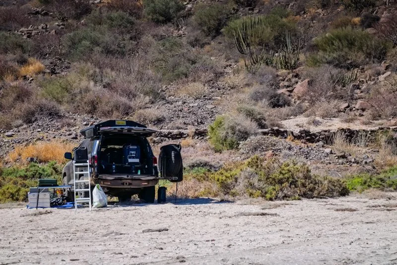

I've mentioned this concern before, but with all the recent modifications and my general over-preparedness I managed to set a new record in the truck weight category. I hit the Cat Scale in Bakersfield and was stunned to see the truck come in at 8640. Yikes. Granted, that is with an extra 115 lbs of gas, 200 lbs of water, 120 lbs of firewood, 75 lbs of food/beer/LaCroix, and way too much propane and isobutane. I'm glad I weighed the truck and stiffened the BP51s prior to the trip. I don't love the fact that the truck is that heavy and I'll likely find some ways to optimize, but at least it was nice to have the knowledge and amend my driving style as much as possible.
For comparison, I weighed the truck again after crossing the border and it was around 8000 lbs. I weighed it again after removing all cargo, drawers (because I sold them), fridge, etc... basically there was absolutely nothing behind the cabin and with no people/dogs. That total weight is around 7000 lbs (rear bumper, sliders, skids, heavy RTT, rack, bigger tires, lots of electrical, not much else).

  • I also installed a Quickpitch Ensuite tent that overall worked out very well though I missed the stability and seclusion of the Nemo Heliopolis. It works well enough that I'll probably keep it though I do need to find a better mounting location as it's currently soft-mounted with locking pins and I need to remove it to use the Stealth ladder. I imagine we'll use the Quickpitch on some trips and the Nemo on others.

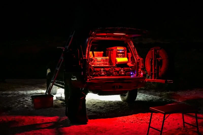

  • Rock lights were nice around camp.
