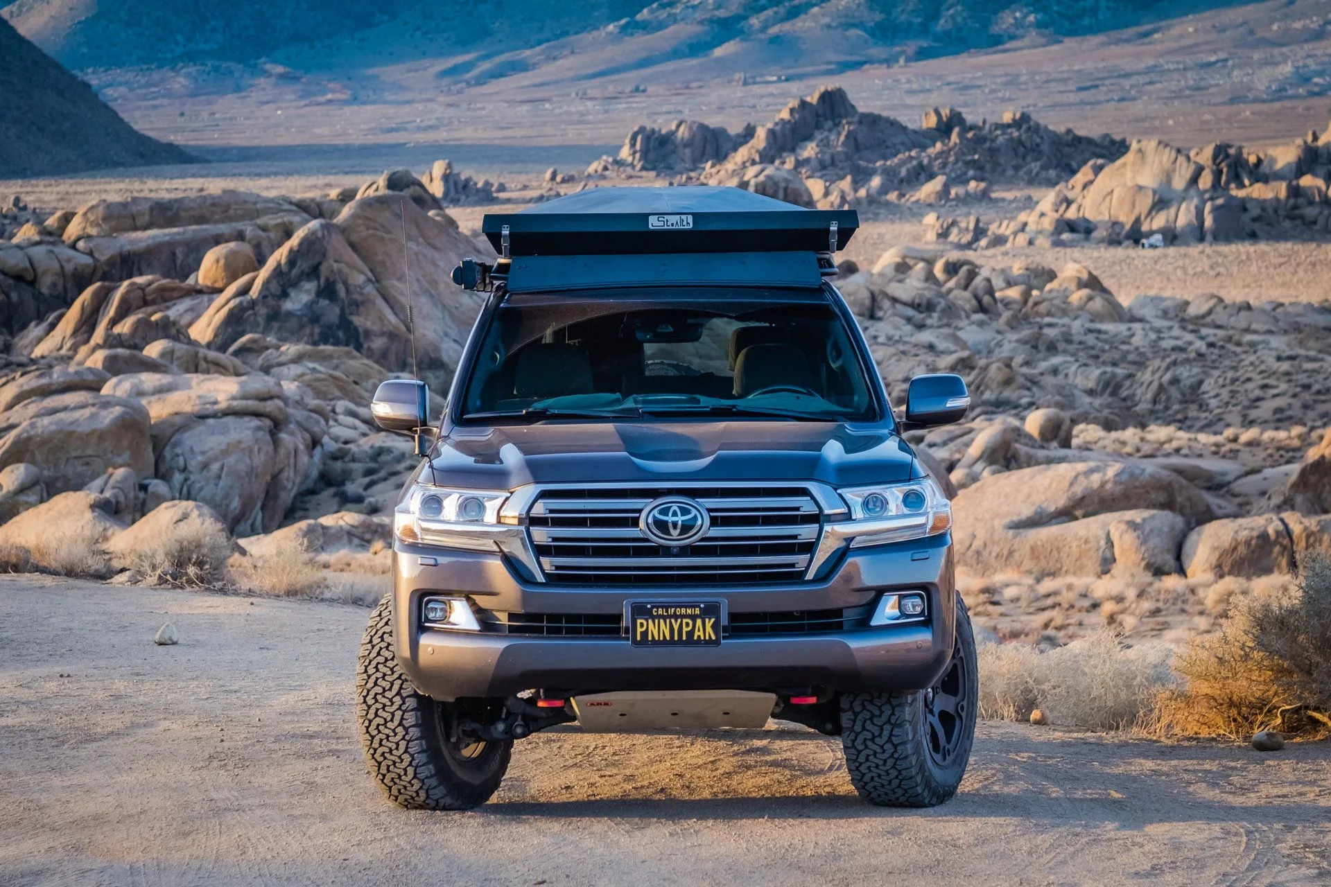

Here are a few shots of the Stealth tent from today at Alabama Hills. We’re heading into DVNP in the morning without much of an itinerary. Thinking about Butte Valley / Mengel Pass or heading to the hot springs.
Initial thoughts on the tent:
  • Easier to mount the other hard shells since the mounting rails are longer and closer to the outside of the tent
  • We really like the look of the tent
  • The ladder fitting under the tent is a nice tough though it’s a tad short
  • Materials are great and the mattress is comfortable
  • Very easy to open and close
  • Some of the exterior nuts have plastic protectors that keep falling off
  • The rear window provides a great view and the awning is a great touch and works well
  • There are small sections of the tent that are open to the air in the top corners... I wonder how these will do in the rain
  • It’d be nice to have some more interior storage
  • Not as much wind noise as the JB... it may even be a touch quieter than the bare rack

Which JB tent did you have? The Stealth is 220lbs? Do you notice the weight difference? The stealth seems lower profile up front, so the reduced noise makes sense.
I had the JB Discovery Extreme XXL. The JB was 160 pounds but we usually had 80 lbs of gear in the cargo area. There’s less wind noise with the Stealth for sure but I didn’t really notice the weight of either tent on pavement. Off camber, though, you can tell it’s up there. I haven’t noticed any reduced ability offroad with either tent.
Good to know. Thanks. I’m getting the LC as a family trip type vehicle so I won’t be doing anything to crazy in it anyways.
Cole, have you noticed much of an impact on your mileage from the tent?
Yeah, I believe so. Highway cruising previously ranged from 13-16 depending on wind and speed (no wind, no hills, 55-65 => 16 mpg vs wind, hills, 75+ => 13 mpg at the other end of the spectrum).
With the Stealth, those numbers have pretty clearly dropped by 1-1.5 mpg. I noticed the same thing when the JB tent was up there though the effect was more like 2 mpg. The tent weights aren't that different but I did have a storage back on top of the JB tent that definitely had some additional wind drag.
