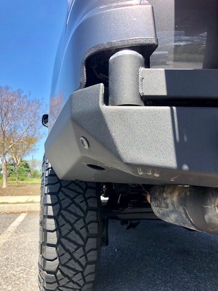

We’ll talk when your winch cable is an integral part of holding suspension components in place when the rocks get a little too big...
Yeah, you would just need to extend the wiring harness to make its way up to that point. The wiring would still be short enough to not have voltage drop issues.
If it was me, I would but the Toyota wiring connectors, and make a plug n play adapter that adds wiring length without cutting into the factory wiring.
But now that I’m think of the negative issues, you’ll have a wiring harness that needs to be ready to handle the moving of the swing arm, and not get caught on stuff when loading and unloading the cargo area.
So yeah, anything is possible, just need to make sure its not going to create another problem.
Another thing to think about is that the sensor doesn’t need to be on something that makes first contact, it just needs to be positioned to “sense” something before it makes contact.
And I know most don’t care about the parking sensors, but there’s no reason to treat an 80k LC like a beater ‘90s Jeep and cut items out.
I’m just guessing that Jason couldn’t aim it straight back cuz it would “sense” the carriers.
I bet one could put a harness inside that panel above the pivot point and leave a little slack for the arm to swing. Drill a hole for a grommet and fish a wire thru the bar to the point where it would come out to go to the end of the Can carrier. Zip tie the last portion. And if you ever take the swing out off, use the harness to remove the wires.

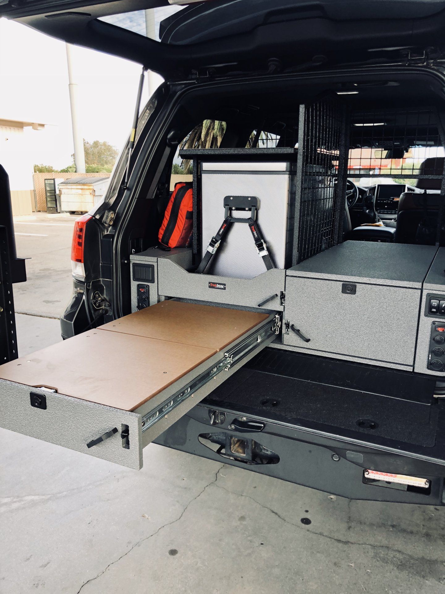

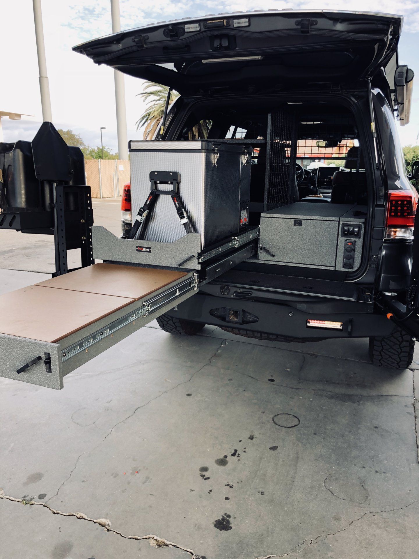

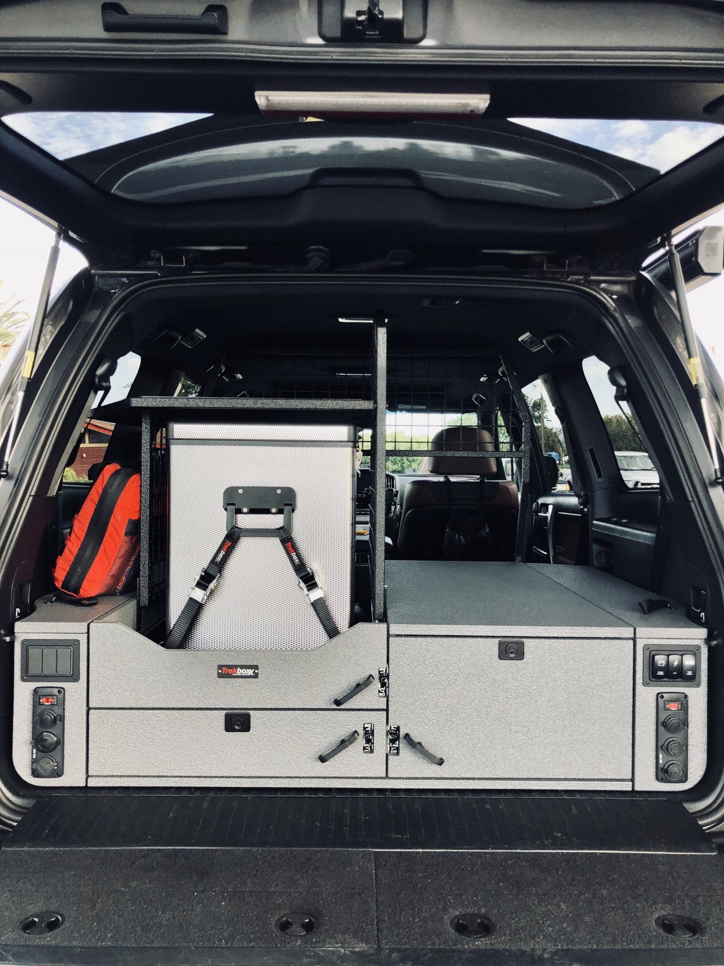

Quick update: the Trekboxx drawers are in! I drove to the Trekboxx HQ for install today where David put the finishing touches on what I believe is the first installed drawers for the 200.
Not that I’m surprised, but the drawer system is amazing and exceeds my expectations. I’ll have much more to say and more details to share once I get to use the system on the trail. In the meantime, here are a few photos from a gas station en route to Redding for another round of TT love from @reevesci.
Special thanks to @TrekboxX and @RobRed for a fun afternoon of working on the truck.

Impressive!
Looks extremely well thought out.
And as usual...Cole keeps finding new ways to make me realize an LC build is never...EVER...finished! :hillbilly:
