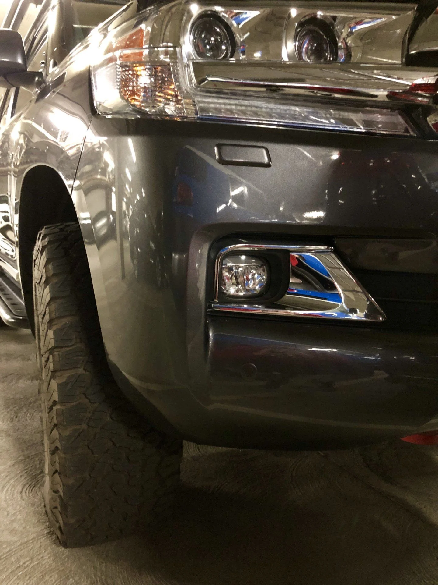

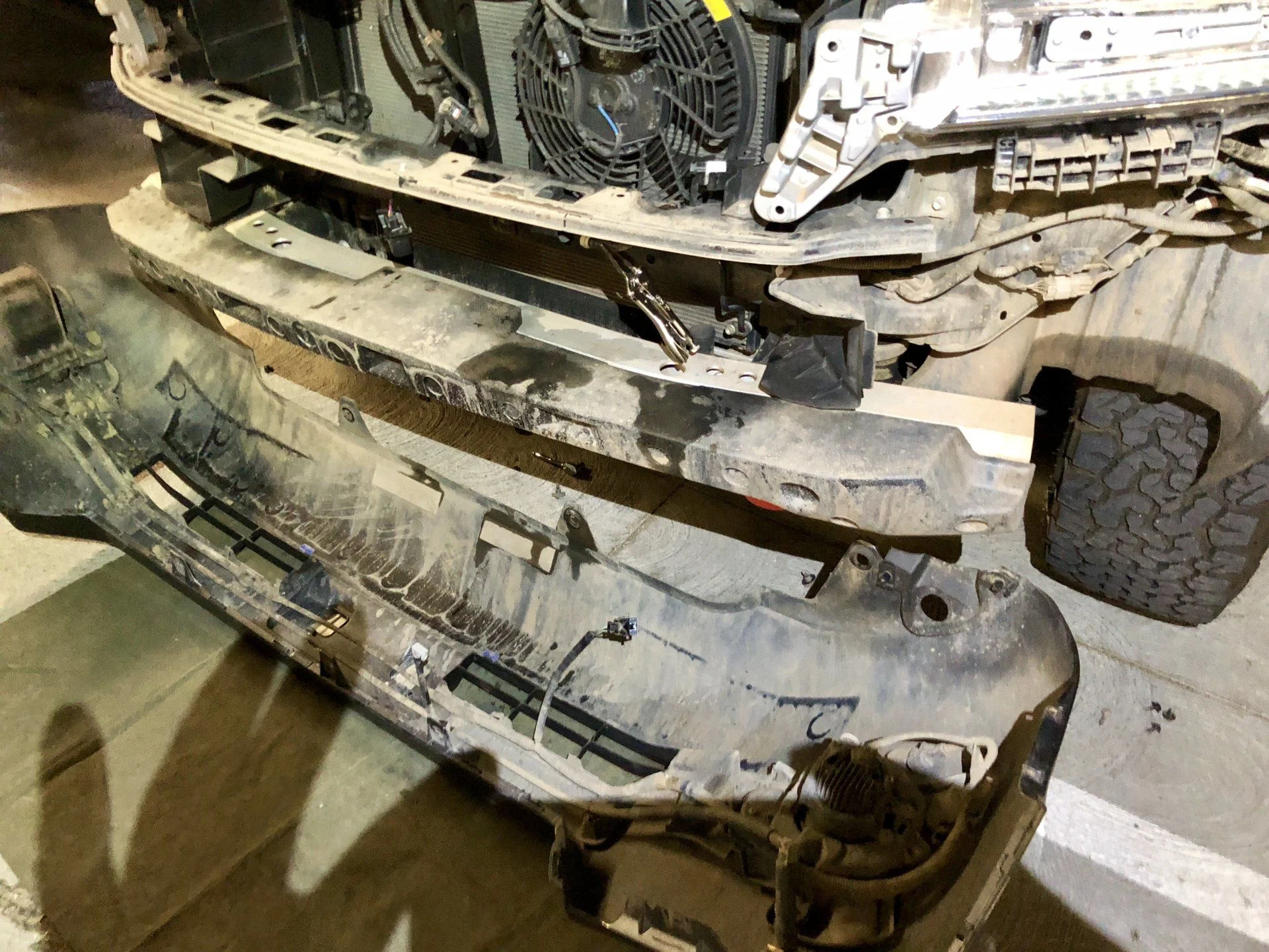

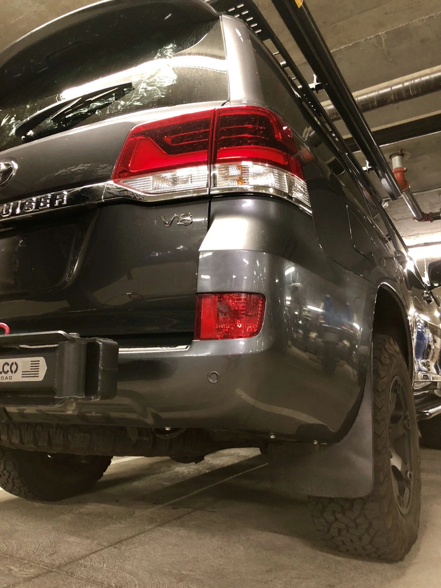

I finally put my original front and rear bumper covers out of their misery after 18 months of abuse. On my first trip in the truck in 2016 I wasn't paying attention and some Tahoe trail overgrowth stabbed the front bumper in just the right places to ruin a parking sensor, headlight washer, and deliver a deep gouge in the plastic. There was also some light scratching from Moab.
The rear is a different story. I've covered most of the damage in this thread. Why replace the plastic covers? Well, the rear was damaged badly enough (way more than was even visible) that it would need to be replaced for pretty much any off-the-shelf or custom rear bumper and the truck is going in after the first of the year for a custom rear from Trail Tailor. I'm also planning on moving forward with a hidden winch mount up front (I may eventually do a bumper but am going this direction first) and it quite simply it was cost effective to have them both painted at the same time as the cover itself isn't that pricey.
Here are some notes on replacing the stock bumpers for anyone else who takes on the task.
  • The bumper cover parts don't include any hardware and you'll need to transplant some parts (headlight washers, sensors, fog lights for the front, reflectors in the rear, wiring harnesses and mounts etc.) from the old cover to the new. The transplant takes as much time as removing the bumpers.

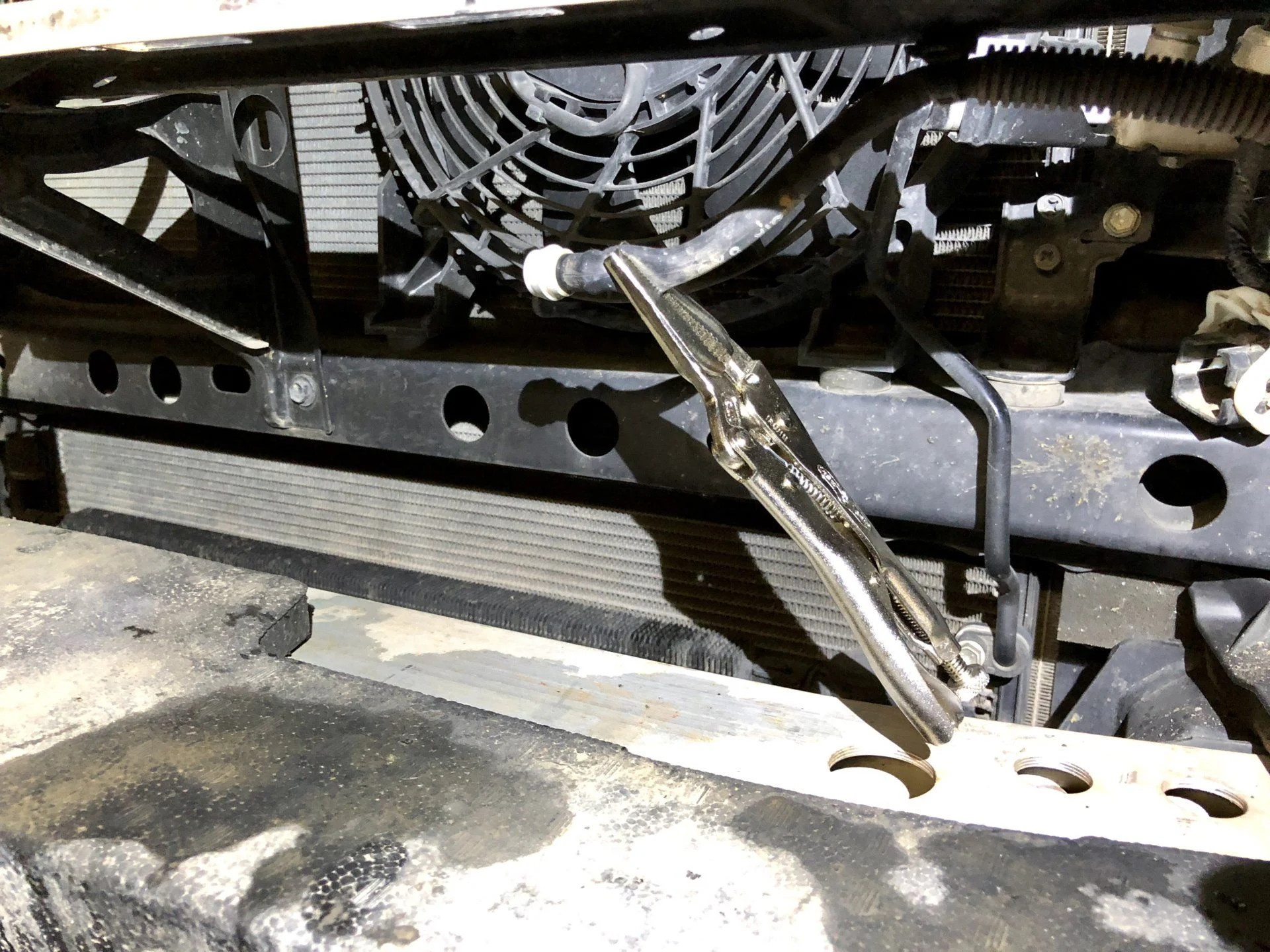

  • Don't forget to clamp off the headlight washer hose.
  • If you've damaged your rear bumper before you may need new side moldings to attach the bumper to the vehicle. I've replaced my side molding twice.
  • I don't know if this is the right way to disassemble the parking sensors, but I pushed them through the hole and then unclipped the mount from the sensor using a tiny flat screwdriver and then shimmy'd the sensor out. This is probably useless advice in the abstract. Is there a better way to do this?
  • Unscrew the front camera from the grill instead of trying to unplug it. The other wiring harness has a special connector that requires "pinching" a release near the connector itself and then you rotate the white housing upward. I also found it helpful to remove the grill after removing the front cover.
  • The 2016 has some chrome that needed to be removed below the headlights. This was surprisingly difficult to remove and one of the chrome molding bracket mounts actually broke off from the headlight. In hindsight, this was one of the unusual cases where I actually don't think I did anything wrong. Fortunately, it was a simple enough fix with a slightly longer plastic screw.

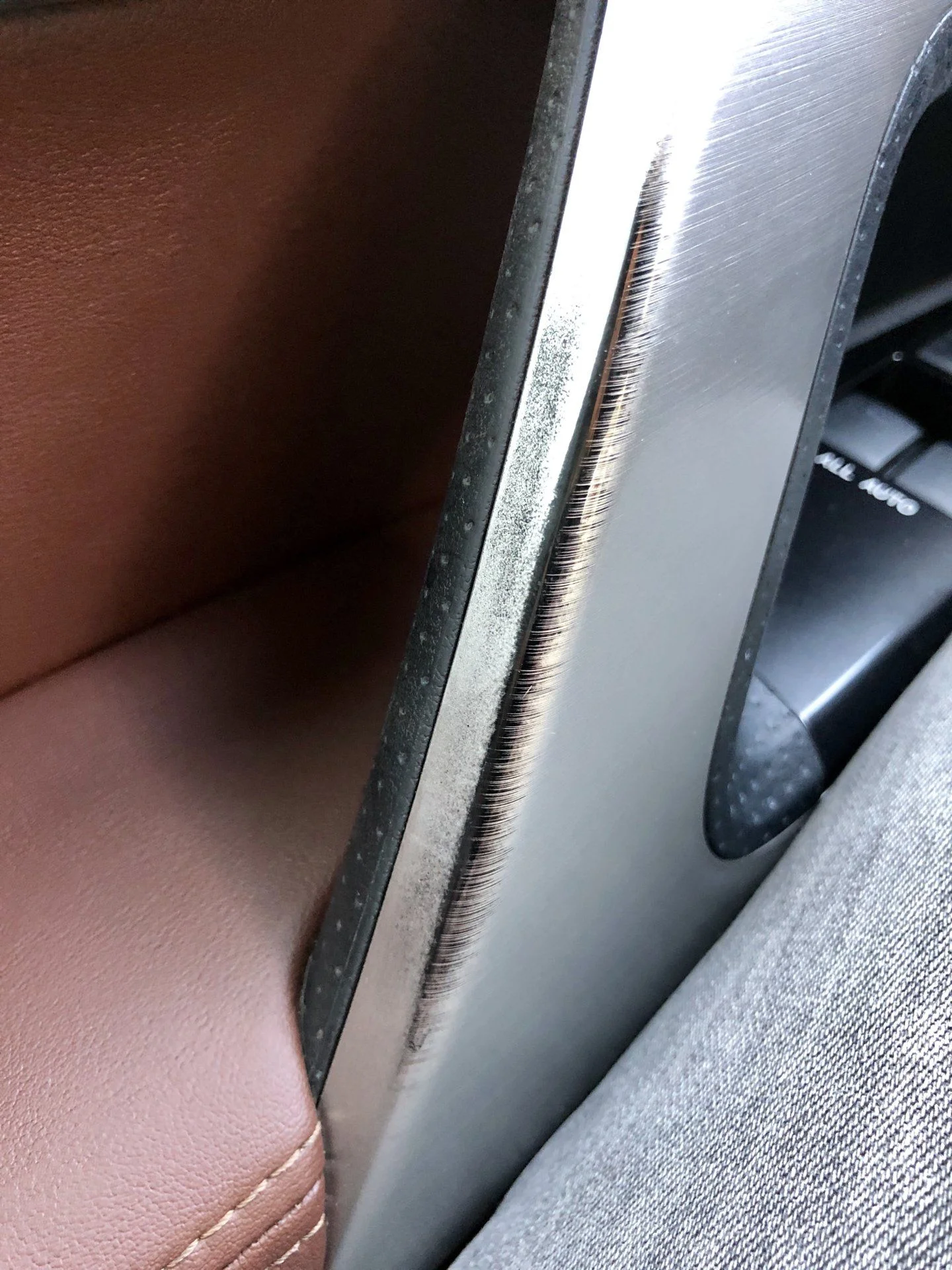

On a completely unrelated note, the driver side door handle seems to be wearing more aggressively than I'd expect. It's a $25 part from Toyota but I may see if it's covered under warranty... doubt it.
Rings on fingers, watch clasp on wrist, and keys in hand when grabbing things on the interior equals scratches and wear. Little doggy nails too. I'll see folks get in their car in the morning while juggling keys, coffee, and a bag. With both hands full the keys usually get rubbled against door handles or steeling wheels. Or tossed onto/into the center console. If not keys then jewelry. Ditto while exiting.
Most pay no attention and don't really care. Typically it's chalked up to normal wear/tear. Door handles, steering wheel, shift lever, parking break handle, trim by window switches... If you look closely at any places where hands go you'll see the wear and the scratches.
But Toyota is paying some attention to this. i.e. Inside the exterior door handles - used to be a finger nail and wedding ring scratch magnet - now Toyota has placed a sticker/film there to combat some of it.
Also in 2016+ Toyota has changed the texture on the grab handle and door handle to help hide the typical wear/scratches.
Yeah, it's a minor thing but one of the reasons I posted about it is that the wear pattern seems unusual. This is mostly a weekend vehicle and I'm seldom driving without my better half. She's the one with the rings, keys, nails, etc. yet her door handle doesn't look a day old. I've been monitoring it for a while, as well as my interactions with the handle, and it's hard to come up with any time where there's anything more than my plain hand on the handle. It's not part of any typical driving positions, either. Either way, not a huge deal. I'll replace the part and see if it happens again. I'm mainly curious as to whether it was caused from normal wear or an isolated event.

I'm with you on that one. It doesn't look like scratching. It almost looks like the texture is wearing away or didn't get finished completely around the edge. As you said the other doors don't look like that.
It's one of those things that bug me too. I've got a box of parts to replace the handles on mine - just waiting for snow or a rainy weekend to get it done.

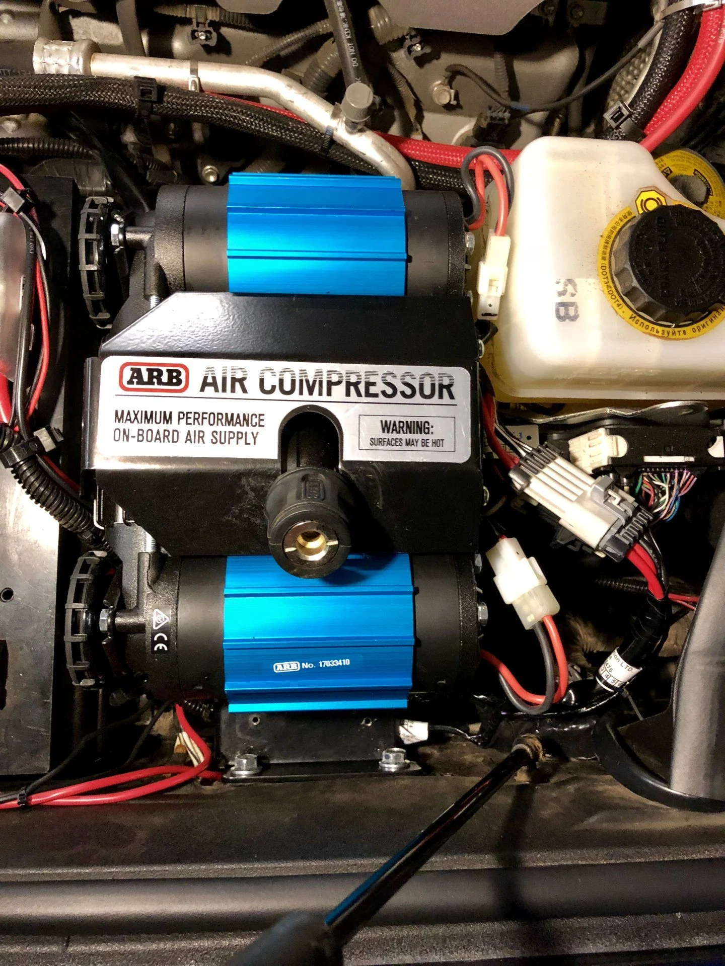

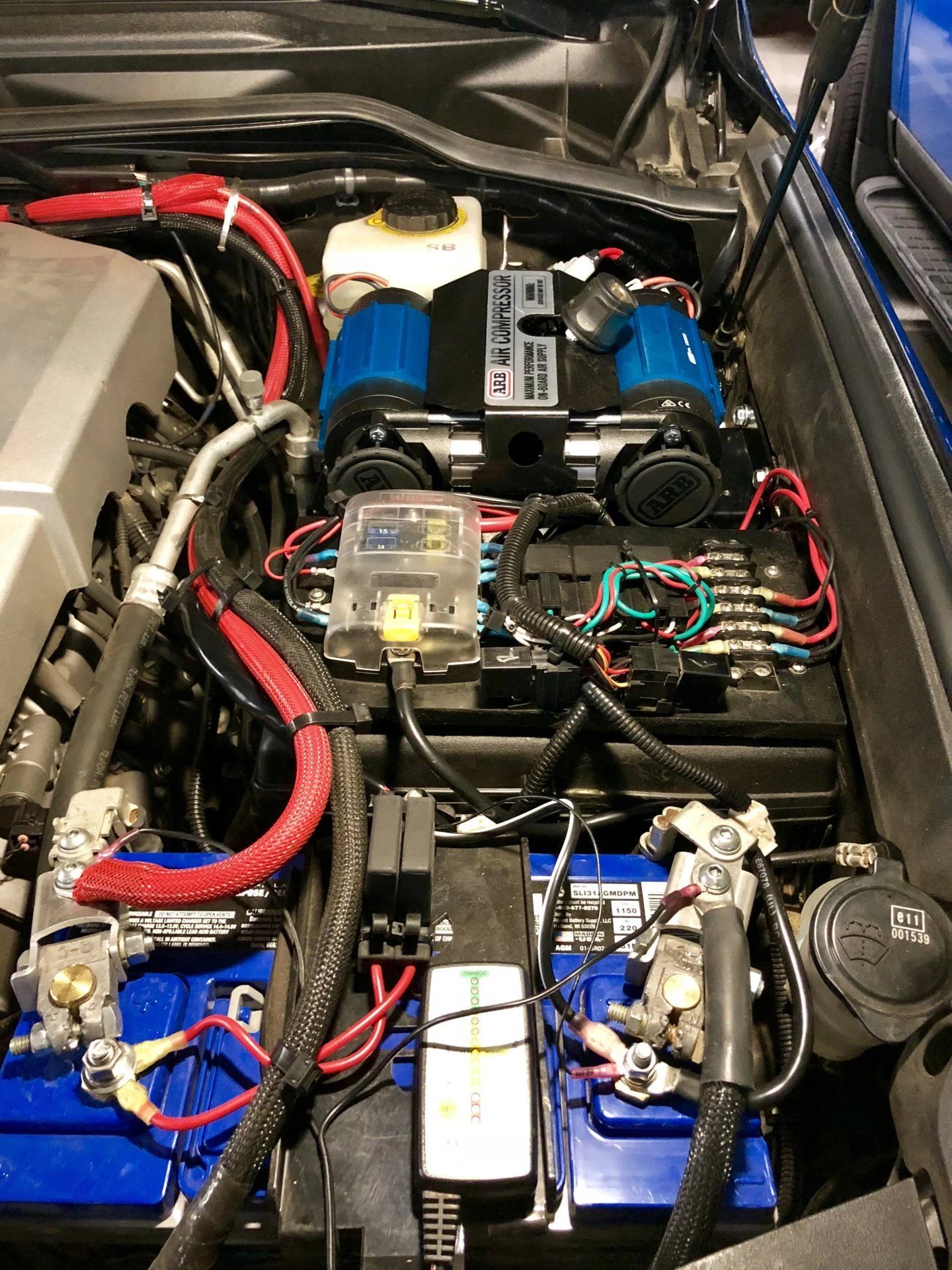

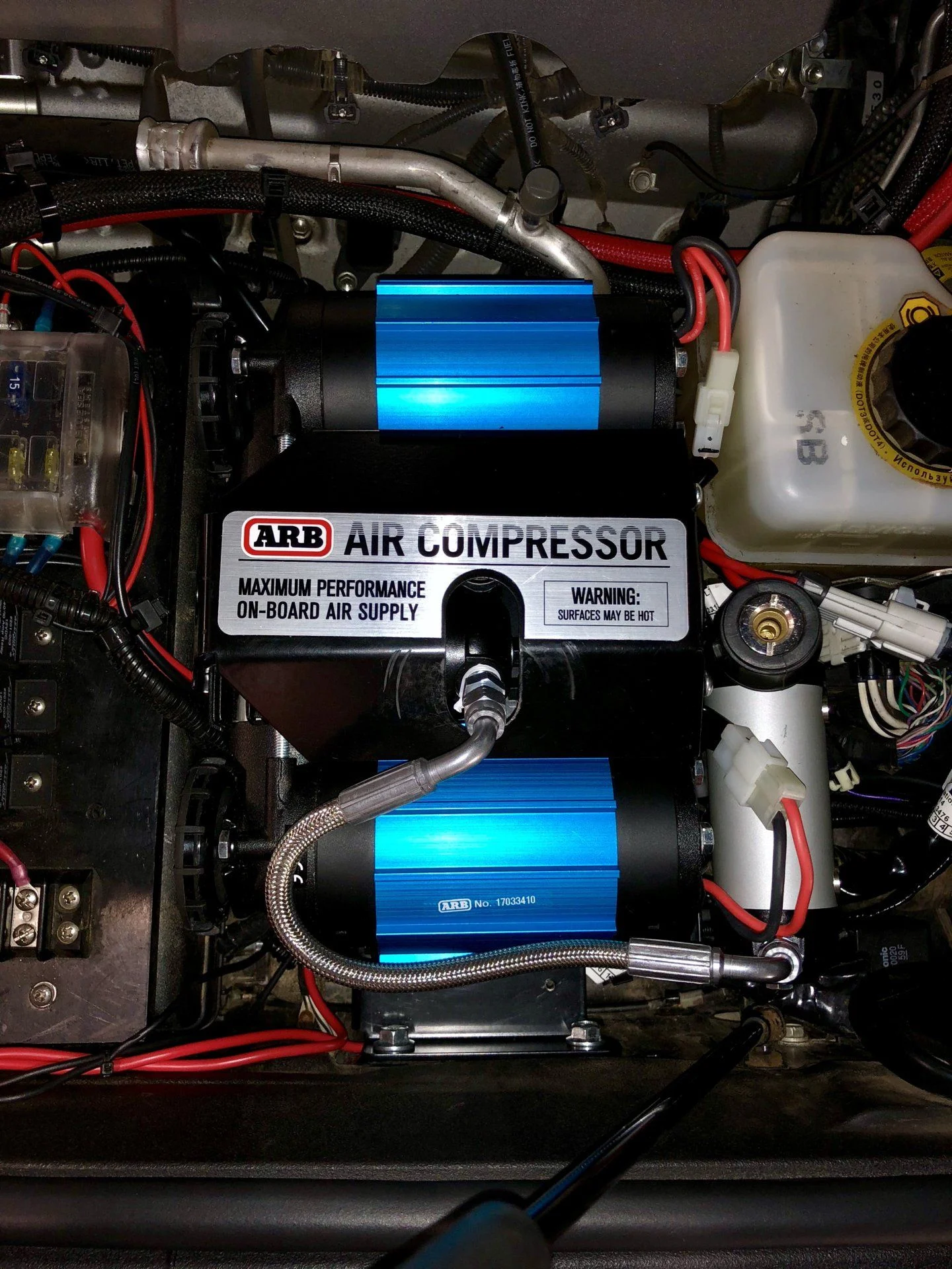

I finally buckled down and completed an electrical clean up project and also swapped my single ARB compressor for the dual unit. The output pressure is close to my CO2 setup and I’m hoping to eliminate CO2 from my kit with this upgrade.
In terms of electrical, I added some more cable ties to the 0/1 battery cables though I’m still looking for a route with more reinforcement that doesn’t stress othe components. I also consolidated my two fuse blocks to one and had to lengthen some wires to do so. Most exposed wires received a split loom wrap. Finally, I organized all extra slack into a couple of service loops below the compressor.

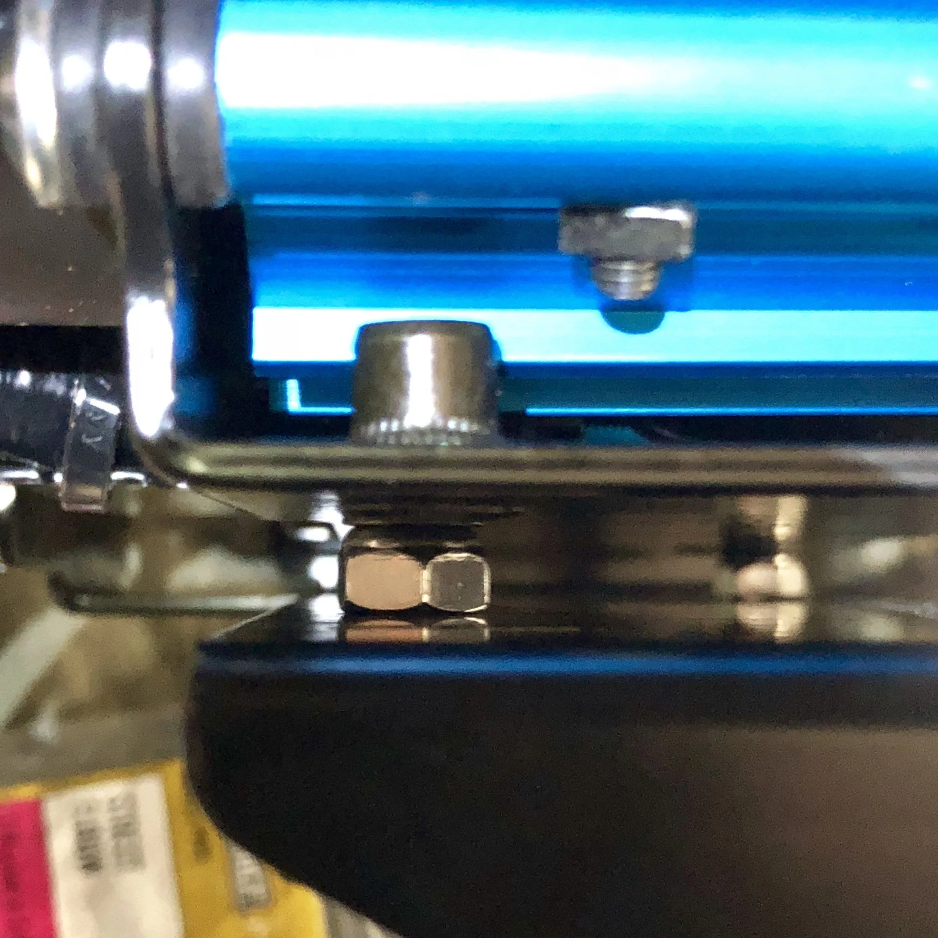

There was a bit of surprise with the compressor mounting bracket — it places the compressor too low and the fuse box clip is in the way of the filter. To remedy, I used some nuts as spacers.
Luckily, everything worked perfectly after hooking stuff back up. What’s next in electrical land? Well, I’m out of switch blanks and also have to figure out where to mount the LRA fuel switch. The ARB Linx comes out in early 2018 so I’ll probably give that or the Spod a try. I’m hoping to clean up the battery when that happens as well.

I added the manifold for the ARB compressor as the inflation fitting didn't have enough clearance. In other electrical news, I ran wiring for a dome light for the engine bay and rock lights for the front, sides, and rear undercarriage. The lights should arrive this week so hopefully I'll have them installed this weekend.
