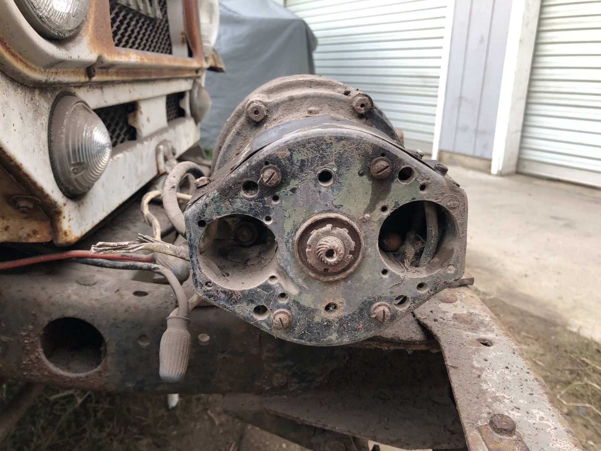

Hey guys! Can any of you identify this winch and its relay setup? (Obviously missing some bits)
Thanks!
-Seth
Looks home rigged and totally safe. I would run it as is. :D......
Please dont turn it on. :skull:
Haha... I was tracing those wires and very glad I didn’t throw some jumper cables on the starter to roll the truck...
identify the winch? how about calling it...………. scrap
o_Oo_Oo_Oo_Oo_Oo_Oo_O:confused::confused::confused::confused:
Yeah, it’s definitely not staying on the truck.
...Still want to try to ID it.
Bueller...anyone?

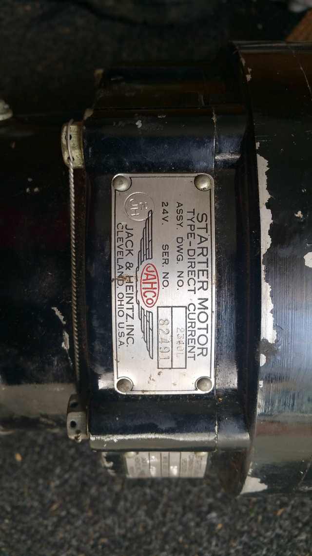

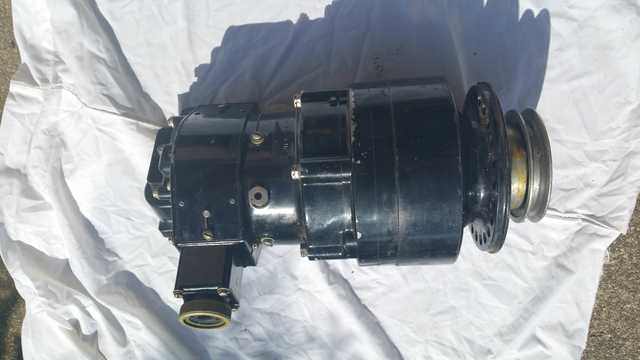

I’ve got one. Much cleaner. I was told it’s an aircraft landing gear motor by the local auto electric shop. They’re precision machined with sealed bearings. No Cheasy cheap bushings. Probably about 8000 lb capacity.
They’ll easily drag a vehicle across a muddy field.
Edit:
JAHCO JF4HR WW2 aircraft starter motor
Looks like it was originally 24v. I’m not sure if mine was converted to 12v when it was rewired to be reversible... or if it is a 24v running on 12v.
They also have 8 large brushes... military redundancy.
Edit:
View attachment 1855059 View attachment 1855060

By original design 1/2 the brushes were connected to ground. They are now wired so polarity can be reversed. I once made the mistake of reversing the load direction, and it messed up the armature a bit.
It starts off slow and builds up speed. I can see it being a starter motor... especially if it originally spun under double the voltage.
The outer “windings” aren’t wire, but instead coils of thin sheet metal. As for the armature, it’s almost completely sealed and I don’t remember what if anything I could see. Mine has been off since ‘96 when I melted down the wiring after pulling a 2wd van out of a 3’ deep hole. The winch is fine, but the control wire shorted out when I went to check on the progress. The winch was only half installed when I came across these 2 guys trying to cross a deep trench in a stock van.
