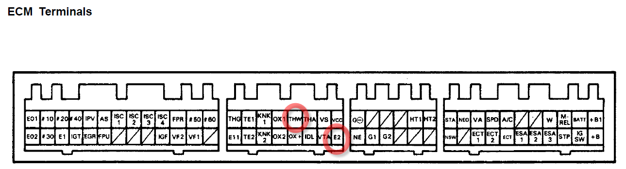

THW is the water temperature sensor in the head and E2 is the ECU common ground:
Note the conditions for the test:
Ignition switch = "ON"
Engine coolant temperature = 176°F (engine fully warmed at normal operating temperature)
Voltage between THW and E2 = between 0.2VDC and 1.0VDC

Unless you really know the board layout well, it's best to check all the terminals listed, to rule out interference between unrelated circuits. You could have a bad trace on the board. Ask @cryorunner
