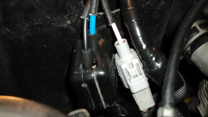

Check the fusible link
Fusible links: eyelet end attaches to the positive battery clamp, the black and blue links attach to the AM1 Junction box. The ~ fuchsia pink wire with the grey connector (connects to the engine harness) is the one that feeds power to the ECU (FZJ80):
Showing black and blue fusible link wires attached to the AM1 Junction box and fuschia/pinkish wire attached to engine harness connector:
Note that the studs and nuts on the junction box are different size as are the eyelets for the blue and black wires (to assist with correct installation).
AM1 junction box lid closed:

^^^AussieHJCruiser^^^ suggested to check the Fusible Links (twice). I just added the photos.:)
The electronic gurus would know what else can cause those symptoms but most of us on the forum for awhile have either read about and/or experienced the same symptoms. Engine cranks but won't start (not firing), with no CEL in the instrument cluster when the ignition key is turned to the ON position means the ECU is not getting power. And one reason for that is a broken/blown fusible link wire.
Do not run with a substitute non-fusible wire for very long (if at all), whatever caused the Fusible link to pop may still be lurking so you risk burning up your engine harness without the correct Fusible wires installed.
