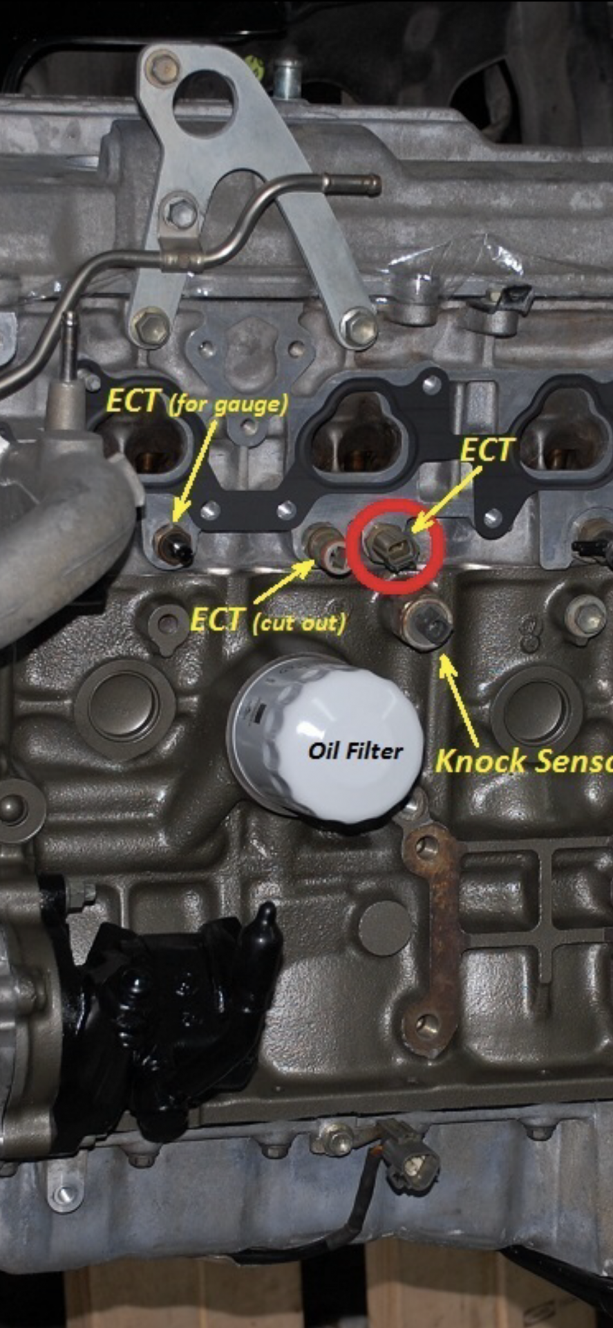

I did change the temperature sensor on the block (near fuel filter) . I will also check fuel pressure. Thank you
I would guess the ECT sensor is crapped out. The ECM could be fueling the cold engine like it’s warm. I had the same problem, but opposite years ago. Engine tan good when cold, too rich when warmed up. Truck would stall and sometimes not start when warm.
I will double check this too. It is only 1 year old. And I had these same problems before.
Make sure you check/replace the sensor for the ECM, not the dash gauge.
