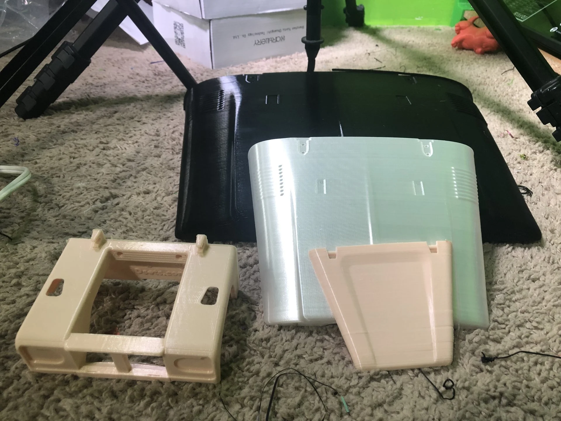

I threw a PETG carbon fiber into the mix; you’ll need a hammer, probably, to break it. Even the PLA one is very tough at this size; and likely more feasible because weight.
Also added ironing to the top layer, so the front of the hood looks more smooth.
Going to spend today tuning the hood some more, still PETG, and then taking the refined settings over to the rest of the Body.

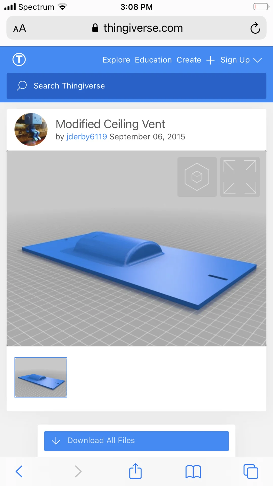

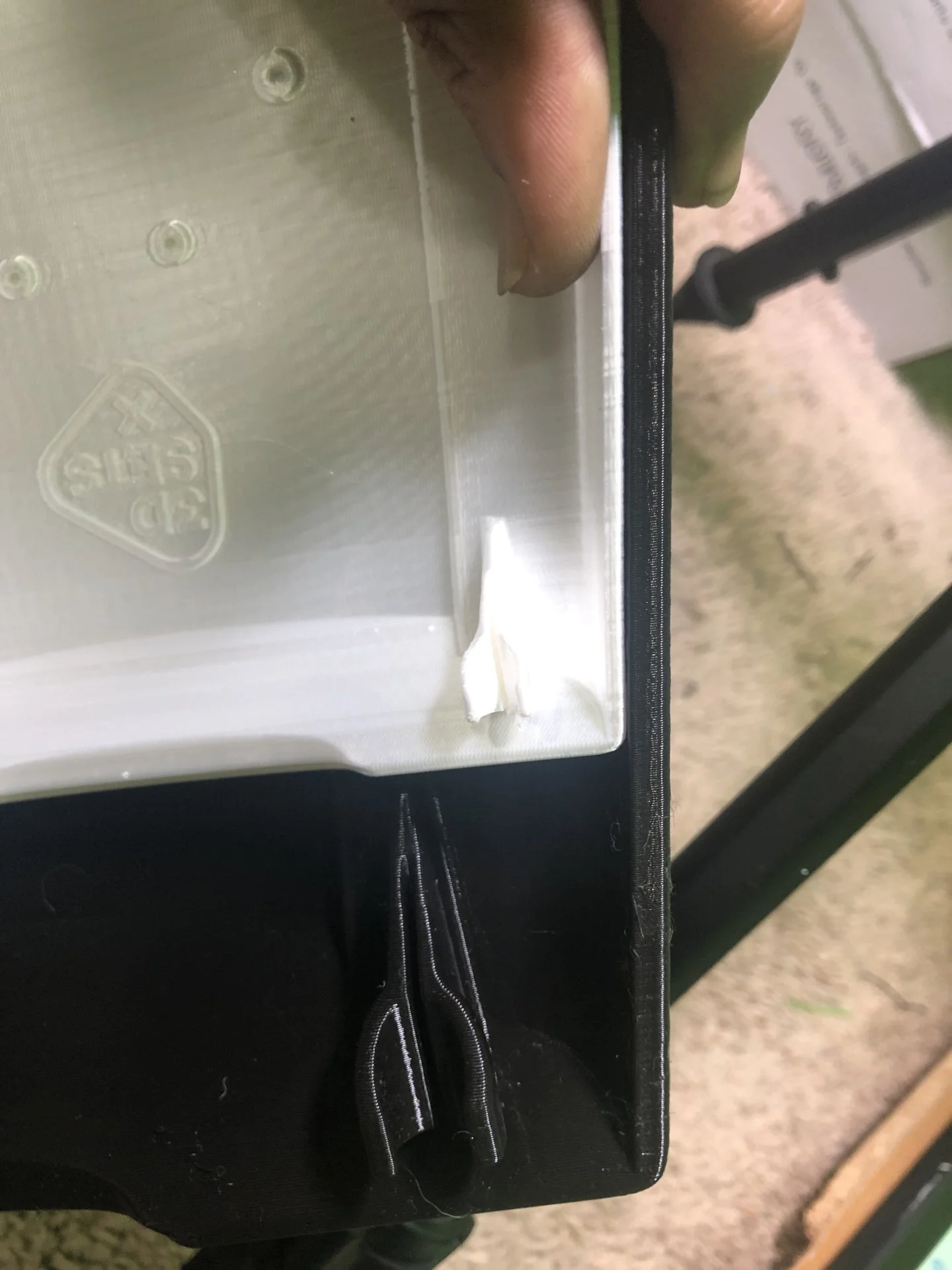

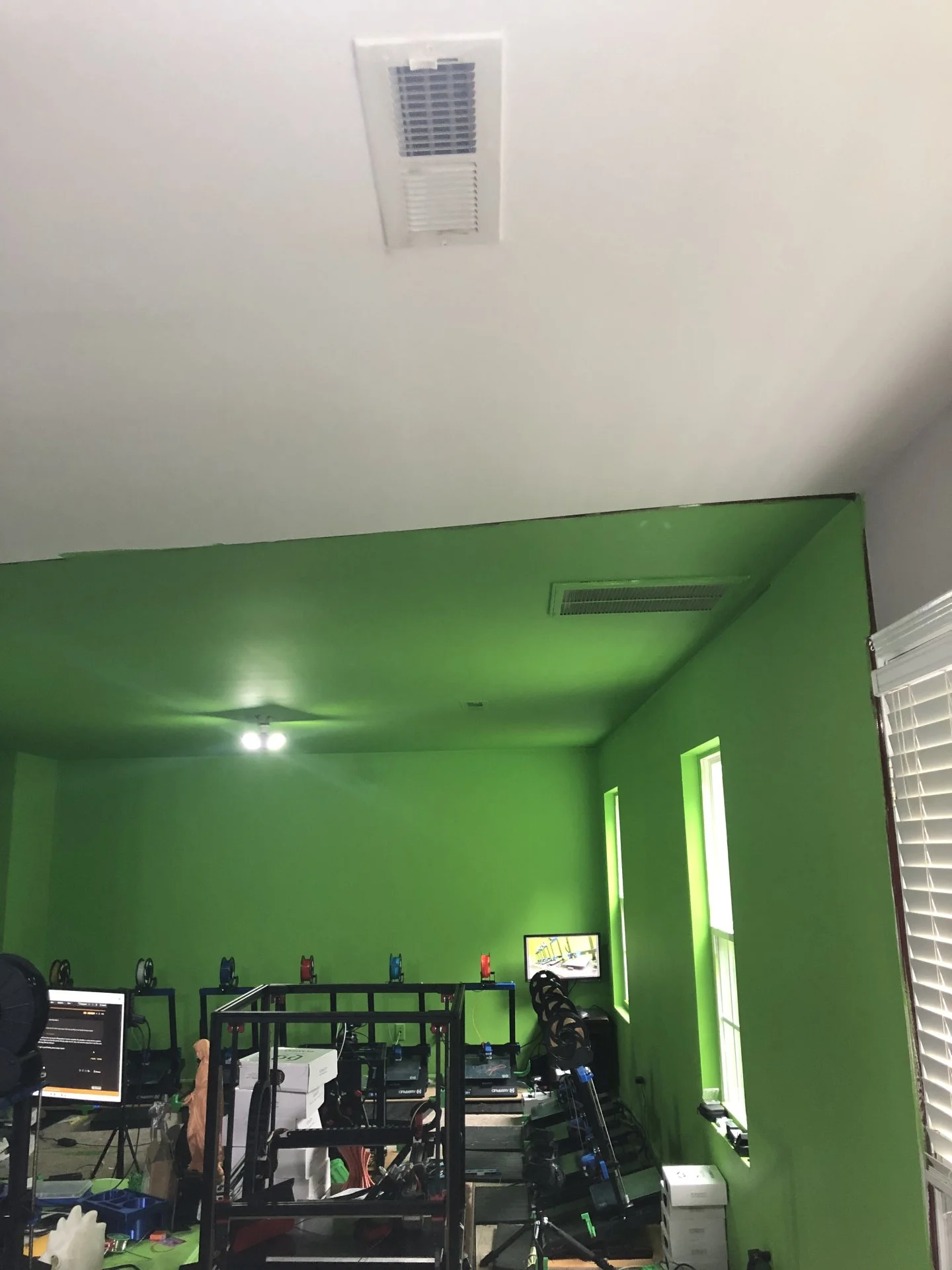

It wasn't until i looked at the photos after i made this post that i figured out why my hood is lifting before the prints complete: the doubles in colors shows a pattern of which printers are finishing and which aren't. From that I was able to figure out that the printer directly under the AC vent, and ones far away from it are the ones completing the prints; the others are being lifted by the air conditioning directly hitting it.
Taping up the kitchen and living room air vents and trying again! I got a good feeling about today's batch!
Decided to go with this instead of taping up air vents; good chance to add a little more green to the room. Blowing air back into the kitchen!

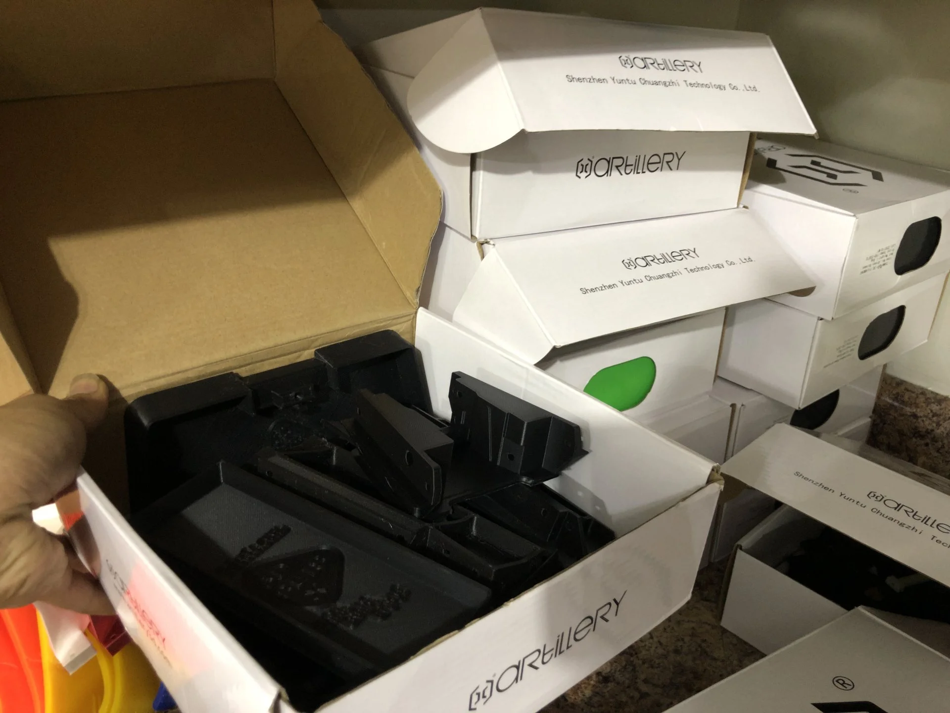

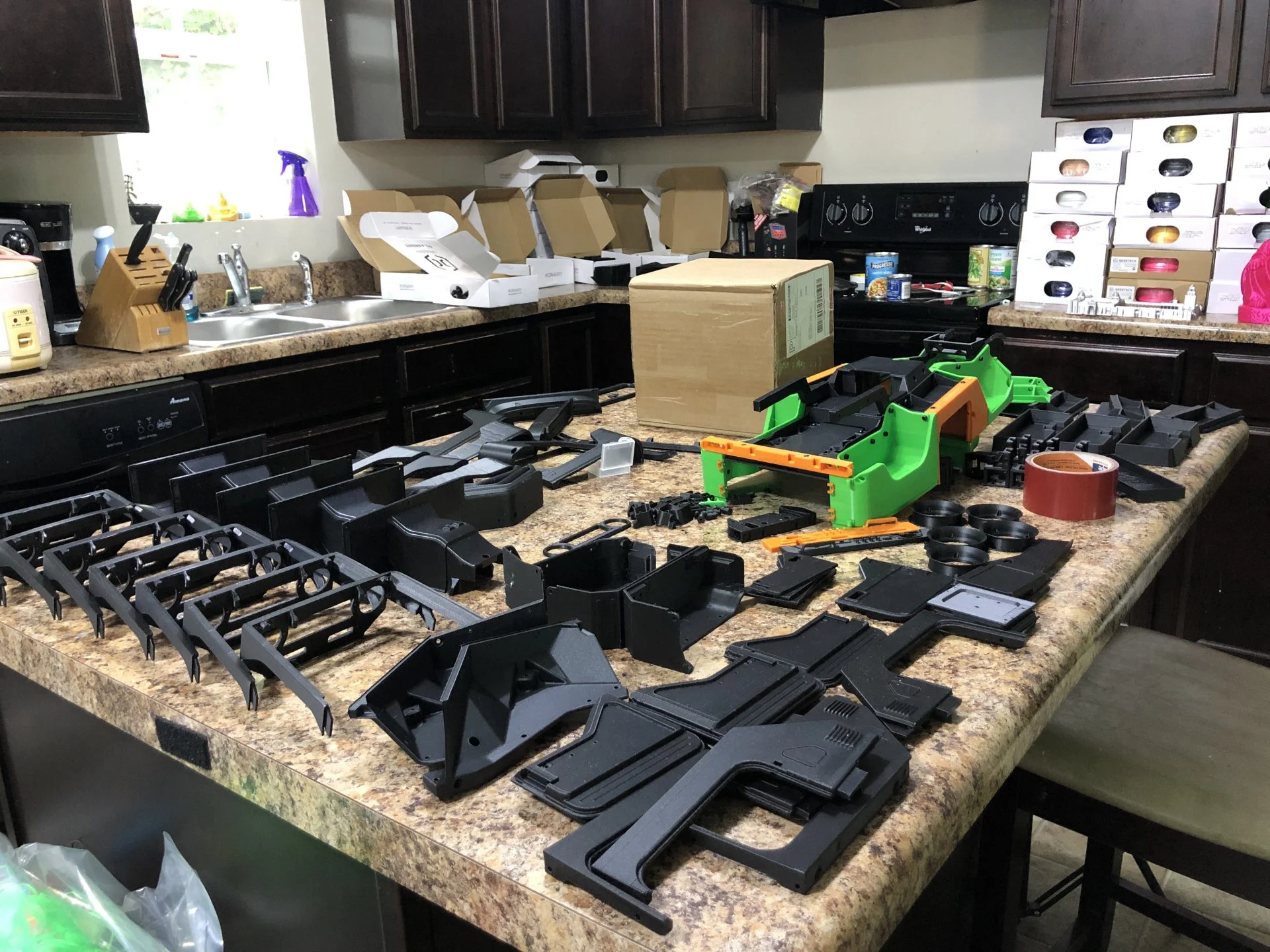

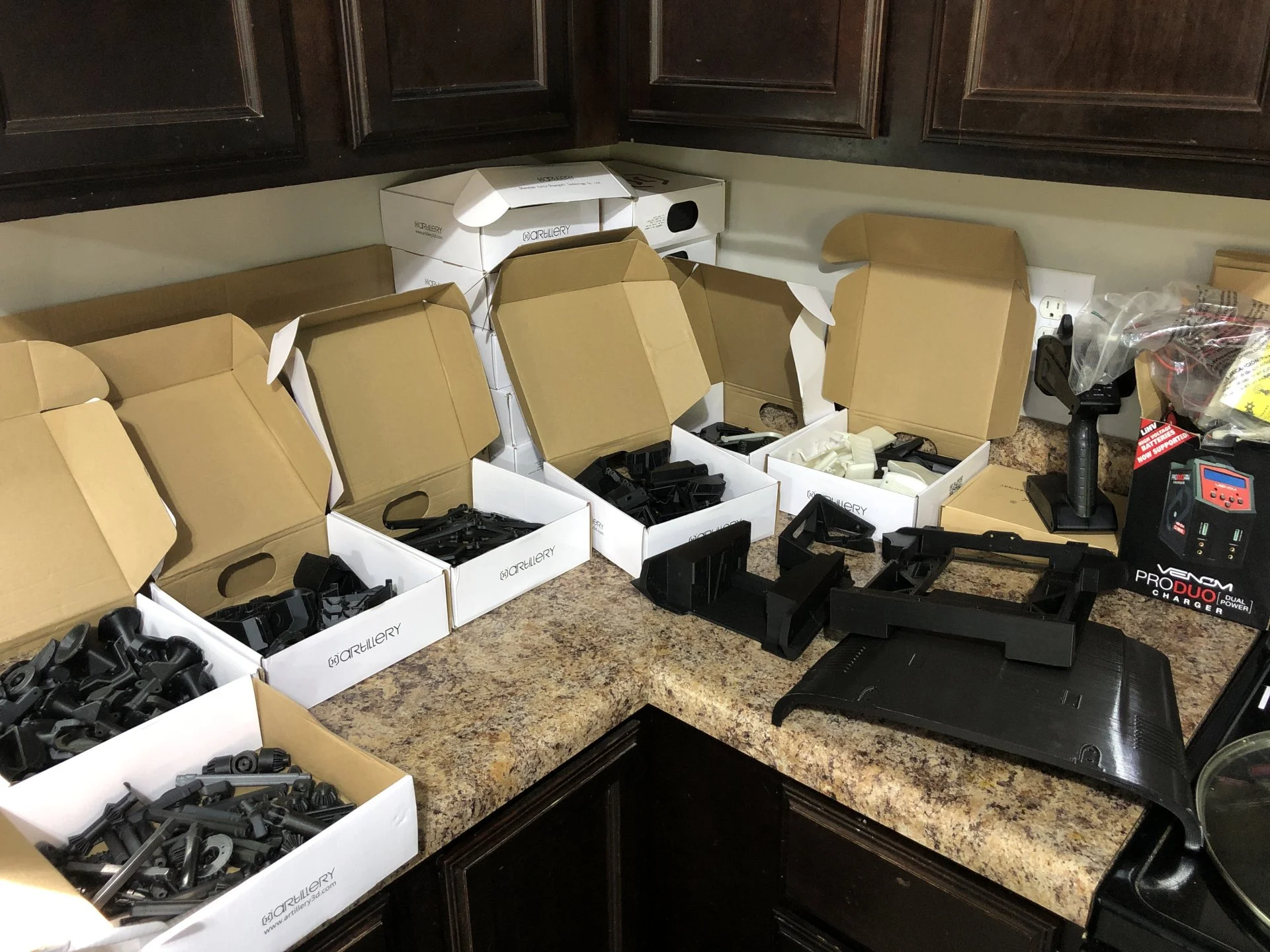

Trying to get organized.
I have a lot of “practice print” parts that will go into “salvage yard” and later you guys will have plenty of “basher” parts that you can thrash and not feel bad about it. They are structurally good, but aesthetically imperfect.
Alternatively, they can be made good with some post processing; sanding and paint.
Maybe I’ll do some no reserve auctions/lots on eBay for fun, and someone can build one from “scraps” for dirt cheap.
Not something I’d give to you guys for the version that goes on your tabletops and shelves.
For these, ask for “basher” parts and they’ll be a fraction of the price. Again, you guys/my beta testers do not need to worry; you break something you let me know and I’ll ship out replacement. The pricing stuff is for those interested in buying a kit or parts later; when I am ready to offer them for sale.
Also, building a printer this week and maybe next, so about to be super swamped. I’m trying to get some printers up for ABS, for the DIY 200 series cup holders for mud; and after cup holders I foresee some beautiful scale ABS FJ parts!
Good thing the boys can work in the background while I work on other things! They are working on rear side panel and wheel well; in PETG at the moment but you guys will have options.
So updates will be brief this week, and likely just photos. Let’s be honest we all prefer that anyways :D.

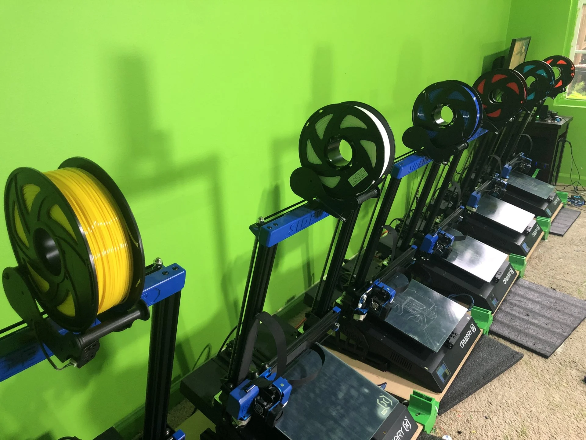

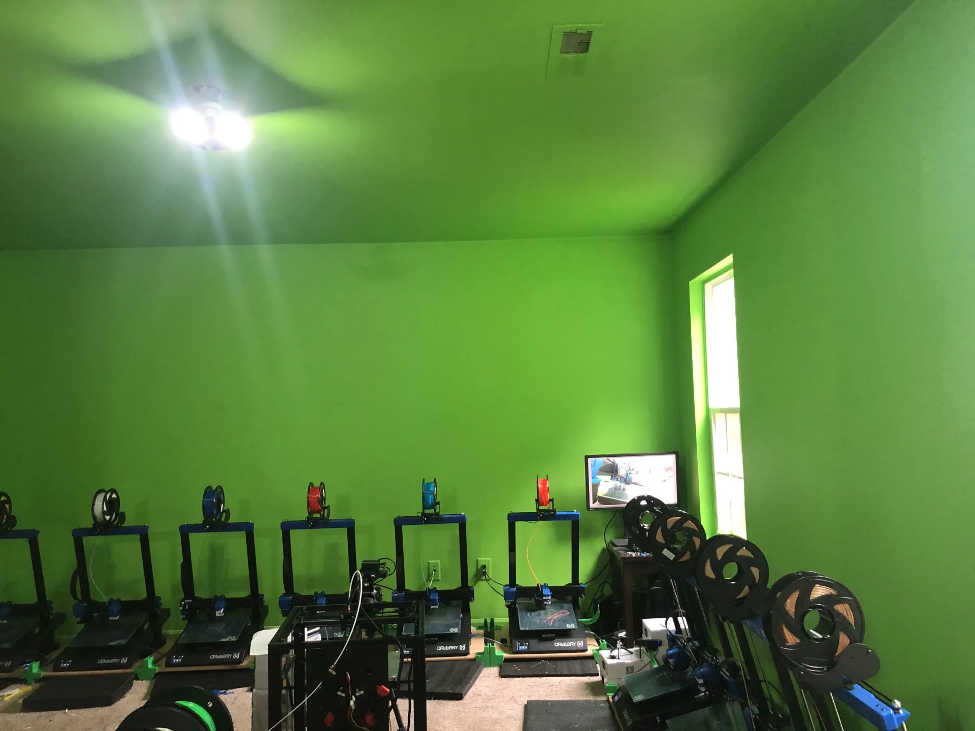

Meet some of the boys! They are a part of a fleet of Sidewinder X2s I got for $350 each, and added automation on top. I can get anyone a 25% discount for the Artillery lineup of printers by the way; for those who want to print along, I can give you all my settings. I plan on sharing settings in a separate general 3D printing thread, after I am more tuned. The tuning is never finished by the way, but we do get closer to something we can be proud of with each day we spend.
The names of the printers are on bottom, who they are currently working for is top; I don’t have everything properly color coordinated yet. Custom color requests will come when budget allows for it; still in test printing and beta stages. I also labeled them a while ago earlier In the thread, not everyone’s names are on here; I’ll get to it.

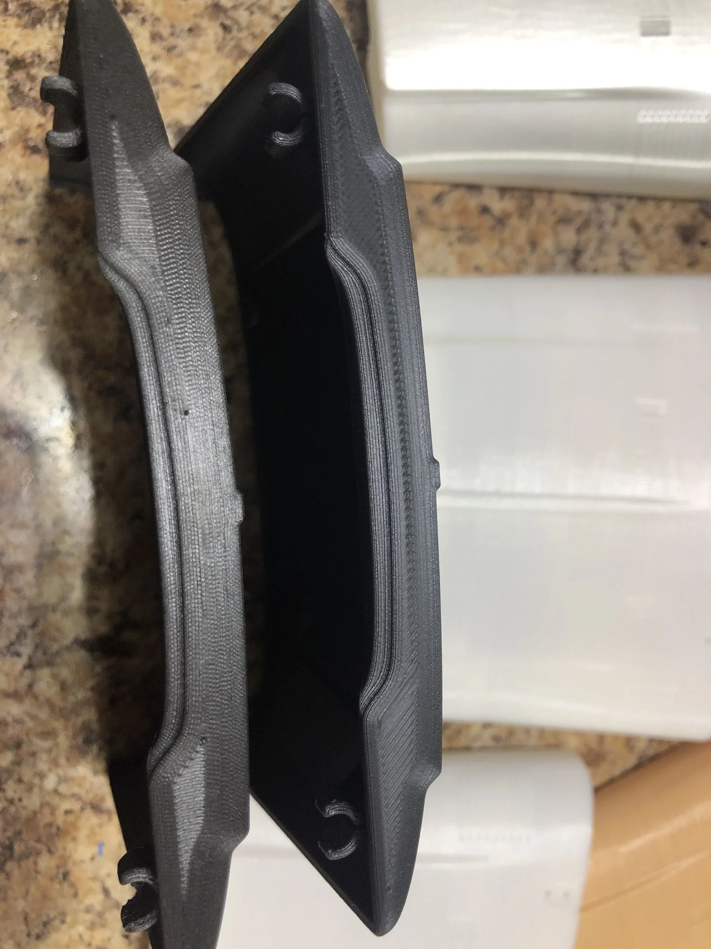

This is why we take the time to fine tune:
Teal is first batch this week.
White is second test print.

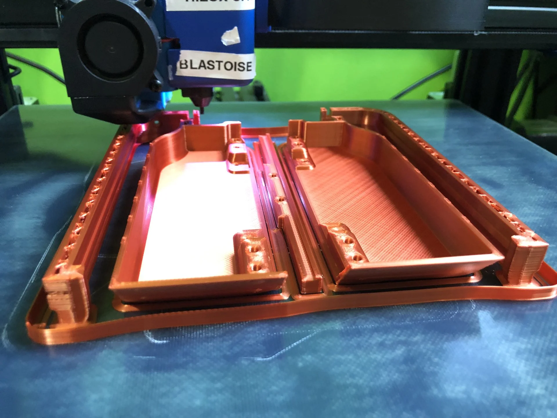

Check out the red copper color on current prints! I was going to wait til they are finished tomorrow to share but these metallic colors… man… I’ll save the rest for tomorrow/fingers crossed on current prints. I had a few fails already from the thin rear fender lifting off mid print; they print upright for best quality/no support needed, but it is the most difficult orientation to print them in. There is very little surface area on bottom to grip the fender to bed as it prints; in future I’ll be able to afford more corexys/non moving beds and that’s where we will come closest to perfection.
