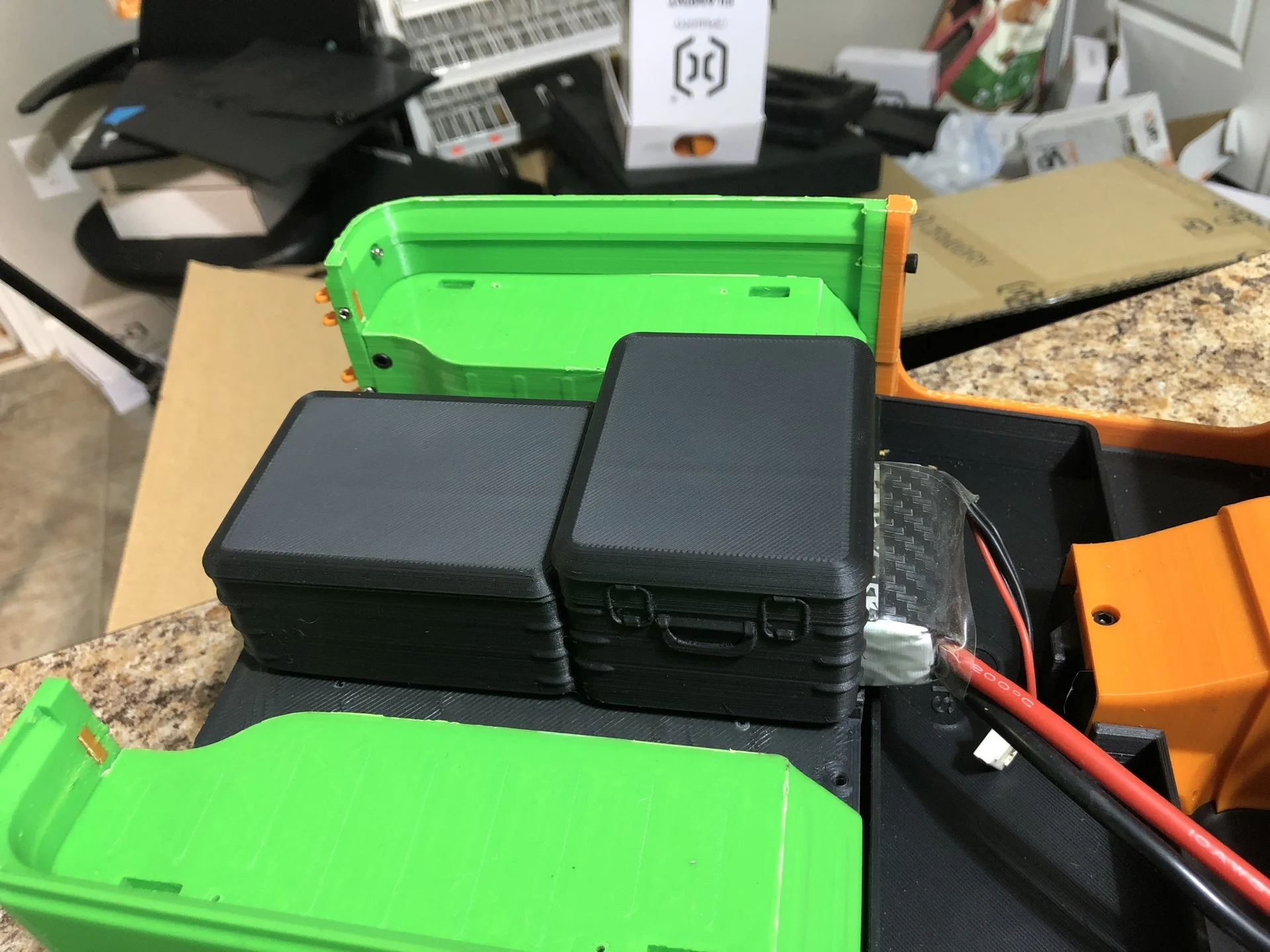

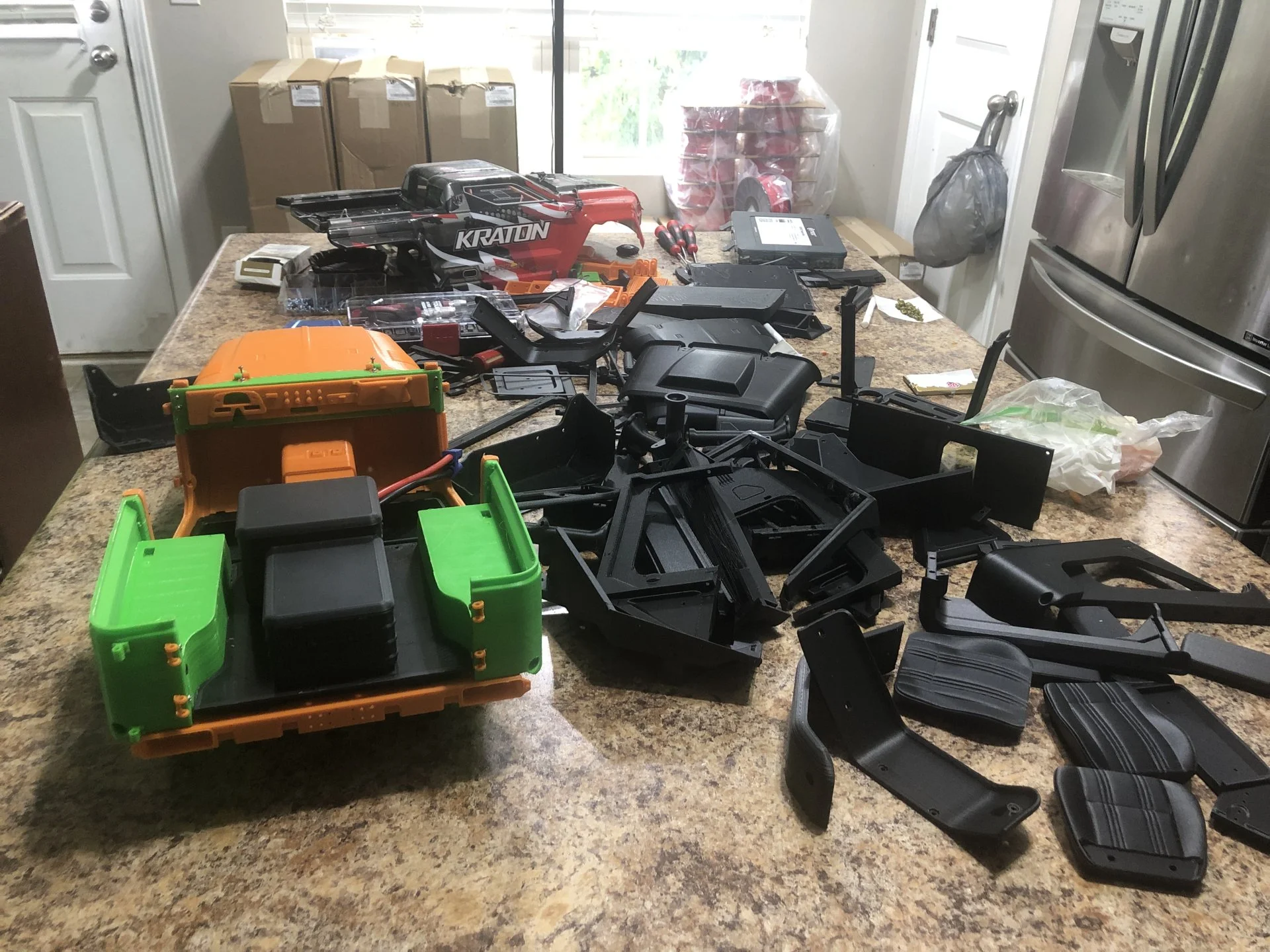

Been busy cleaning and preparing to ramp things up, FYI.

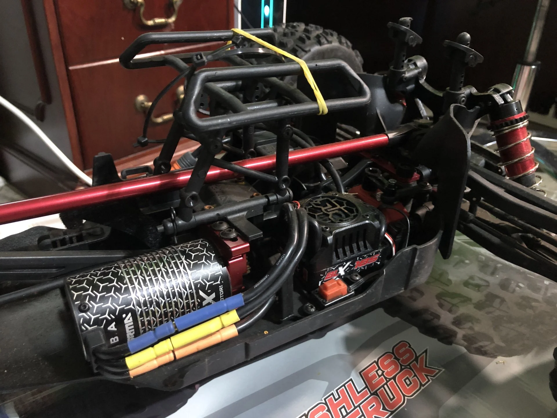

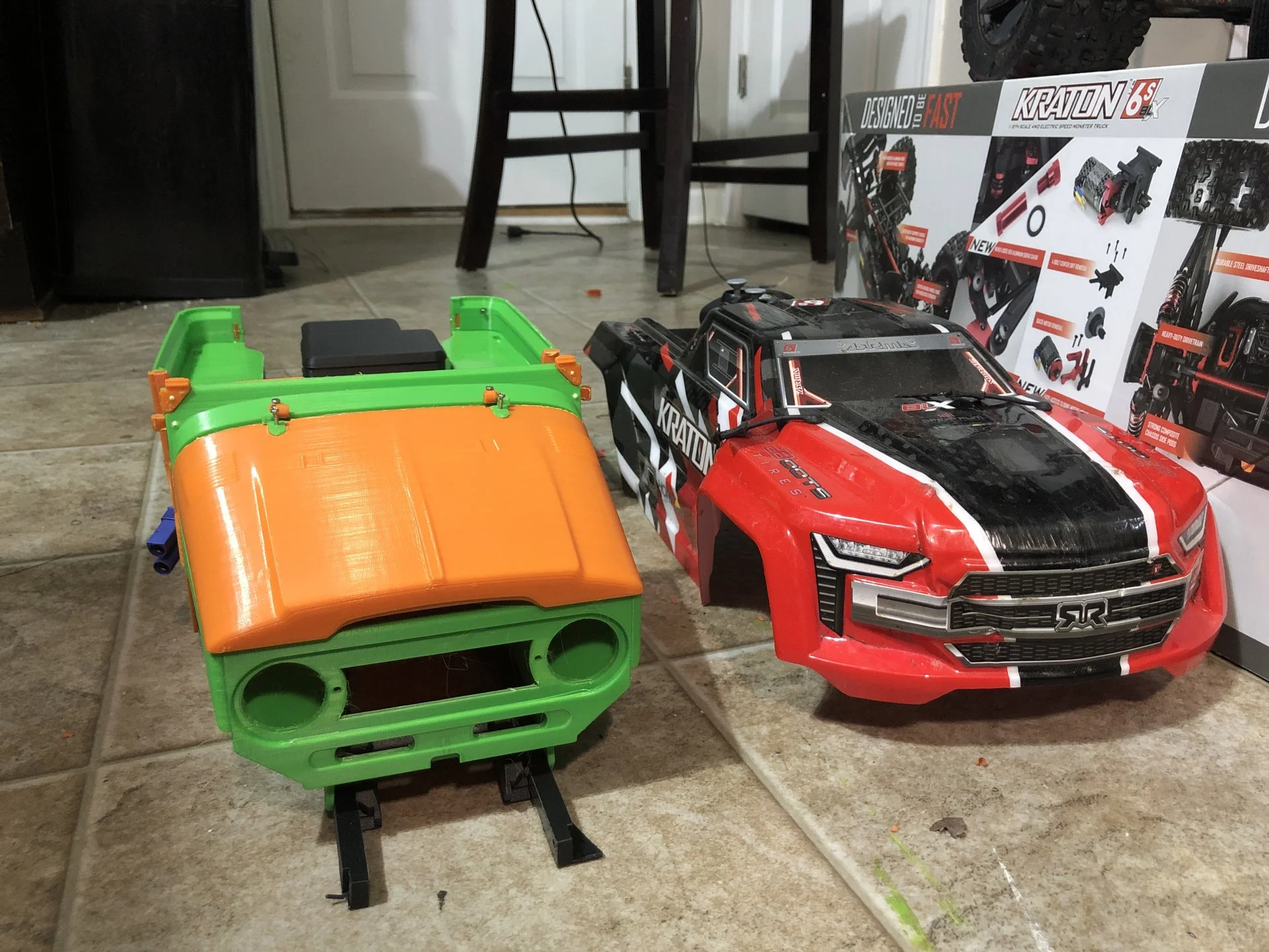

I returned the unworthy donor vehicles, and will order a proper set of electronics.
Factory recommends 1:10 scale electronics by the way (3S). I have my old Kraton 6S buggy my friend donated back, and the 1:8th scale 40mm diameter 74mm length motor is way too big. It’s also high KV (over 2k) brushless, so its more for Rock Jumpers, not Crawlers. I’ll use these electronics later for a buggy build or for the 1:5th scale; unless I can figure out a way to adapt it.
We need some proper rock crawler motors, and I will work on it this week. I have most of the other pieces; just need to resolder/remake some wires that melted in my friends shed for the Lipo batteries, and then I can see if they are still good. I have enough good parts and just need to swap good cables over to the good connectors with proper connections.
I’ll also order shorter and taller batteries that fit the battery cover better/will look into adapting for different battery configurations (like 6S) for future.
I will also slowly introduce different body/interior color options. For now chassis/suspension/drivetrain will remain black as long as we are doing carbon fiber, in both PLA and Nylon variants.
This is the last time you’ll see her like this, as the carbon fiber body parts are going to get swapped on soon.

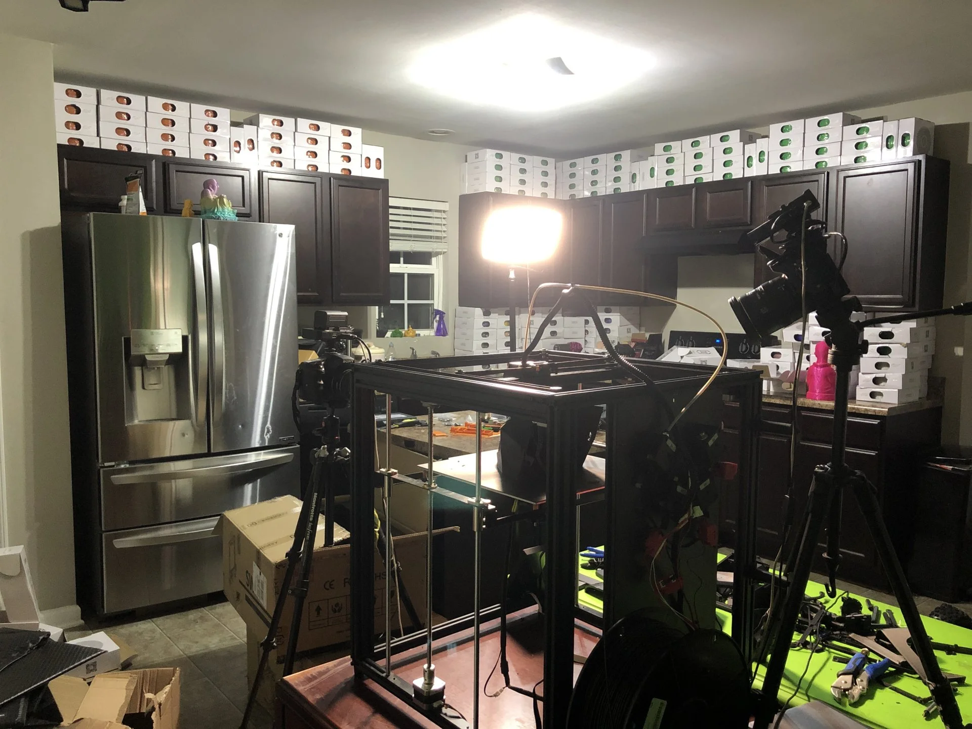

Anyways, back to cleaning up kitchen and living room to prepare for ramping up production. I know, I had to sacrifice the microwave for more space.

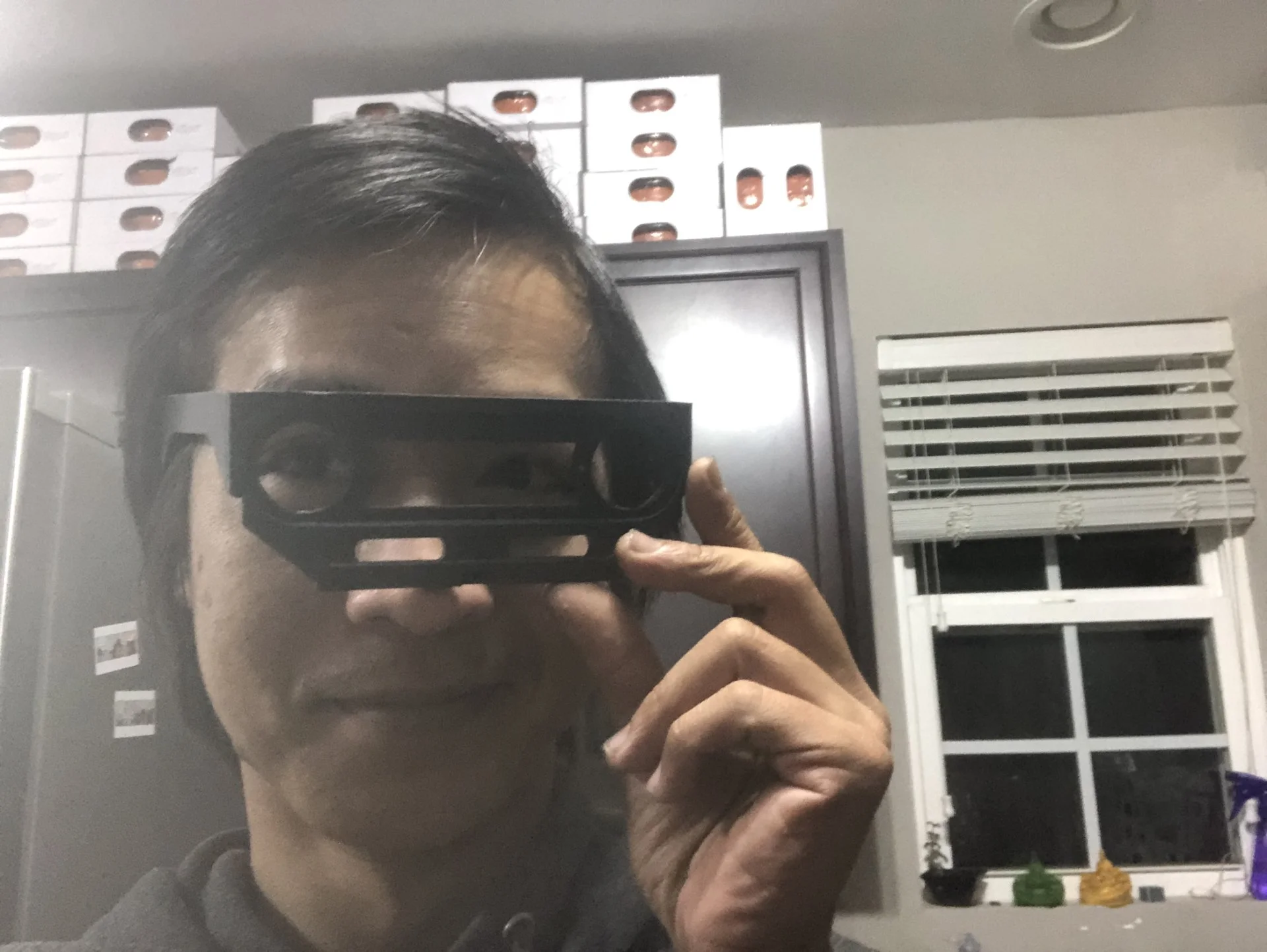

Fitment testing update: the lens need to be moved in a little bit to better match the distance between my eyes.
Seriously mud if you’re not wearing the FJ40 glasses at next years meets, you’re not a true mudder. There I said it.

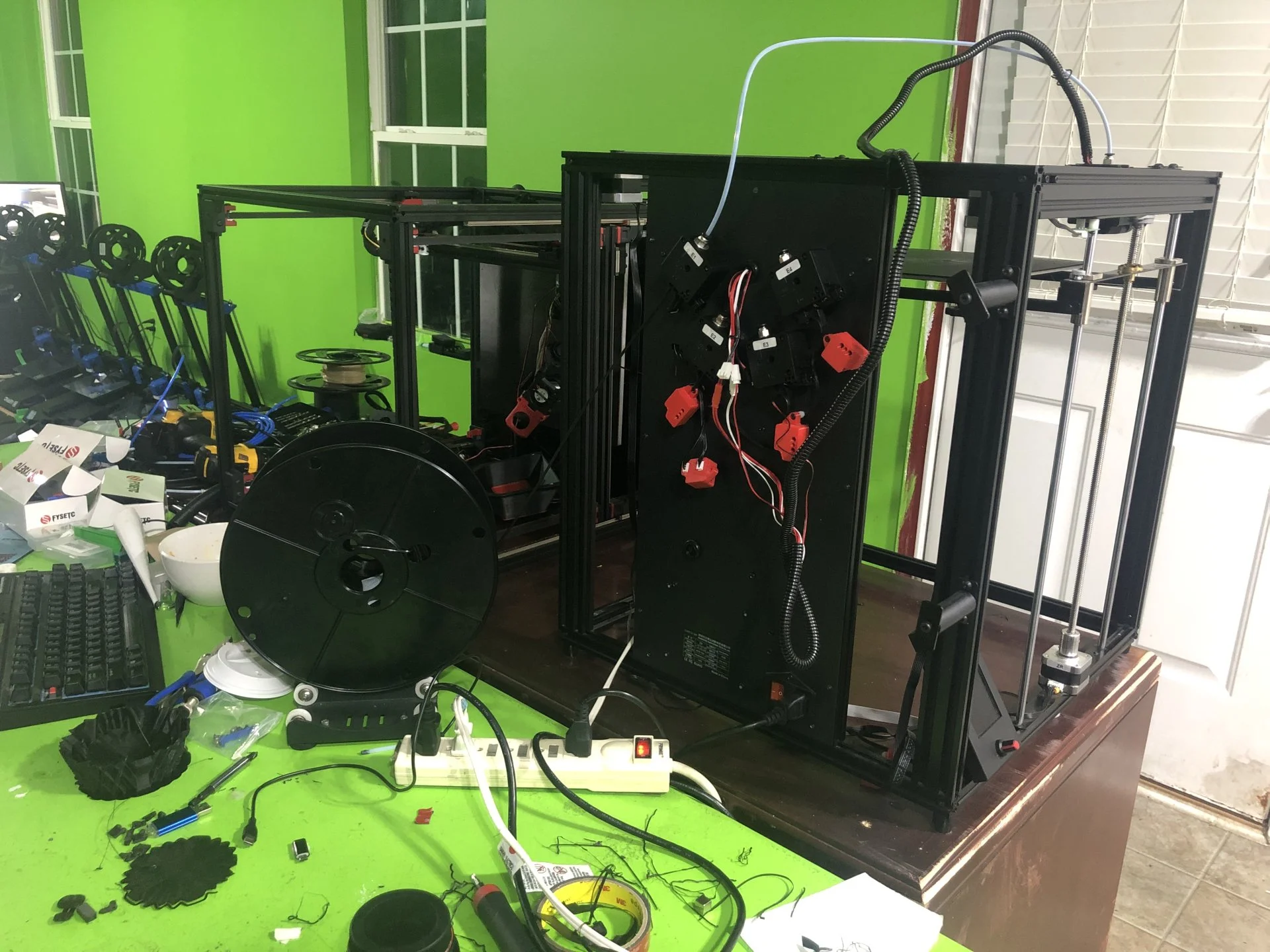

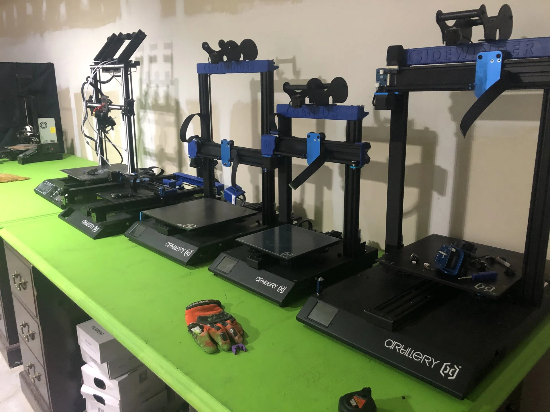

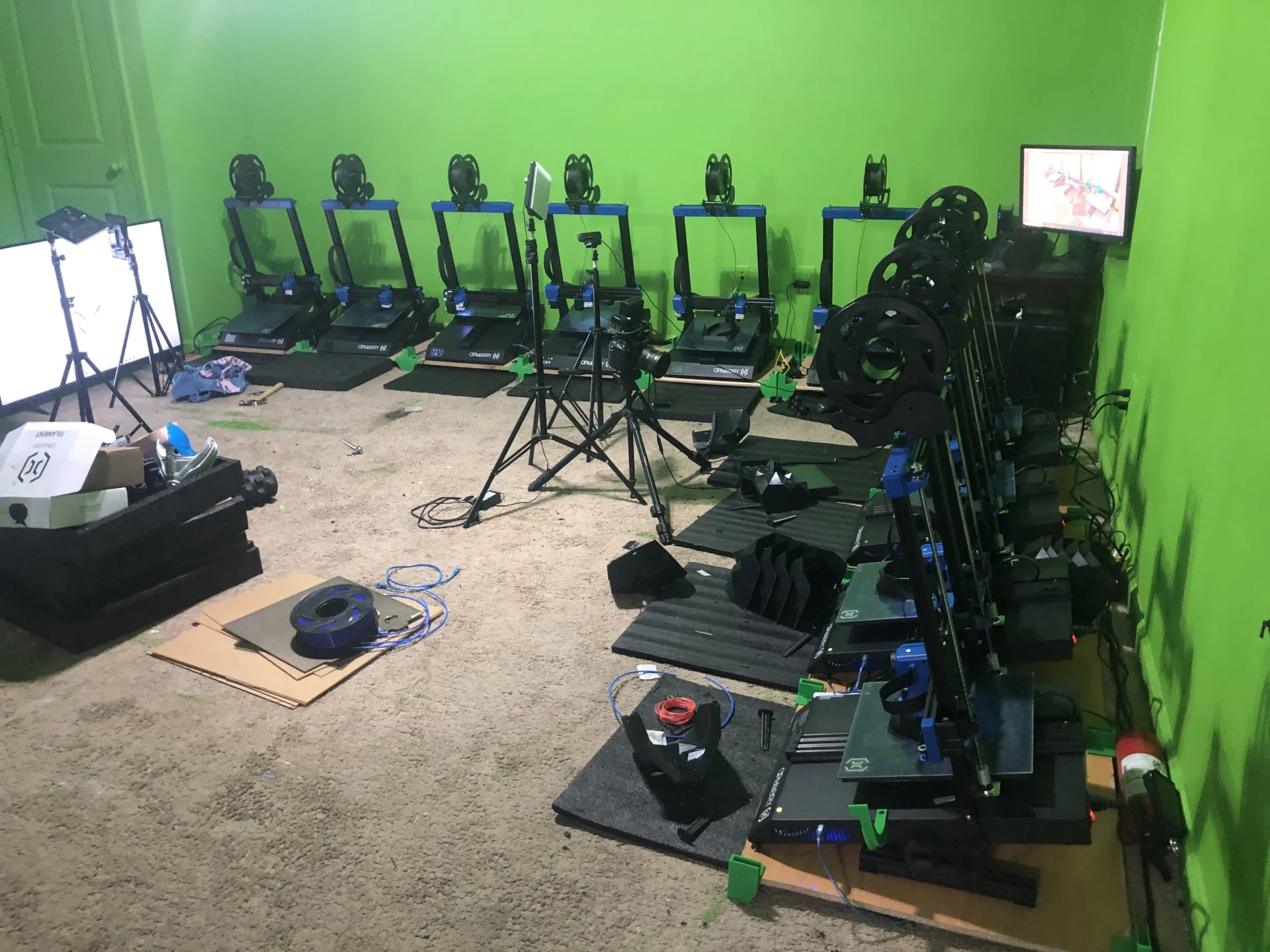

I’m still cleaning up house and doing some fine tuning/calibration and before we can make some quality parts in other colors. I have about 10 more machines to fix, tune, setup remote management and then run test prints on this week. After that they’ll be handling all the small prints while the automated system handles the big parts (it’s hard auto ejecting little parts).
While I’m at it I am going to retune the Quinly Sidewinders (tilted one that’s been handling all parts so far) as well. I expect this process to take about 3 days, and is needed to make everything else go more smoothly from here.
After this week I should be able to sit down on one computer and control all 20 printers from my desk. Right now it’s a lot of moving around because I need to manually load the prints on half of them.
More importantly, the tuning is for quality for other filament types and colors. I haven’t shared any photos in other colors because I was not happy with the quality. That will change after this week.

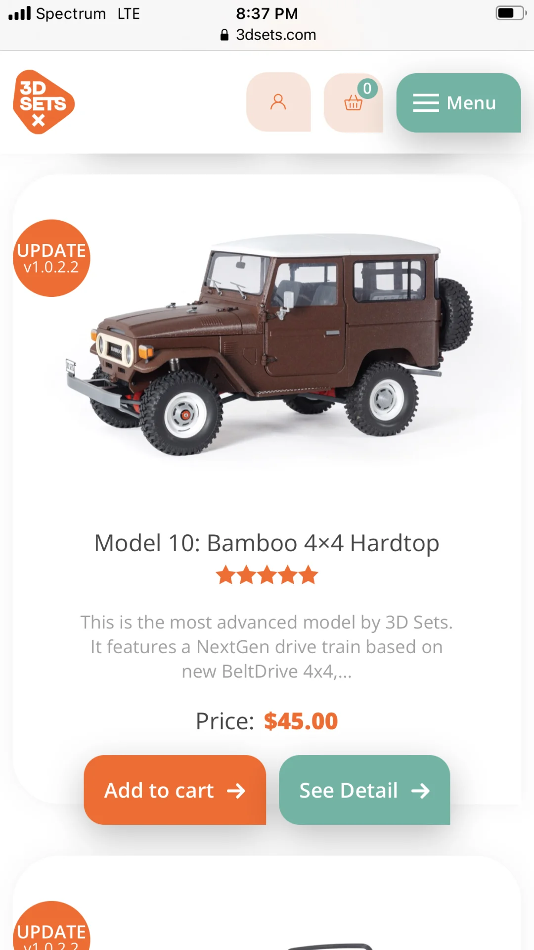

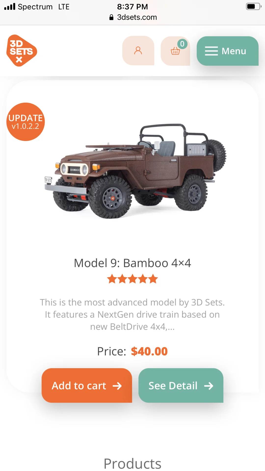

What scale is the 40 & 45?

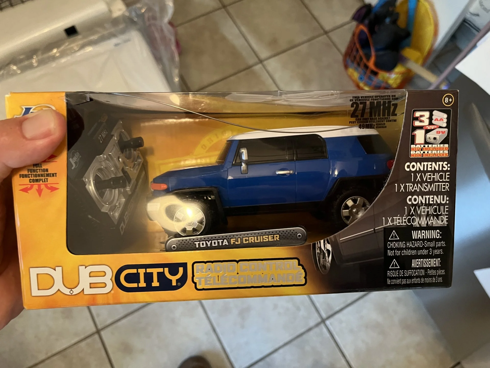

Not sure the scale of this, maybe I can swap the body.
Not sure the scale of this, maybe I can swap the body. View attachment 3046940

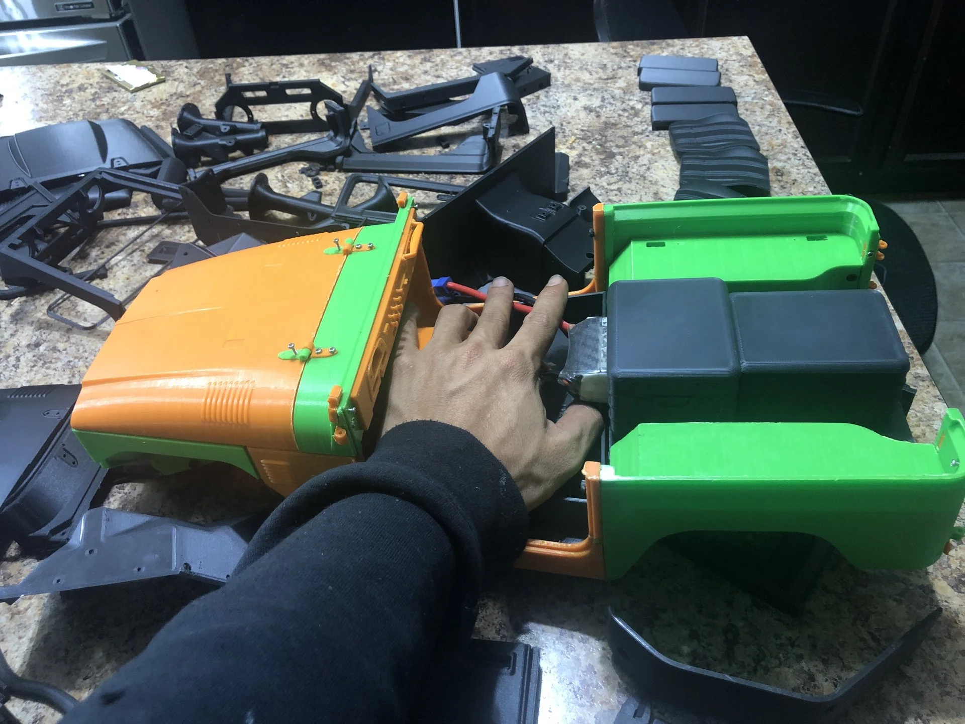

That is maybe a 1:18th scale or smaller. I know I have small hands but:
For the Landy mini 1:16th though, most likely viable.
The good news is it’s designed for 1:10 scale electronics. If you call a hobby shop and ask about 1:8th electronics, you’ll get scared out of the hobby when they tell you that you can’t go 1:8th without breaking the bank.
We are going 1:10 scale rock crawler electronics, and I will get us some options and will ship those out separately. I am researching still.

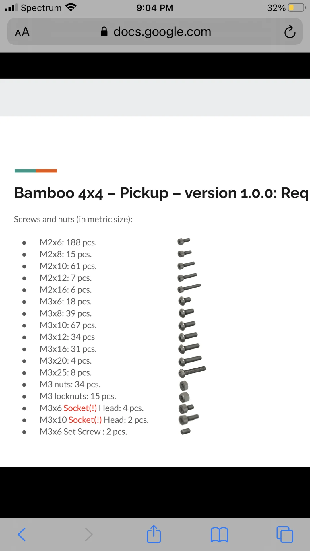

Also, just to drive in the scope of the project; I counted about 500 pieces for fasteners, with almost 200 m2 screws alone. For the 45.
I’m looking for manufacturers to get good deals for bulk fasteners for long term, I’m going to need it for a showfloor of these/mini mud museum. Also I’m going to need it to provide to customers when I begin selling these; a ways to go still.
