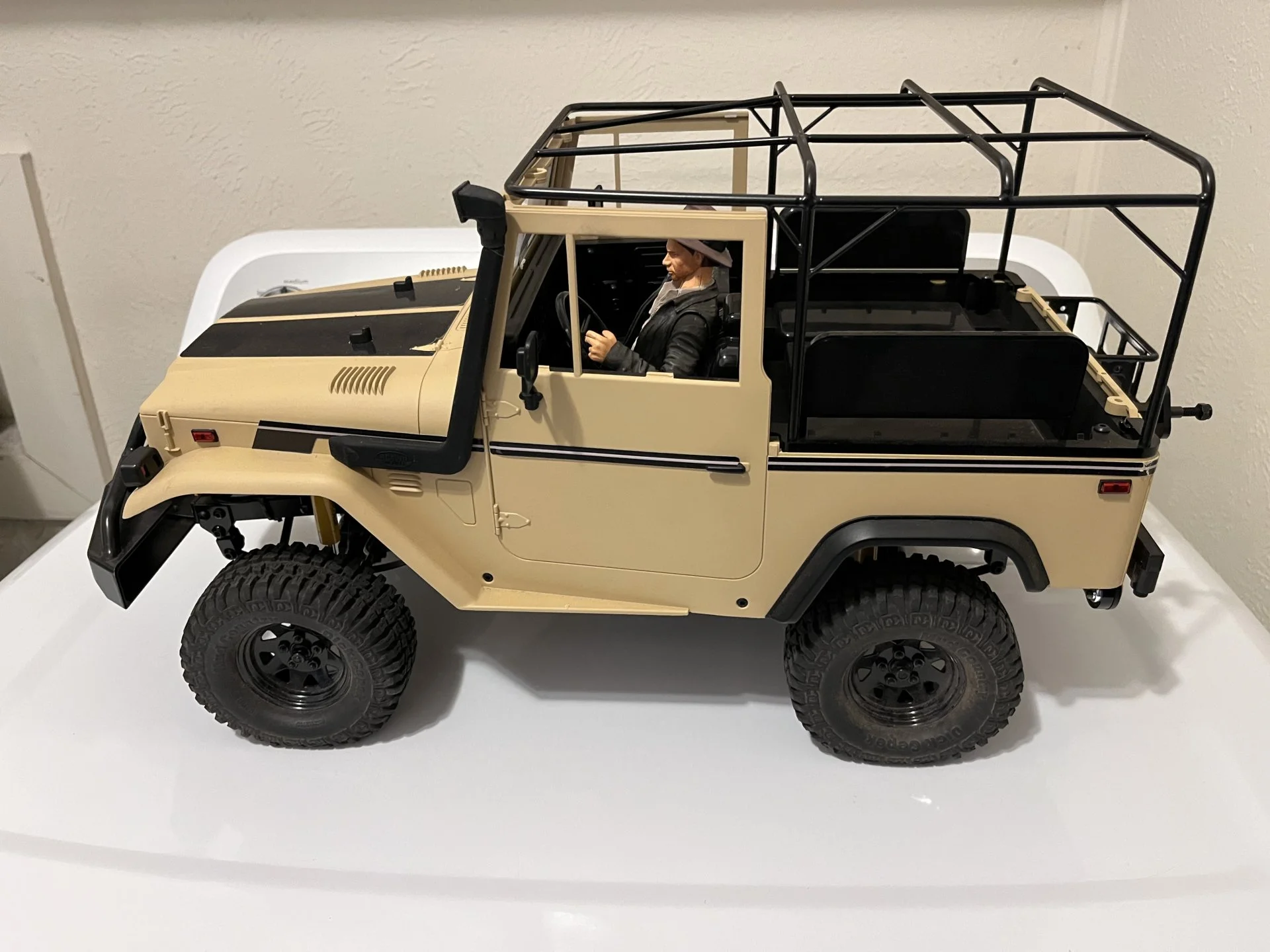

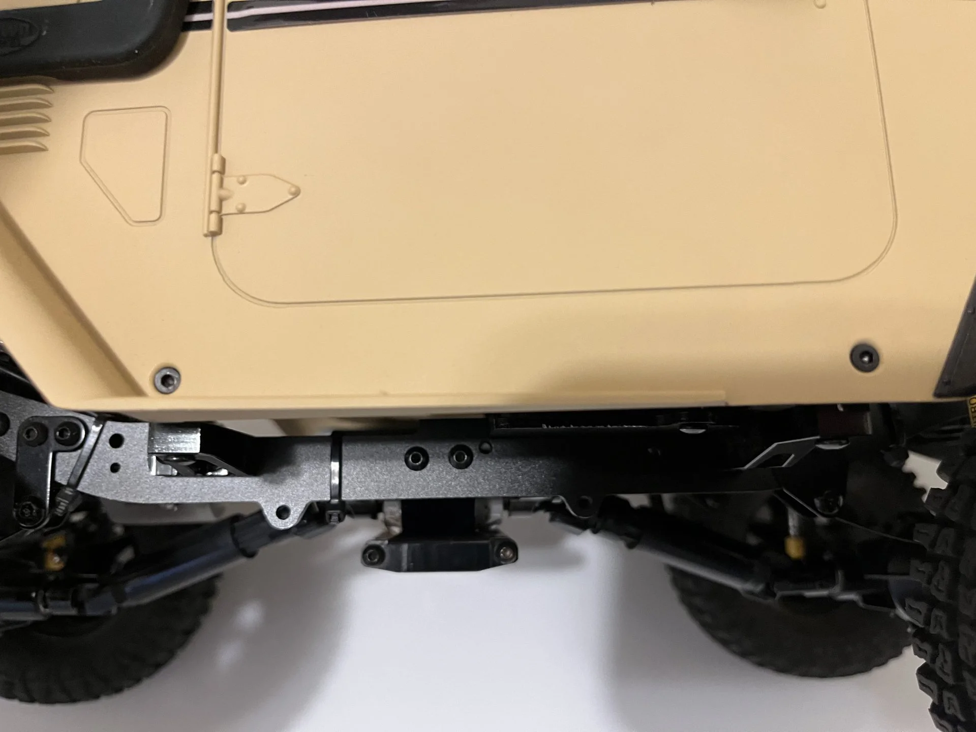

Looks like it’s about 55cm long, so it is on the small side for a 1:8 scale. Much smaller footprint than my Kraton 6s that is also 1:8.

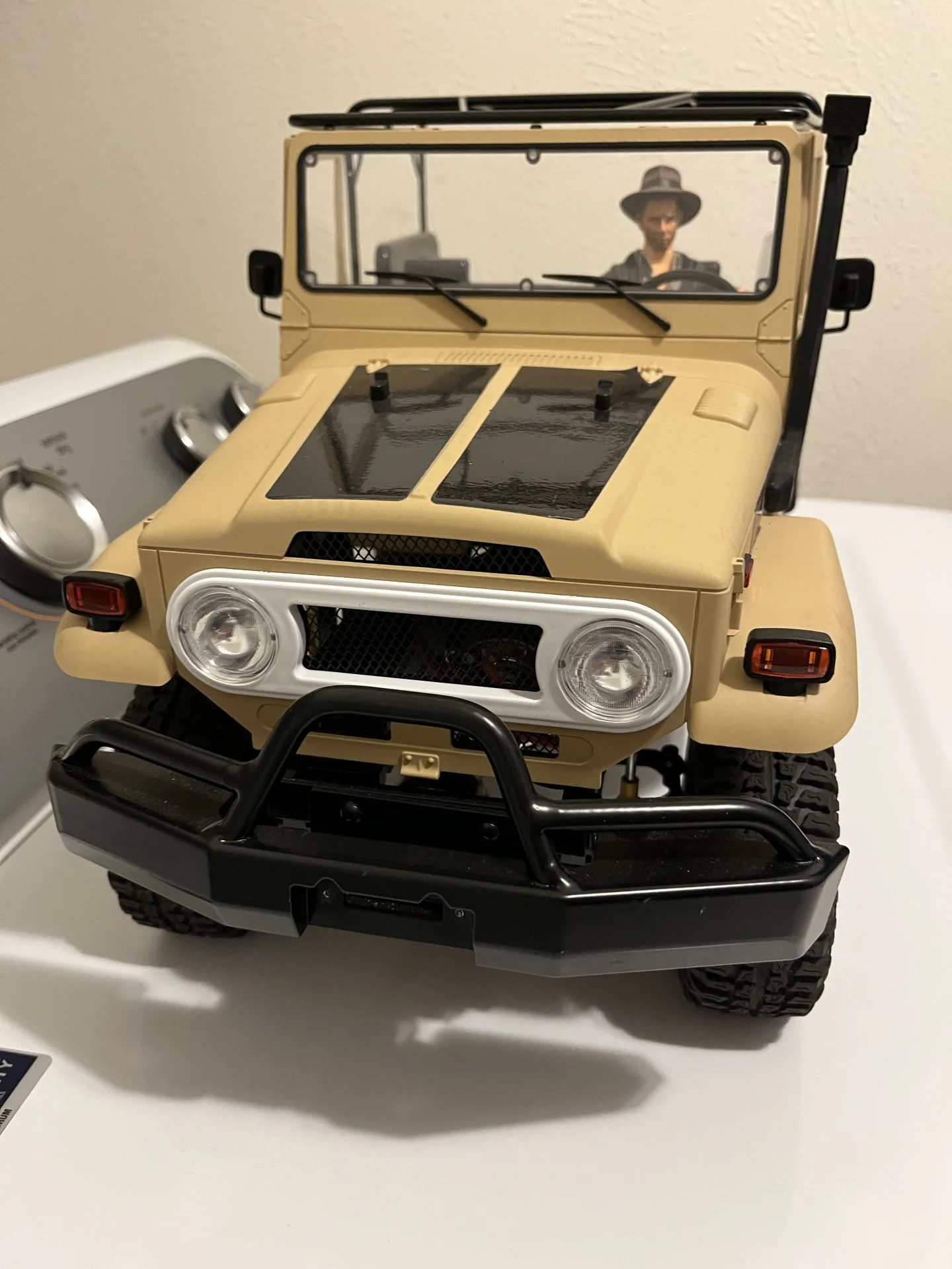

You are doing some awesome work! Would absolutely love a FJ-45 pickup whenever you have one that's not spoken for.

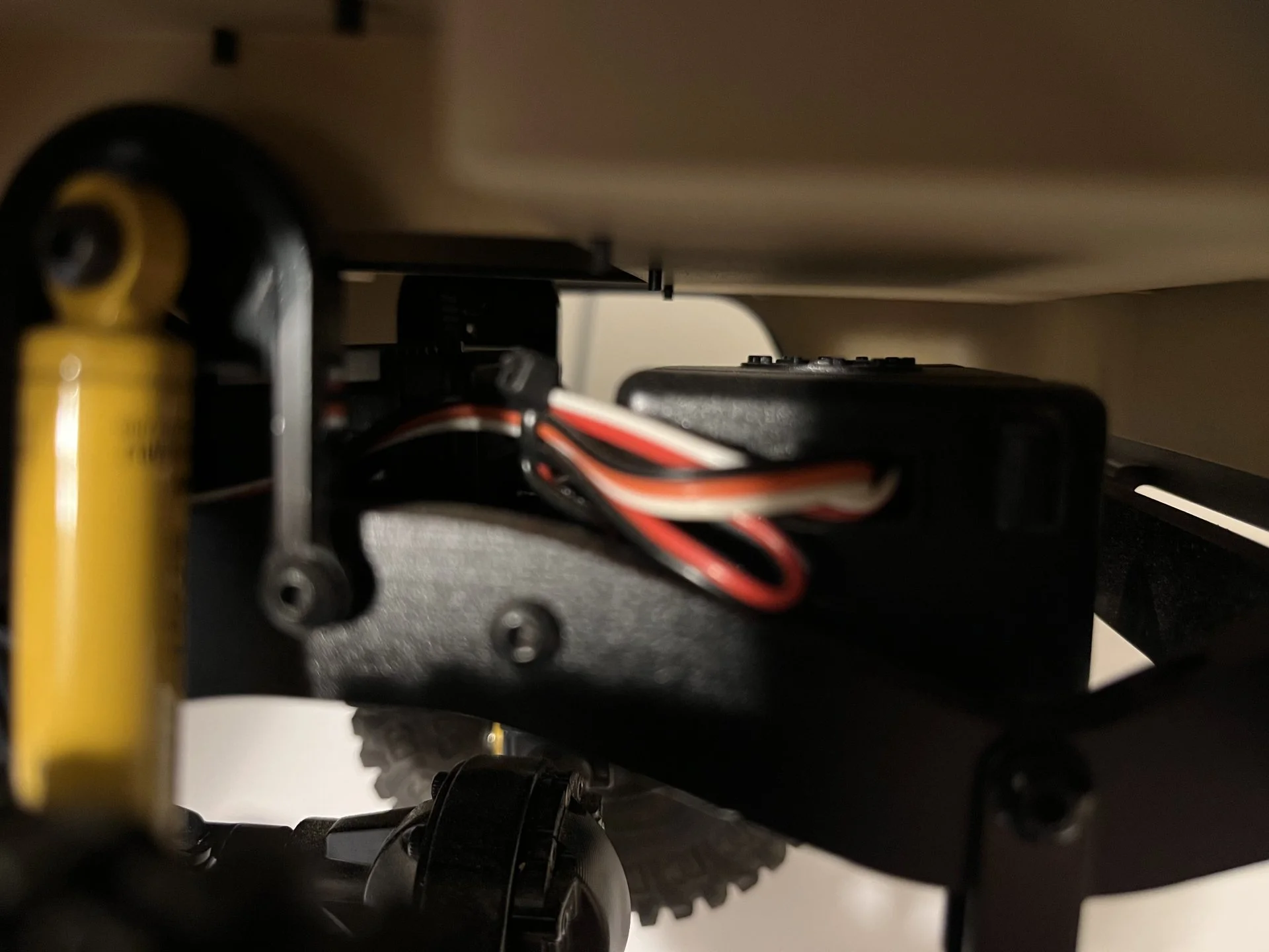

Here ya go. What else ya need? Need one with body actually off?
Few more.

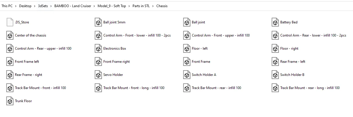

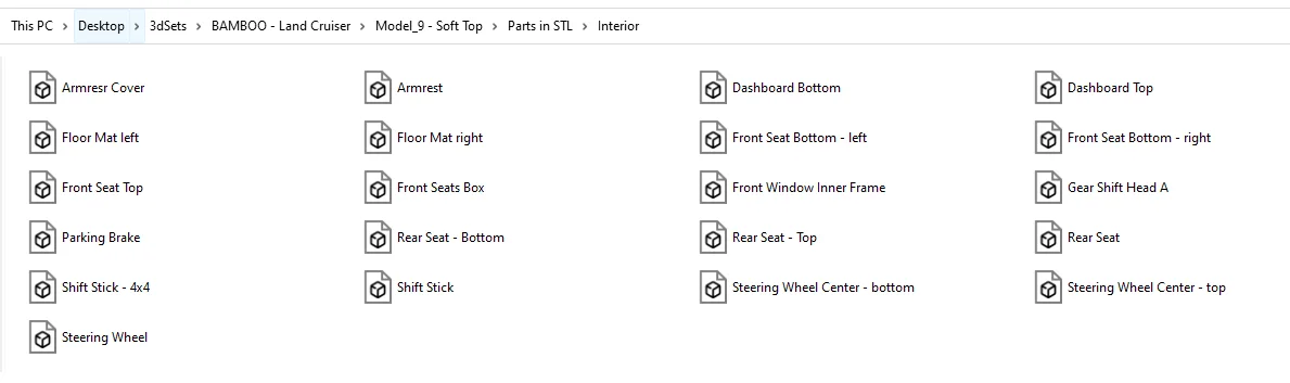

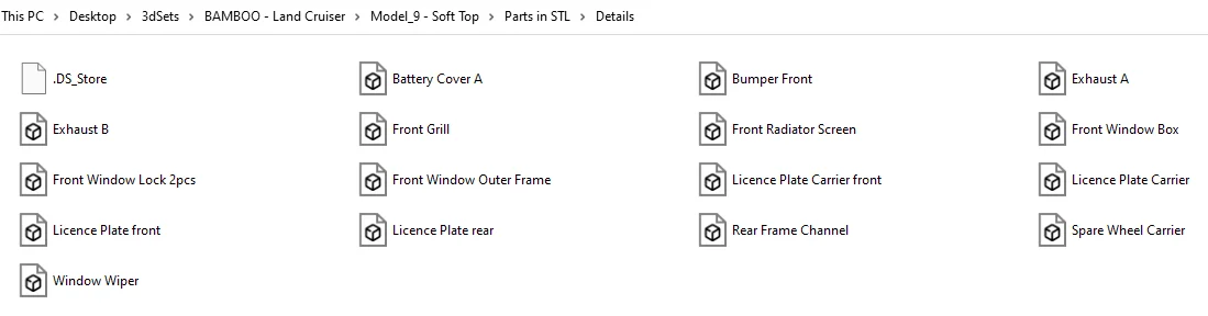

I’m trying to get organized and plan out my Print Que for this week/month.Seems the only and easiest way to do this is to make the full 40s, and then 45 as a add on package.
I tried splitting up the 40s kit to remove obsolete parts after 45 conversion, and it’s just a massive amount of work as it requires running all the files through slicer software/reorganizing build plates all over for hundreds (eventually thousands when you factor in other models); Versus just printing the build plates I already have. That and I like the idea of equipping you guys with all the parts needed to go back and forth; you will have spare parts in the form of a 40 for your 45, and vice versa.

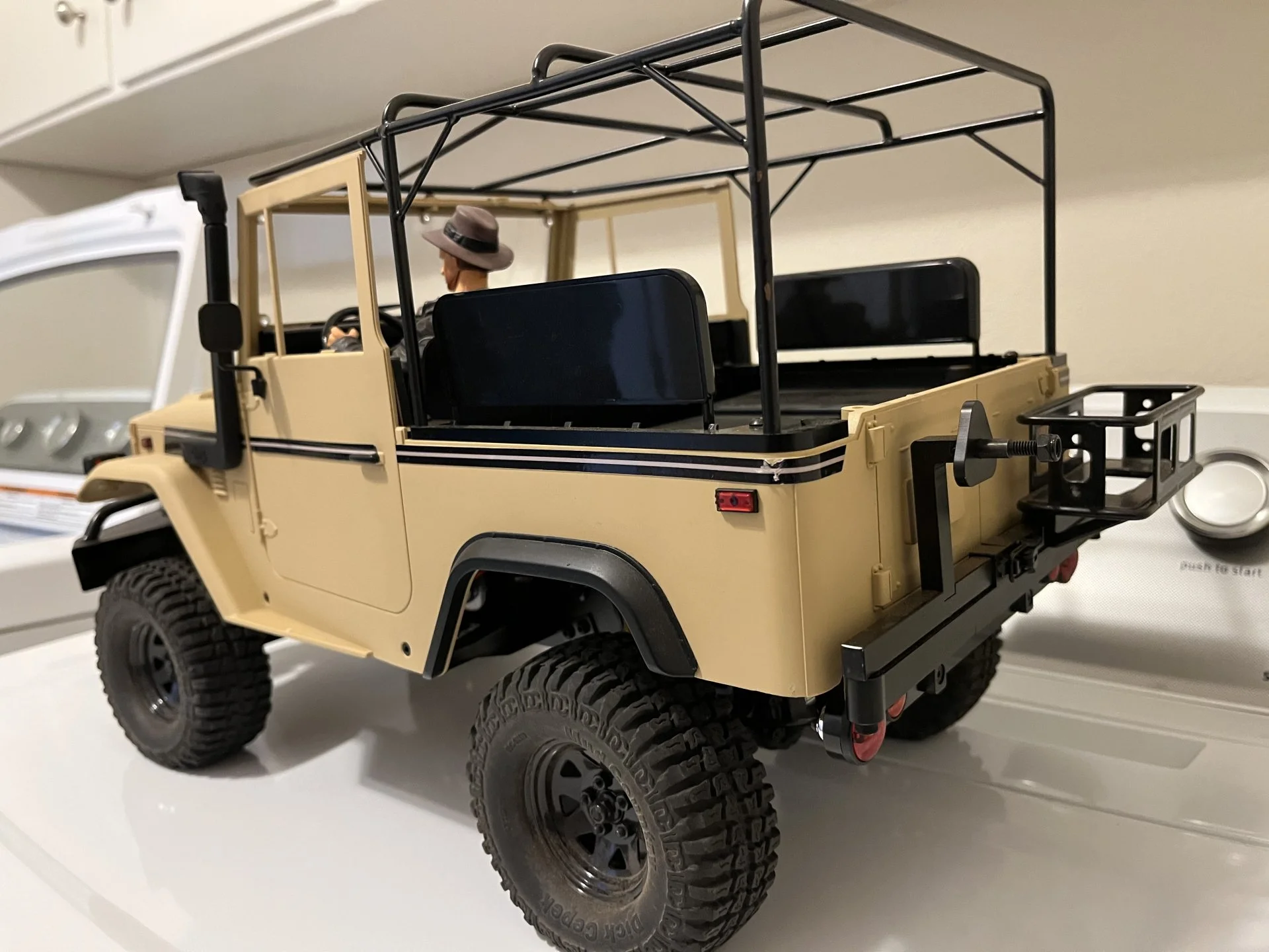

@glennjenn this is only white I have currently. It is a dim glow in the dark white. Should be able to paint over it no problem.
That’s the roll cage and seats. I am tuning for other colors this month as well.

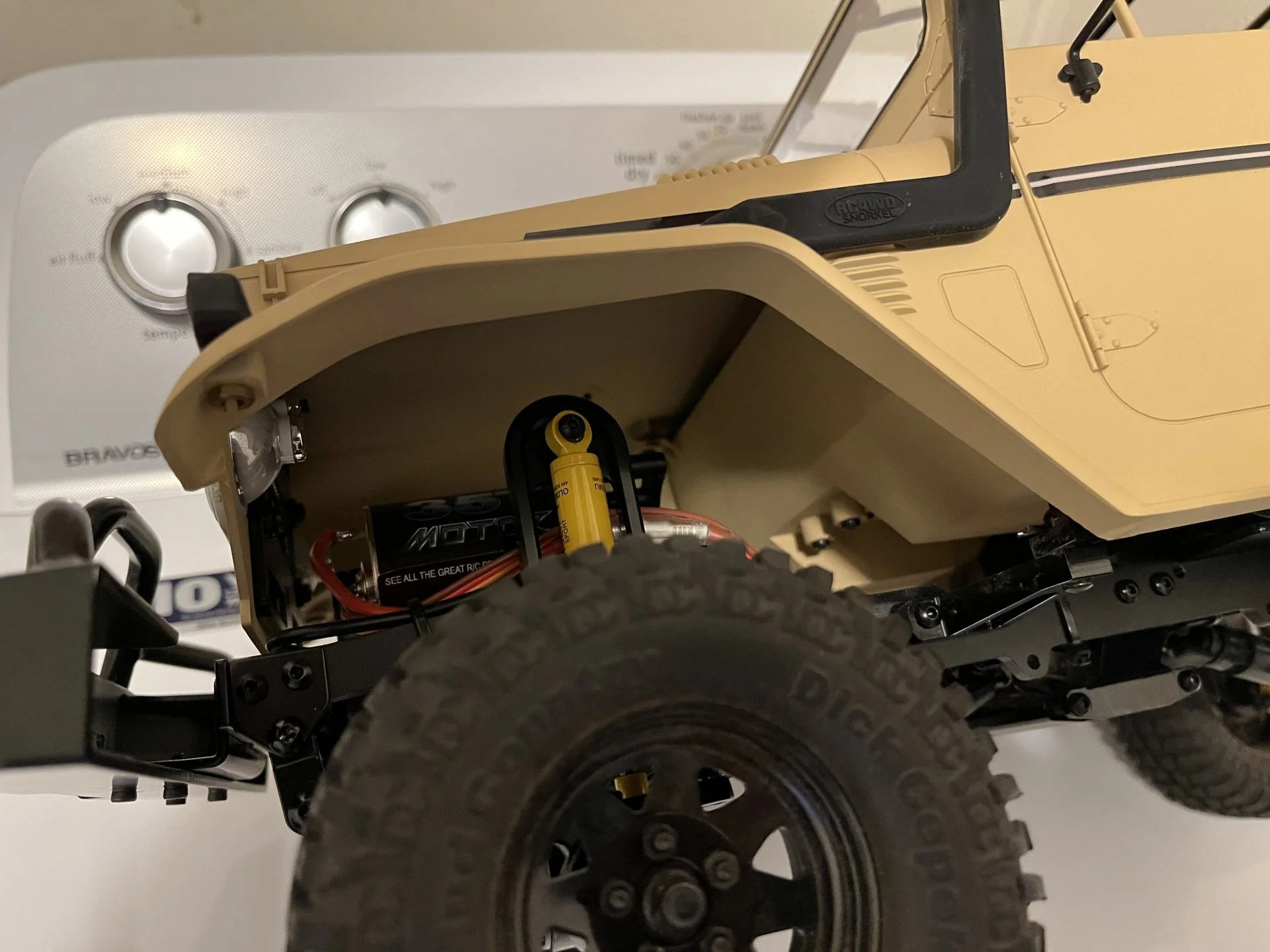

Another update for the first FLEET of FJ40s; I will be wrapping up chassis today and begin Body tomorrow.

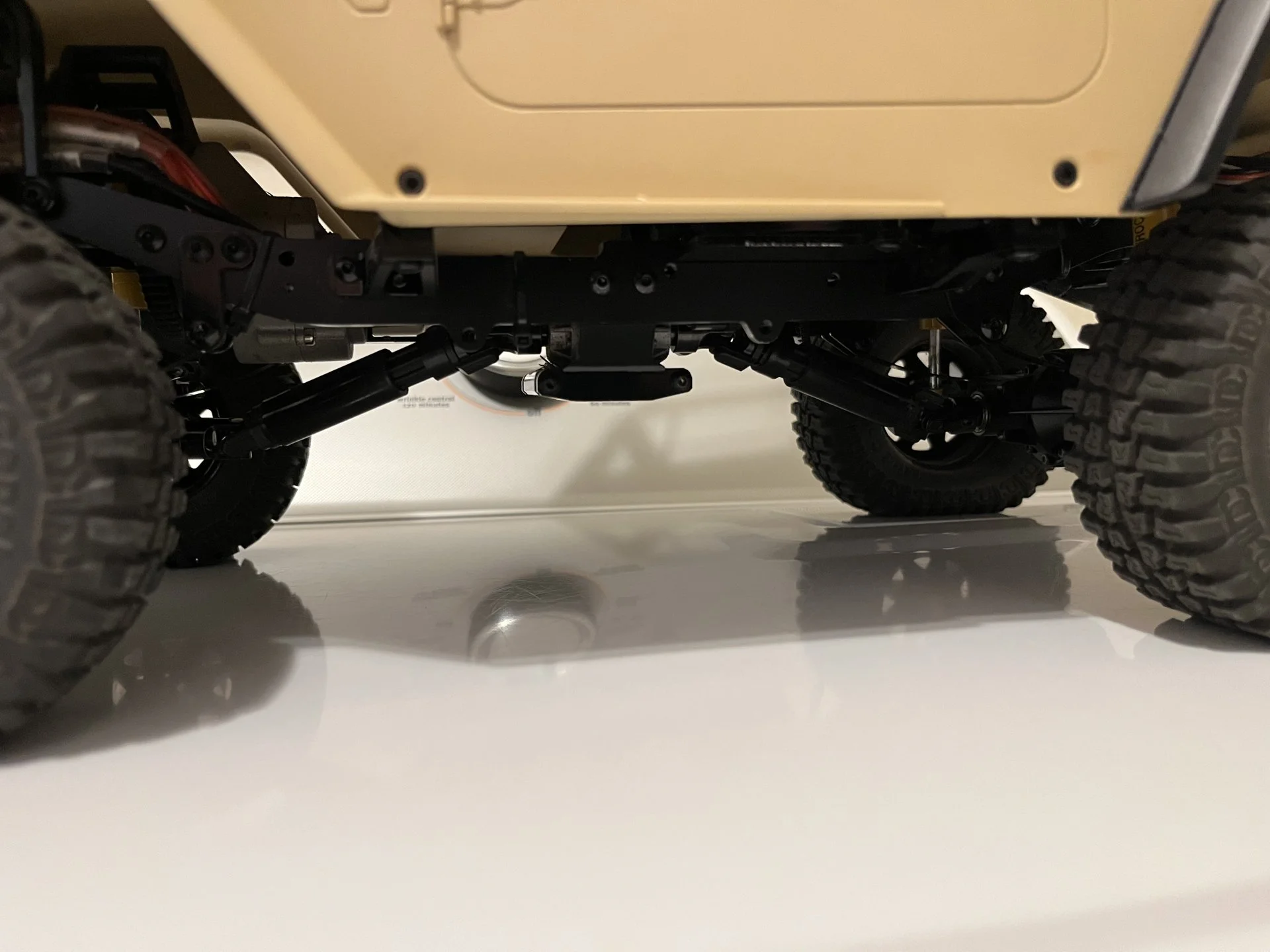

Suspension is after a week of making body parts.

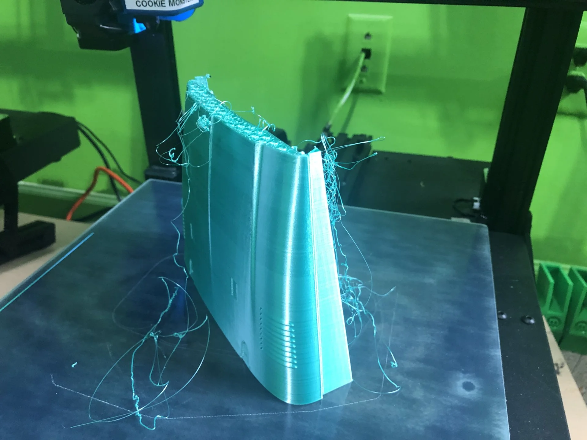

I found my stock of white, only problem is it’s in 3mm filament; printers are built for 1.75 nowadays. I just finished rebuilding the hotend and extruders on 2 machines, and am tuning, calibrating and testing 3mm now. This will take time; and some trial and error.

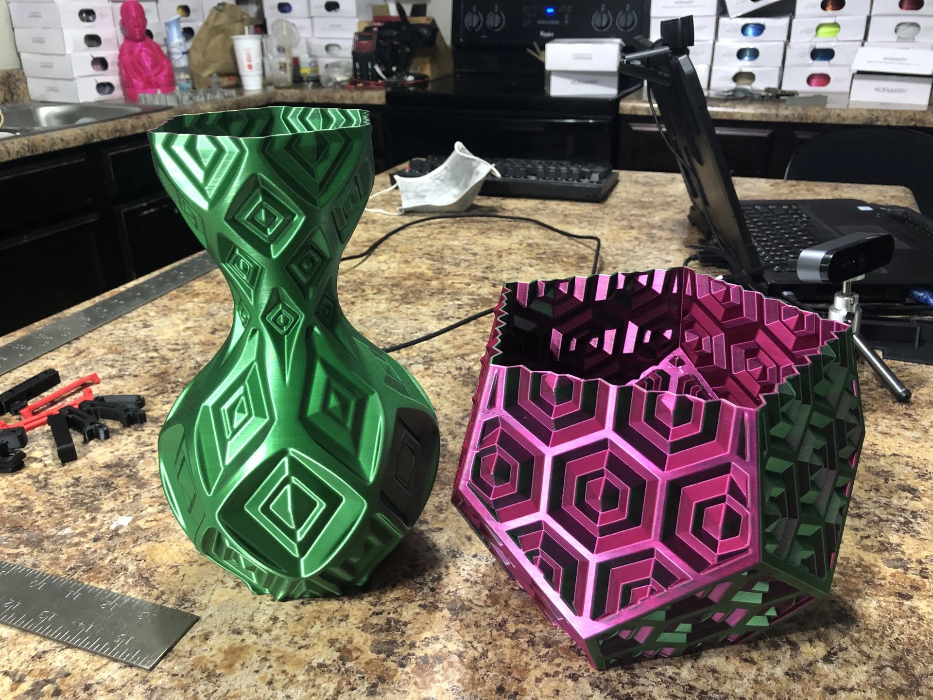

Lots of good stuff upstairs if I can get good at working with 3mm. Here is a couple test prints in Vase mode (easiest mode to print due to not needing retractions), using MatterHackers Quantum PLA (also called Magic PLA).
An FJ40 version that changes colors as it passes you by ;)? Yes Please.
Anyways, 3mm filament and bigger nozzles will result in thick and strong parts, but not as good on details on very small parts. We will slowly incorporate it into our builds.

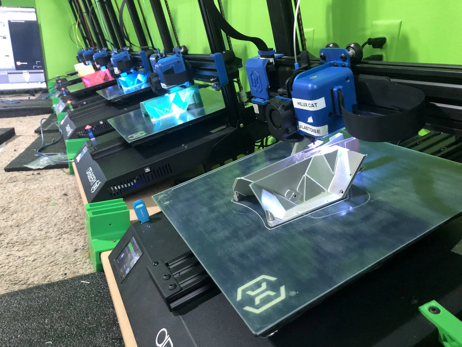

just woke up from my nap to find these waiting on build plate! Everyone needs a 3D printer so they can wake up to Christmas every nap they take! I do plan on making a 3D printing section soon, to help mudders get started. I am an volunteer but also authorized reseller for a few manufacturers/can operate most printers out there. Just let me know if you need some help and ill be glad to assist on that front.

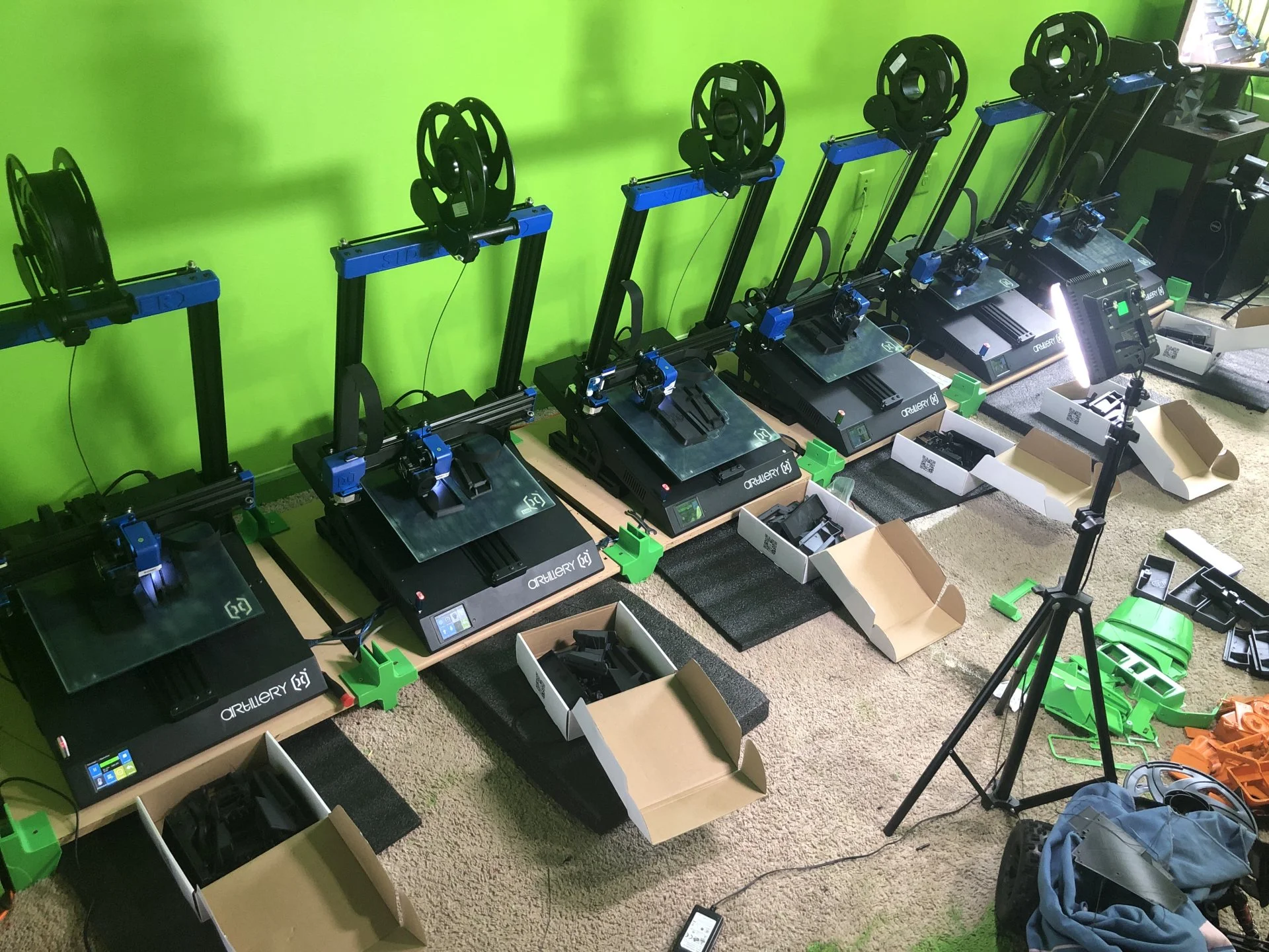

Anyways, back to not getting ahead of my/ourselves: this is build plate #5 out of 36 for the first Fleet of FJ40s; soft top edition.

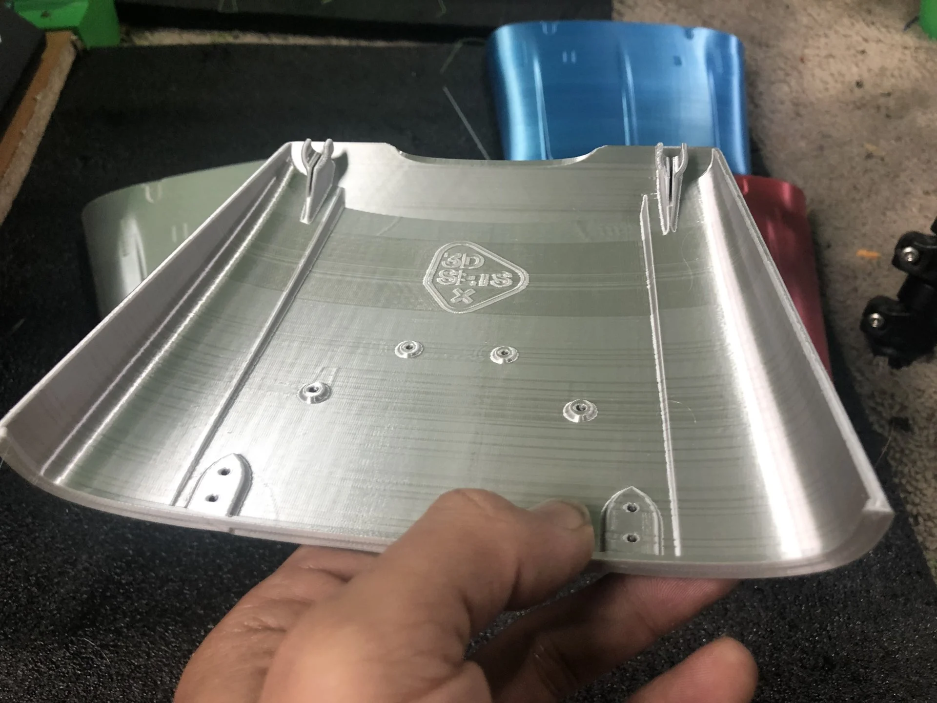

More body parts incoming, I’ll throw in the Bonnets today (we call them Hoods).
Also, I have began experimenting with ABS parts, so expect some ABS to get thrown into the mix where it makes sense to do so. KVP sent me a bunch in Voron Red and Black; and let me pay later! Good peoples over there.
Last photo is so you don’t confuse the silk white with the silk silver, as my camera and lighting makes them look more similar in some shots, than they actually are.
Not everyone made it through yesterday.
But the ones that did look pretty darn good, only 1 BIG mistake I noticed; I changed temperatures mid print to test something, and that caused the color shift. Silk is more susceptible to that than most other filaments I’ve tried. I will re run the entire batch, so we are still at plate #6 out of 36. Nothing worthy comes easy boys.
