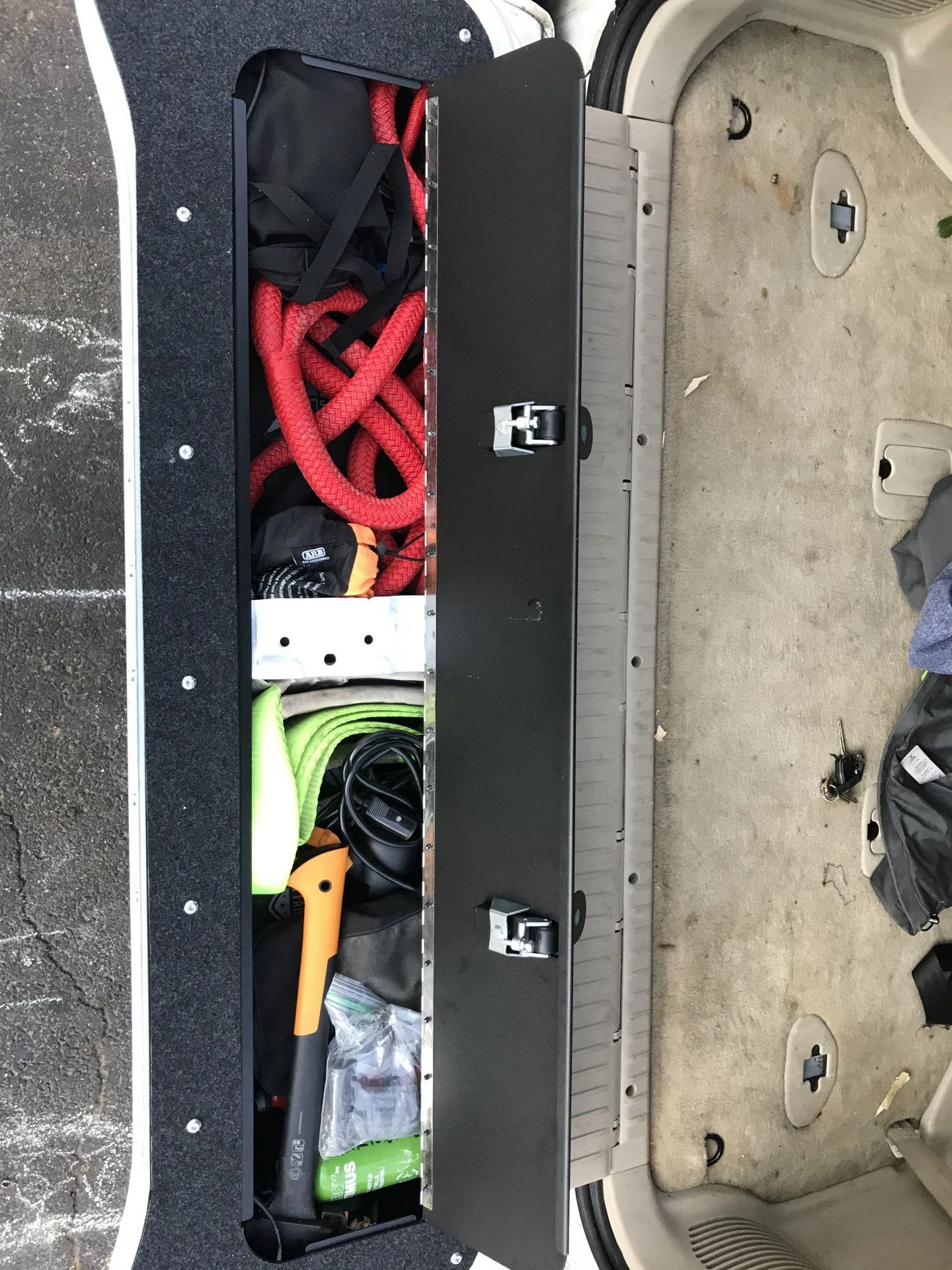

Just installed mine--I think they've addressed a number of issues folks raised earlier in this thread. The instructions actually show (mostly) pictures of a 100 series tailgate, the latches seem pretty awesome and were easy to adjust, and they include little plastic furniture slider thingmos to keep the rear flap from fouling the latches when you raise the tailgate.
The extra storage space is awesome--I fit an entire backpack full of recovery gear in mine--25' Treaty Oak kinetic recovery rope, tree strap, soft and hard shackles, snatch block, winch controller, spare coolant and engine oil (in 1l camping stove fuel bottles), hatchet, tire plug kit, and probably other stuff I've forgotten.
No rattles at all.
Most of this stuff is bulky but not heavy, and I tried to keep the weight low, but the tailgate now drops pretty startlingly when I undo the latch in the casual way I'm used to--will take me a while to remember to get ready to resist some weight when I undo the latch. I've told the kids (currently 7, 6, and 4) they are NOT allowed to open the tailgate--that thing will give one of them a concussion if they reach up and undo it. I toyed with keeping the spring but it really wouldn't work, since the spring arms would sit across the middle of both compartments and make everything a huge pain in the rear.
All in all, a pretty great product . . . I just freed up a good chunk of space and put the recovery gear where it won't be buried under 47 tons of camping gear when we need it.

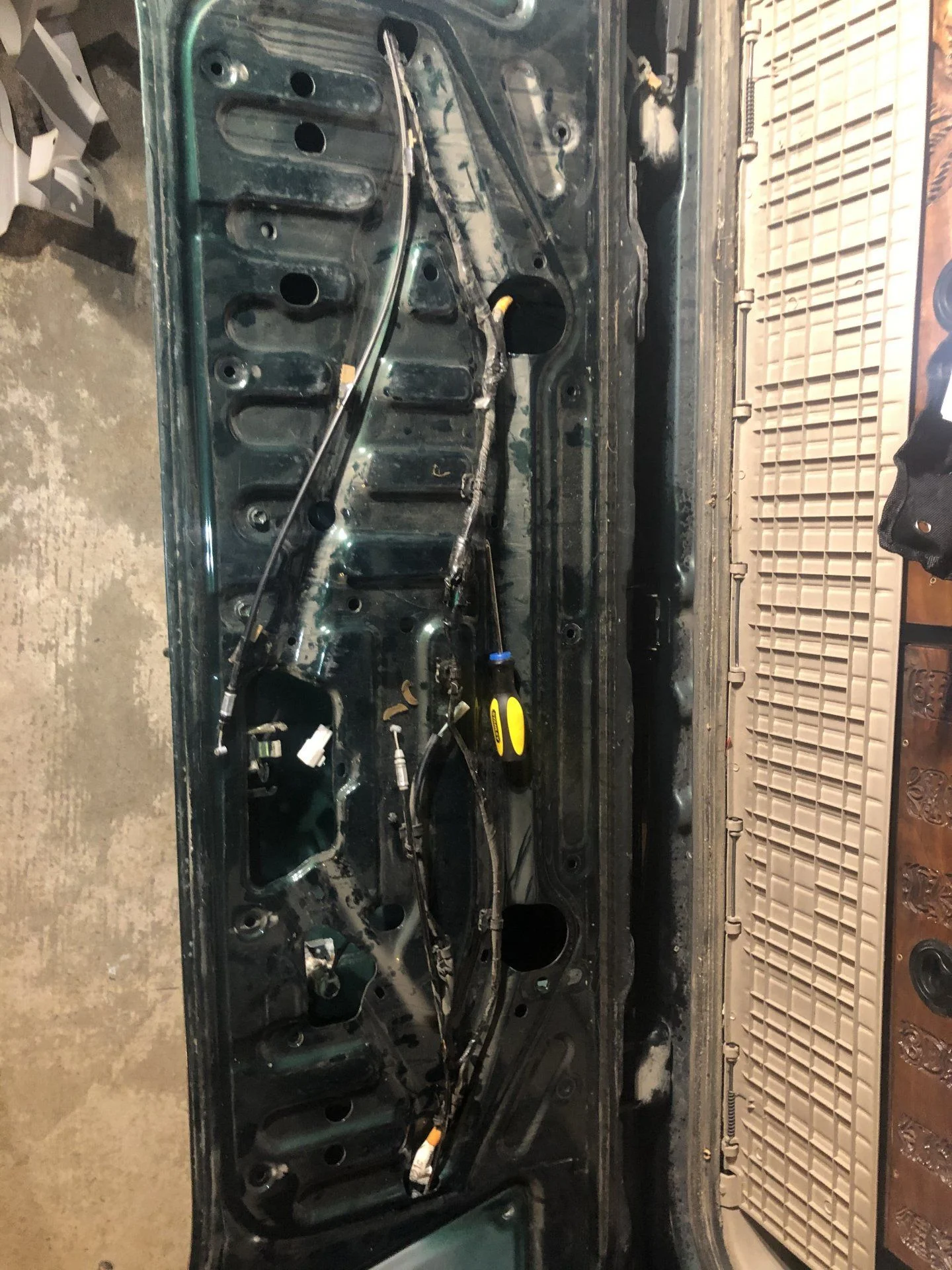

Alright I’m already confused, what I am supposed to do with group of wires laying across here? Is there a disconnect I’m not seeing?
Alright I’m already confused, what I am supposed to do with group of wires laying across here? Is there a disconnect I’m not seeing?View attachment 2553338
Pop out the little clips that hold them to the sheet metal, unplug them from the tail light assemblies on both sides (remove the three-screw access plates on both sides to gain access), tuck them out of the way, and make sure you don't cut through them with the angle grinder!
