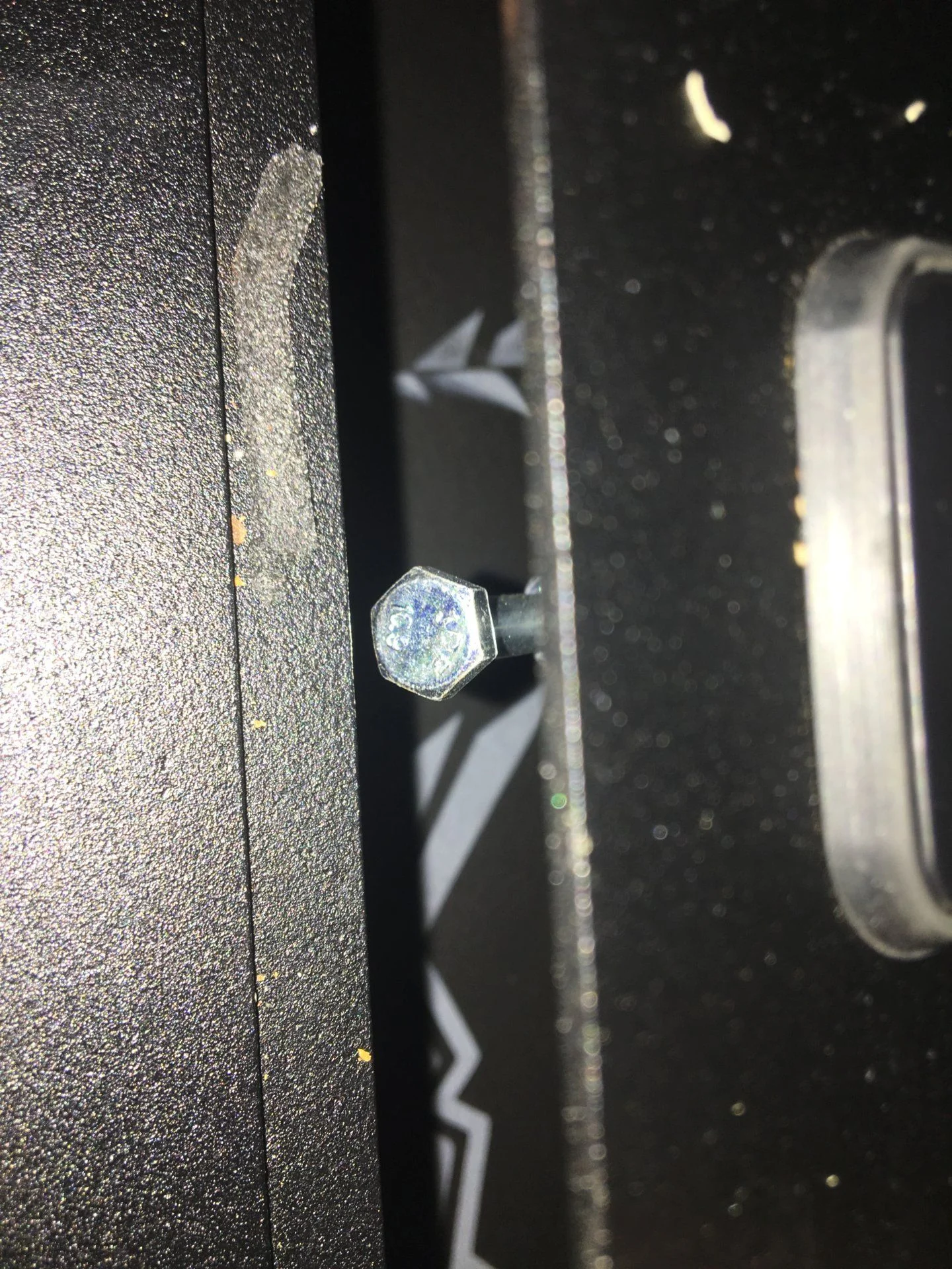

@gatormark91
You can see how I have the nuts...one on each side. I just had to trial and error with adjustments until it caught when closed. Then I tightened them with pliers.
The other pic shows how close the latch is to the lip when closing it.
Also, that is not rust in the pics...it is dirt...lol.
