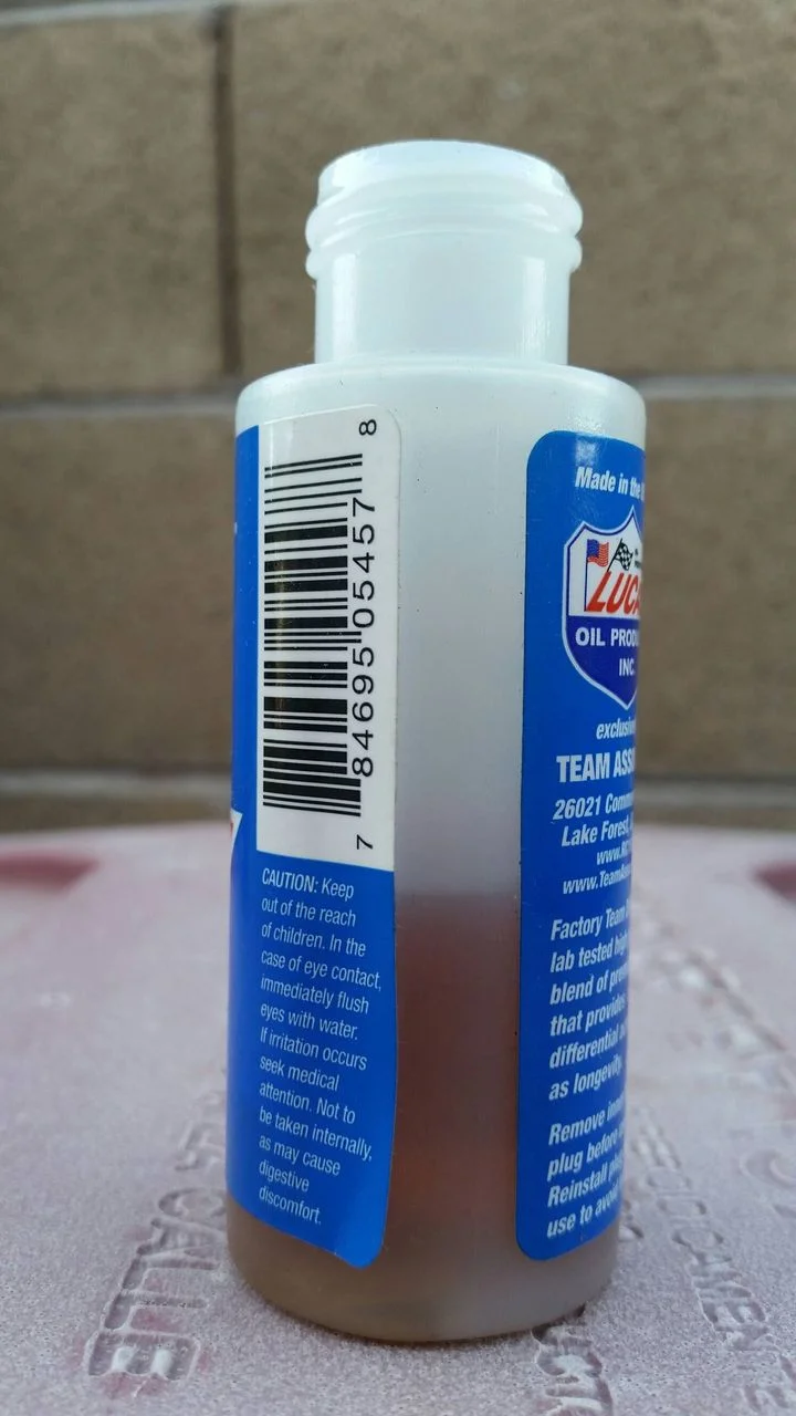

I have a blue clutch and changed the oil to 30K CST recently. I didn't have any overheating problem. It has been running at 194F all the time, 192F before I installed new radiator :rolleyes:. I changed the oil because the clutch is out for other work. I am glad I changed the oil because there was not enough oil in it. I collected about one oz of old fluid from the clutch.
Old fluid from the blue clutch with 202k miles.
