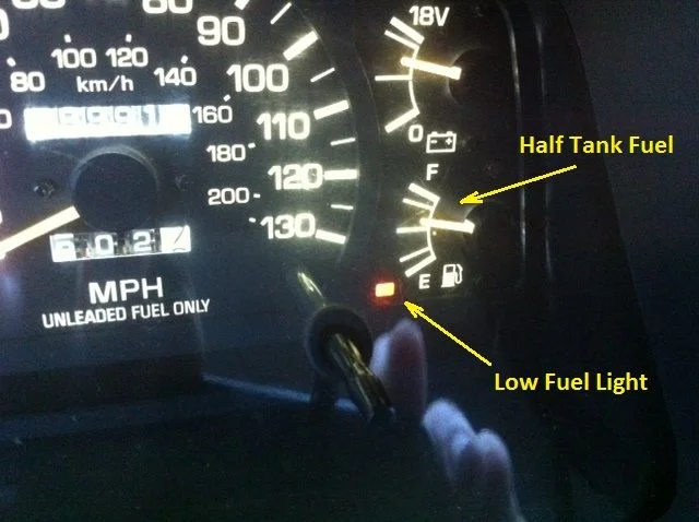

Just got back from a weeks vacation. Got in my Cruiser this morning and fired it up.
I noticed the Low Fuel Light on the dash was clearly illuminated, but my fuel gauge was (correctly) reading a bit over 1/2 tank of fuel.
I've NEVER seen that light in the 18 yrs. I have owned it. I don't let my tank go below 1/4 tank.
So...I drove to town and filled up. The tank took right at 12 gallons, so the fuel gauge is correct.
During my trip home the Low Fuel Light got progressively dimmer but I can tell it is still on.
Question: What might be the cause of this? (shorted wiring)?

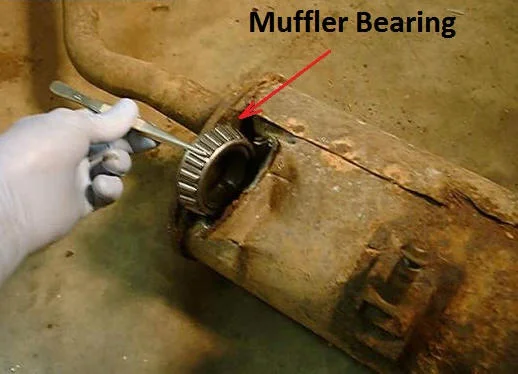

So all that coolant in my fuel is going out the exhaust system and will probably take out my new muffler bearing too?
Sheeesh...what next. I have a vehicle inspection coming up and already have a blinker that won't work. I'm pretty sure its just low on fluid though.
^^^^^ I'm sure its all this and more.
There is no way you can repair that wearing those gloves, you need blue latex not white.......common knowledge.

So far...my sending unit and gauge seem to be accurate. When I pulled up to the pump my gauge showed right at 1/2 tank (just a tad over). The tank only took 12.5 gallons. The gauge then showed full (as it should).
So all that is left to do...is to drive it, let it get down to 1/4 tank (per the gauge)....then fill it up and see if that amount corresponds to the tank capacity. IF it does...then I don't have a gauge or sending unit issue. It will be something to do with the with low fuel circuit or gauge cluster.
Currently the light appears to be on but is very, very dim. You have to really look to see it. Tank is full.
looks like you converted your cluster to LED lights... Did you put an LED in the fuel light?
If so and without the correct resistors it will remain lit... all... of... the... time.... Ask me how I know.
I did recently install LED cluster lights, but only the four main bulbs and the 'D' (trans position) bulb.
I did not replace any other bulbs and as far as I can tell...it isn't 'spill over' light from the LED's. It was clearly illuminated yesterday...but not now.

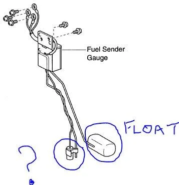

I have the same problem and was planning to replace the sender assembly pictured below ($125).
I made the assumption, perhaps incorrectly, that the float was responsible for the indicated fuel level and the other circled gizmo was a sensor for the low fuel light. Can anyone confirm or deny this is the case?

That would sure make sense (separate units). I've never had mine out...so I can't confirm. I'm still running the original fuel pump and sending unit (300K miles, 21 years old).

I seem to recall someone a few years back having the same problem. The cause being the in tank wiring where the insulation was worn on the wire to the low level sensor, shorting out against the brackets that support the fuel pump. This is an excellent time to pull the assembly from the tank, check things out and replace the filter sock on the pump pickup.
The low fuel light is on the bracket with the fuel pump and gauge, they share a ground, other than that totally separate circuit. When the fuel is low, the sensor sends ground to the light turning it on. My guess would be an intermittent short to ground somewhere in the circuit, would start by unplugging at the tank and see if the light changes, goes out.
